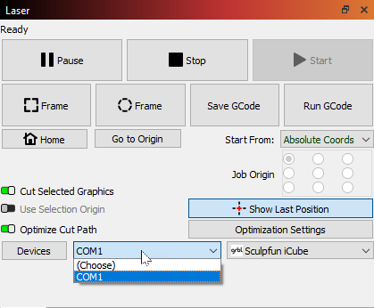

Depending on the type of device you have and the connection method you're using, you may have a dropdown in the Laser window to choose the serial port. The screenshot below highlights its location between Devices and the name of the active device.
LightBurn will attempt to automatically select the correct serial port, but you may need to manually select it from this dropdown. When connected, the Disconnected message in the top left corner of the Laser window will change to Ready. If you are using a GCode-based laser, you will see a startup message in the Consolewindow.
You may need to right-click the Devices button in the Laser window to refresh the list of available ports.
