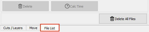

Accessing the File List Window
If you have a DSP device profile selected, the File List Window is located in the upper right side of LightBurn, docked behind the Cuts / Layers Window, by default.
If you have closed the File List Window, go to Window → File List to re-enable it. To restore it and all other windows to their default positions, go to Window → Reset to Default Layout.
File List tabbed
