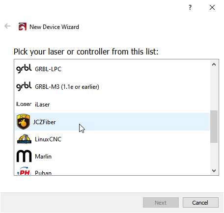

Follow the directions in Find My Laser to begin the process of adding your Galvo laser. Your laser should be detected as JCZFiber (for EZCAD2 devices), BSLFiber (for SeaCAD devices), or EZCad3. Select the appropriate device and connection type – USB is currently the only supported type for Galvo devices – and continue with the process.

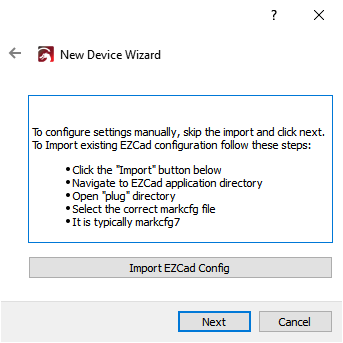

JCZFiber / EZCad2
  • The EZCad2 configuration file is typically markcfg7, but can occasionally be markcfg0.
  • You can usually find this on the supplied drive by going to the EZCad application directory/folder, opening the plug folder, and selecting the MarkCfg7 file.

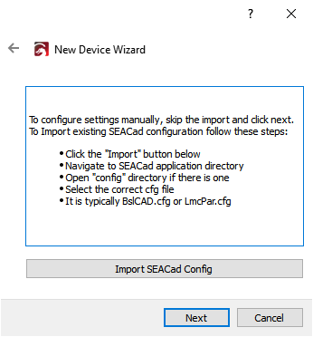

BSLFiber / SeaCAD
  • For BSLFiber devices based on SeaCAD, the configuration file is usually BslCAD.cfg or LmcPar.cfg.
  • You can usually find this on the supplied drive by going to the SEACad application directory/folder, openining the config folder if it's present, and selecting the appropriate configuration file.

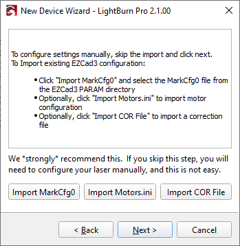

EZCad3
  • For EZCAD3 devices, the configuration files are typically called markcfg0, Motors.ini, and COR.
  • You can usually find MarkCfg0 by going to the EZCad3 application directory/folder, opening the PARAM folder, and selecting the MarkCfg0 file.
  • If Motors.ini exists, it's generally in the same location as MarkCfg0.
  • If your laser came with a COR file, it's usually in a separate folder called COR File.

Import EZCAD configuration file
Importing an EZCAD config file
Import SeaCAD configuration file
Importing a SeaCAD config file
Import EZCad3 configuration files
Importing EZCAD3 config files

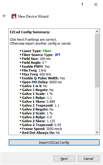

Select your configuration file – typically found on the USB drive you received from the manufacturer – and click Next. LightBurn will show you a preview of the settings to be imported.

If your markcfg7 file includes information about Lens Correction, LightBurn will attempt to automatically import this for you. If your configuration file doesn't include this info, you'll need to manually enter it in Device Settings after finishing the New Device Wizard.
After entering the size of the work area and setting the name of the laser, you're ready to connect to your laser.

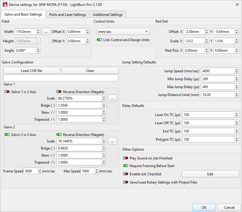

Manually Add a Galvo
If your laser did not come with the settings on a USB drive or if you don't have the USB drive available, you may need to contact the manufacturer for settings. Galvo settings can't be found through trial and error, due to the complexity and variety of machine configuration. Settings that work on one laser may destroy another.
If your settings were provided on a card, in an email, or in any other way that doesn't work with the automatic importer, click Next when asked to import the EZCAD config to skip this step, and enter your settings manually after adding the laser.

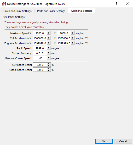

Go to EditDevice Settings to open the Device Settings window. From here, you can manually enter the settings provided by the manufacturer in the Galvo and Basic Settings tab and the Ports and Laser Settings tab.
The Galvo and Basic Settings tab
The Ports and Laser Settings tab
Please note that when entering these settings manually, the Additional Settings tab needs to be updated with the correct information for the simulation in Preview to function correctly.
