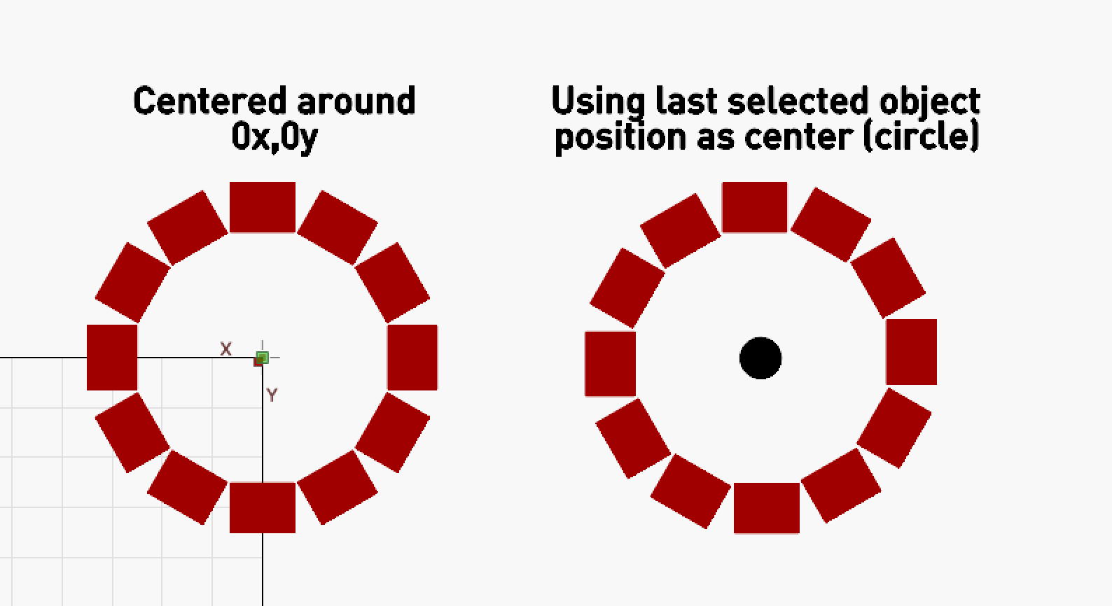

Center of Rotation
There are two ways to set the center of rotation for your array:
  • Enter the x and y coordinates of a spot in your Workspace into the Center fields.
  • Turn on Use last selected object position as center to array the copies around the center of the last object you added to your selection.

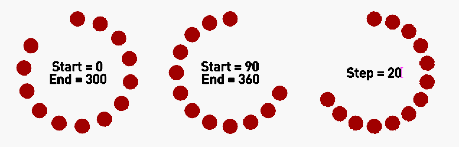

Start and End
An array doesn't have to span the whole 360-degree rotation, you can limit the duplications to only part of the circle using the Start and End fields.
step, start and end
Step
You can specify the angle between the copies in the Step field. This value is mathematically tied to the End and Copies fields.

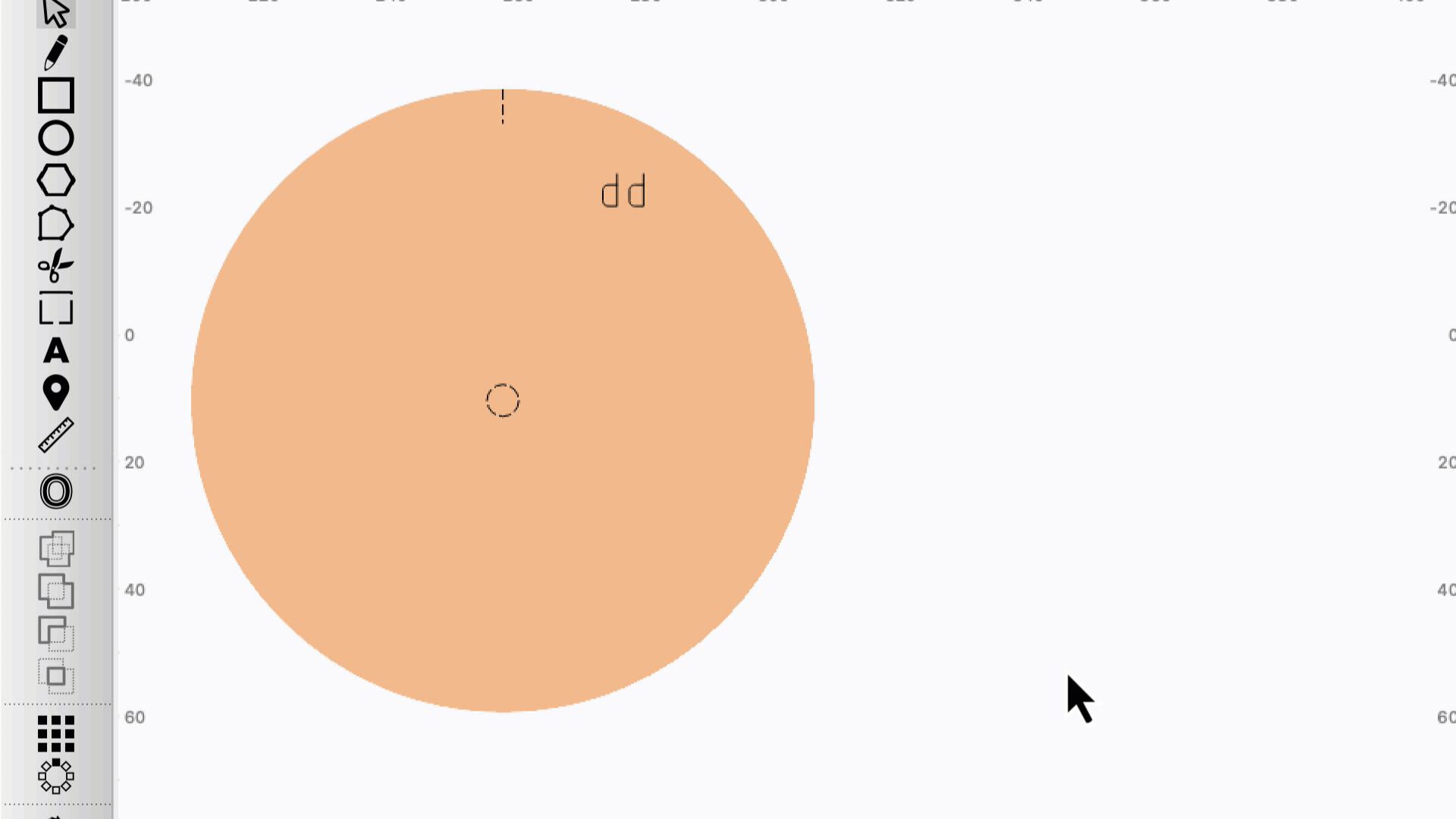

Rotate Object Copies
Enable Rotate object copies to turn copies so that the same part of each duplicate faces the center, like the tickmarks on a stopwatch. Disable it to keep the copies in their original rotation, like the numerals of a clock that remain upright for readability.
demo creating clock
