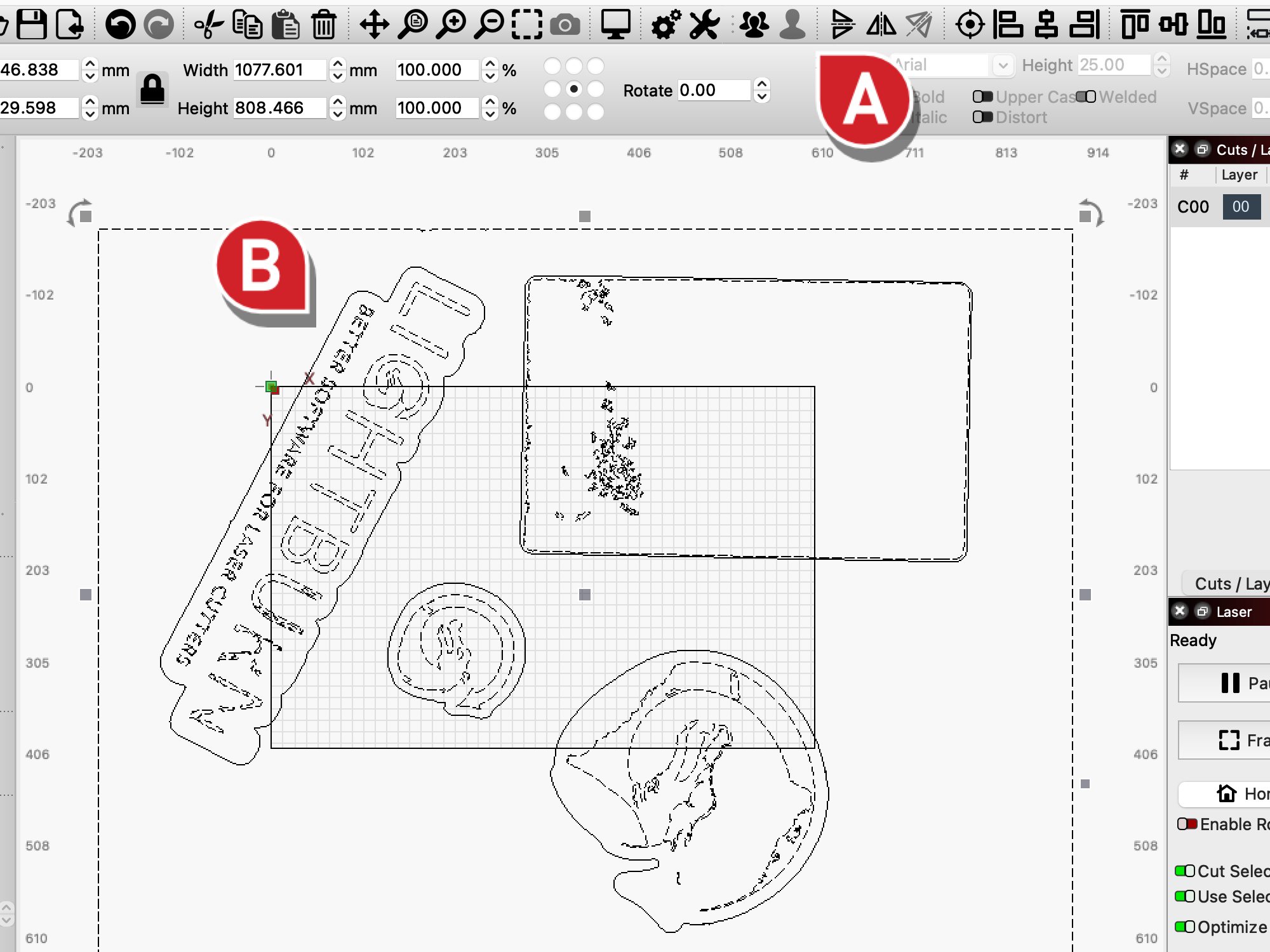

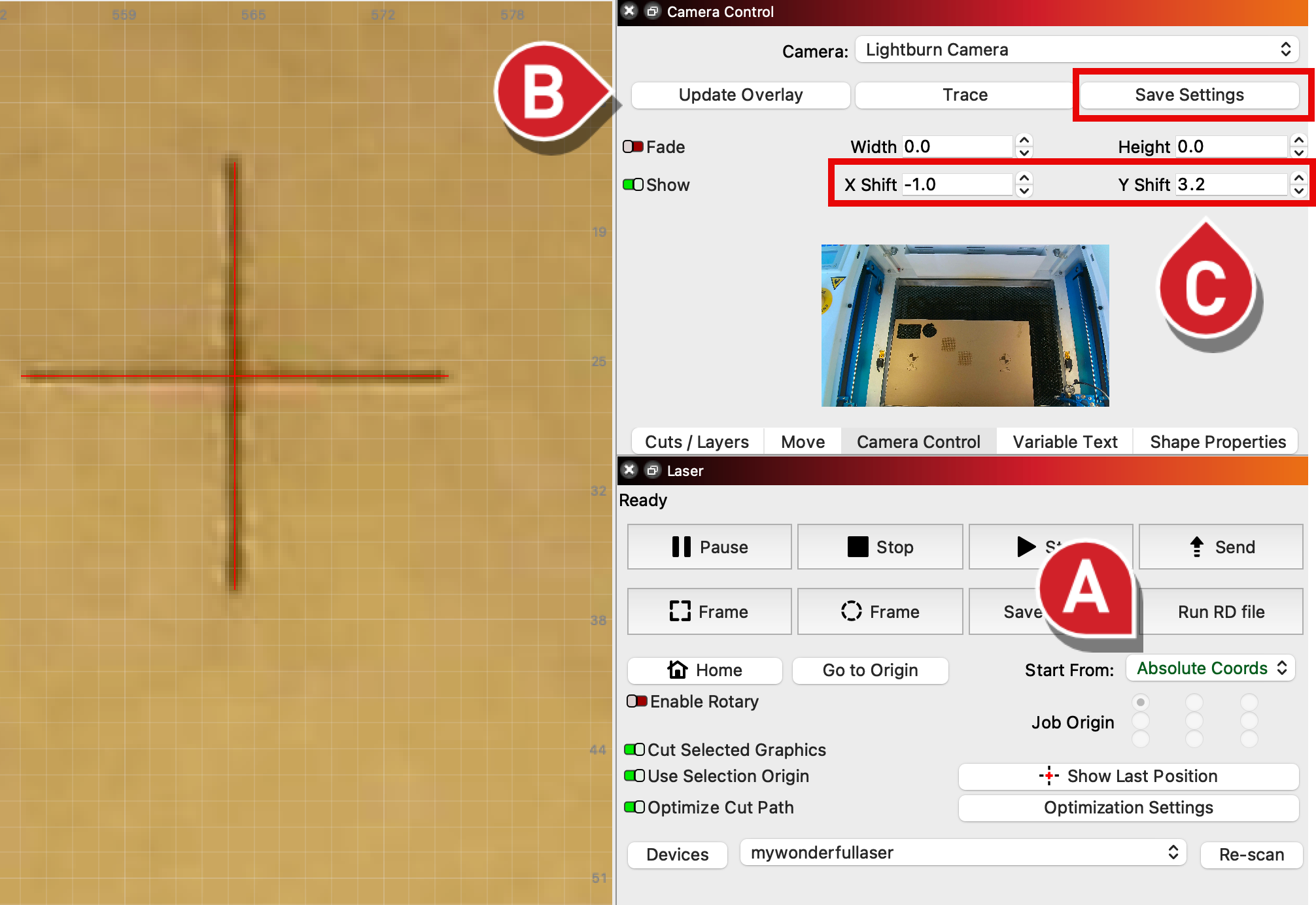

To test Camera Alignment, use the Draw Lines tool to create a crosshair mark set to a Line layer in your LightBurn workspace. Set the Start From mode to Absolute Coords, and mark the crosshair onto piece of material placed in your laser. Cardboard works great for this step — you want a strong contrast.
Then, click Update Overlay in the Camera window, and see how far off the marked crosshair is from the crosshair design in LightBurn. If they're perfect, you're all set!
If they're not perfect but relatively close, adjust X Shift and Y Shift until they overlap perfectly, click Save Settings, then re-test.
If they're very far apart, re-run Camera Calibration and Alignment, then re-test.

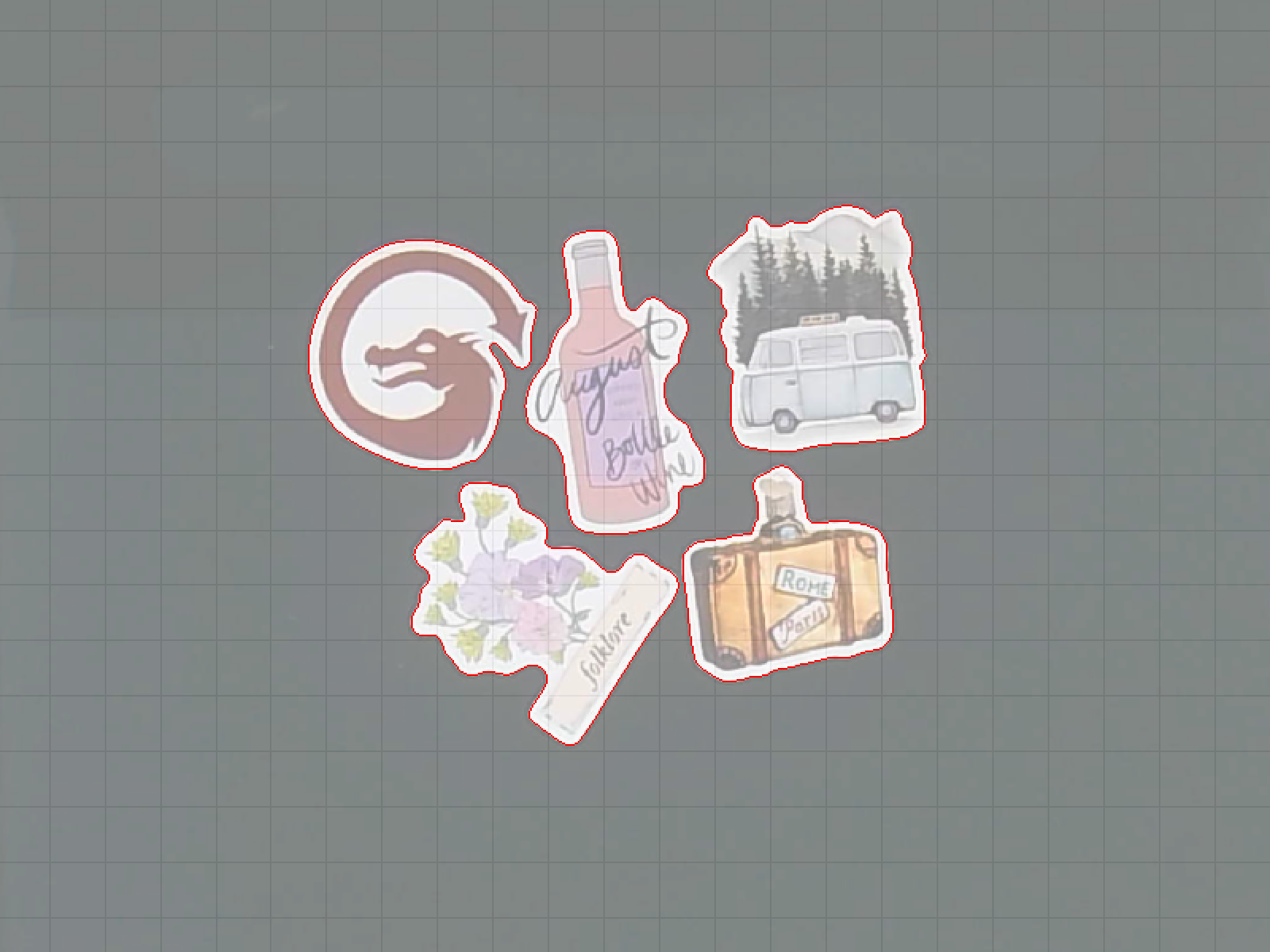

Next, we'll use Image Tracing to make outlines around the stickers.

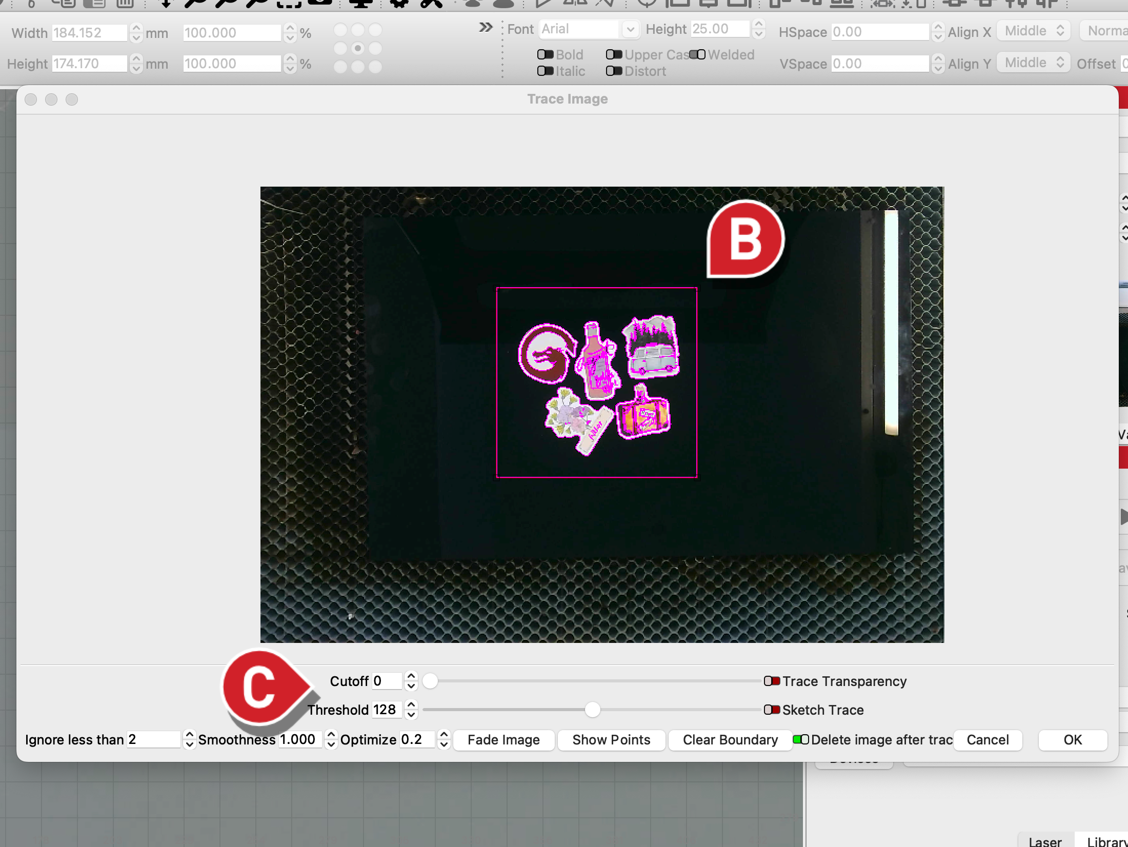

Click Trace in the Camera Control window
In the Trace window, box-select only the portion of the capture where your stickers are.
With the black background, you should have no trouble getting outlines of each of the stickers, but, if necessary, you can adjust the Cutoff and Threshold sliders until you get complete outlines for each sticker.
The Cutoff slider controls the lower end of the range of brightness values that LightBurn will outline with vectors, and the Threshold slider sets the upper end.

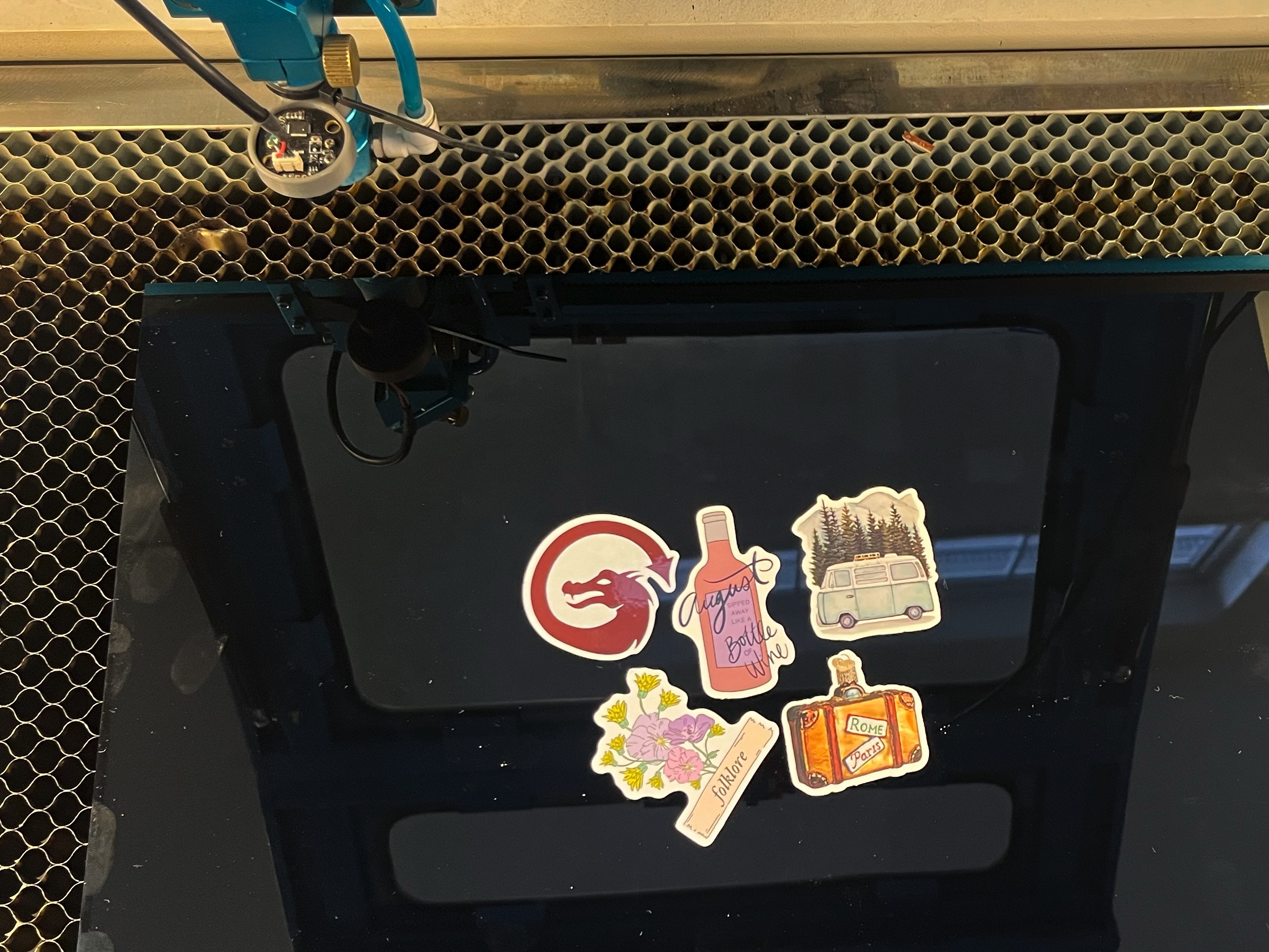

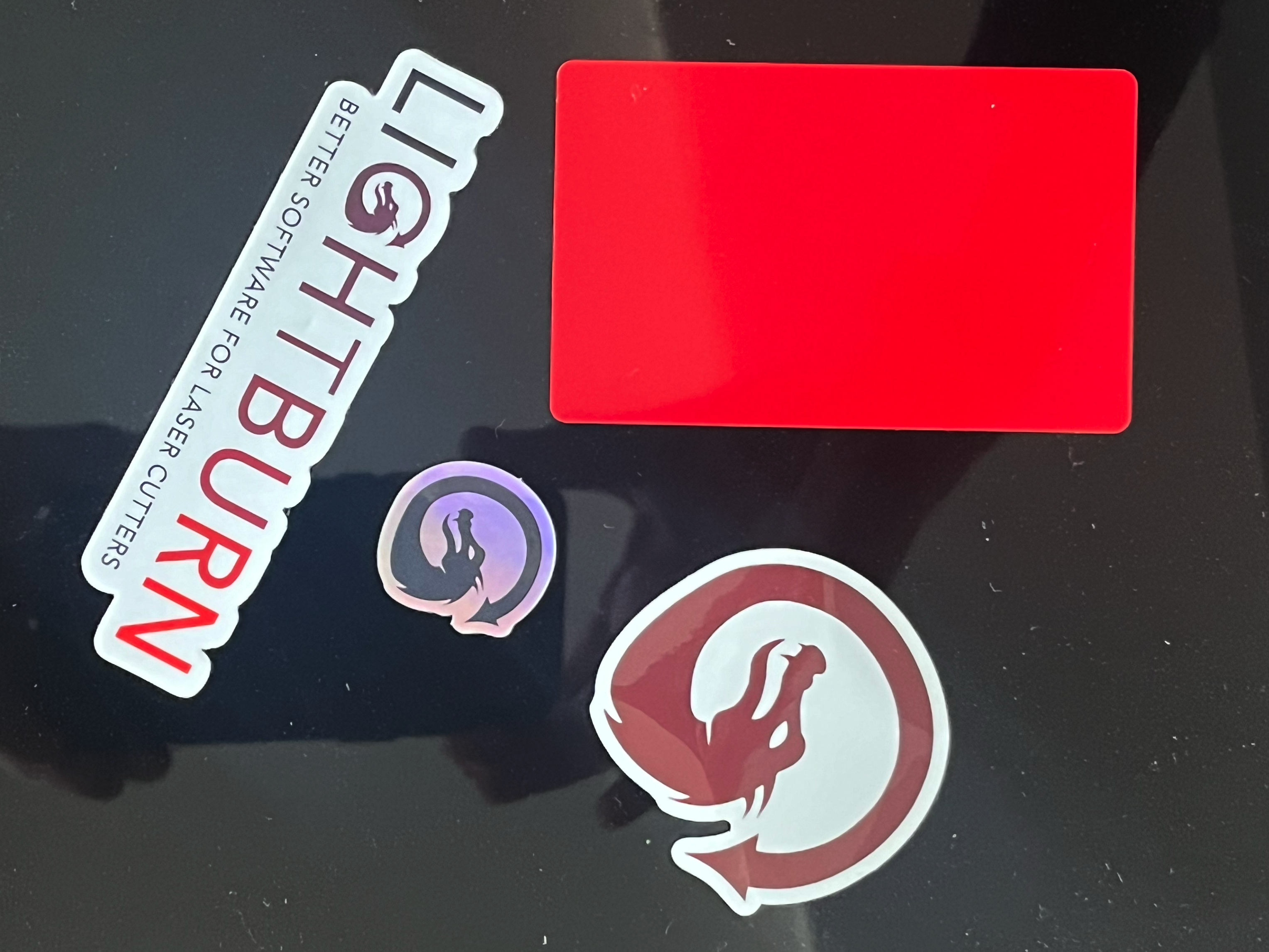

Using a digital camera or smartphone, we'll start by taking a photo of our stickers and a reference object, laid out on black acrylic.
Place your stickers and a flat rectangular or square reference object (we used an aluminum business card blank) on a sheet of black acrylic.
Take a photo of the stickers and the object. Try to keep the reference object roughly horizontal/vertical in the camera’s field off view. To avoid perspective distortions, keep the stickers centered and the camera angle as top down as possible.
Send the photo to your computer by SD card, Airdrop, email, or a cloud storage service.

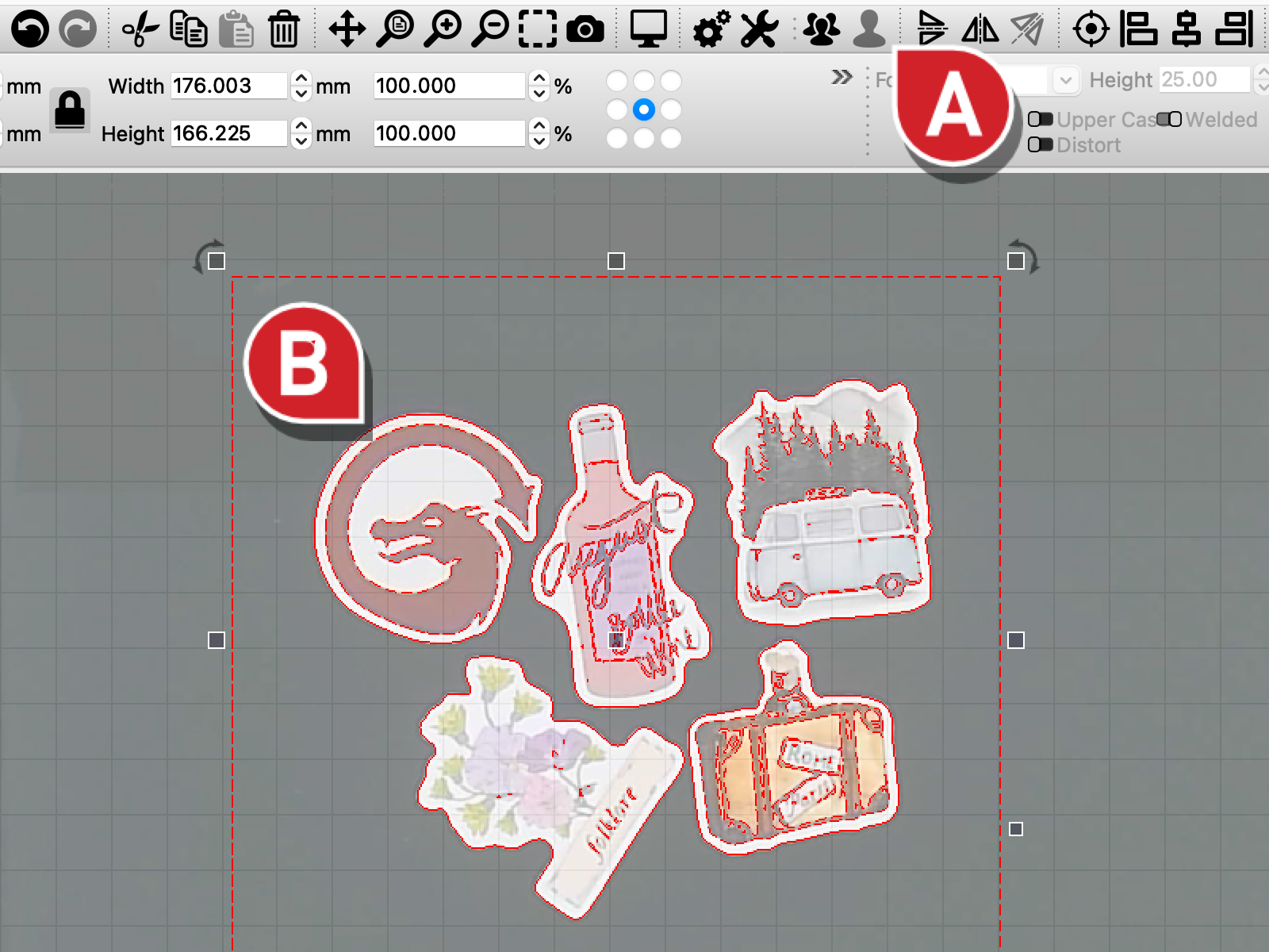

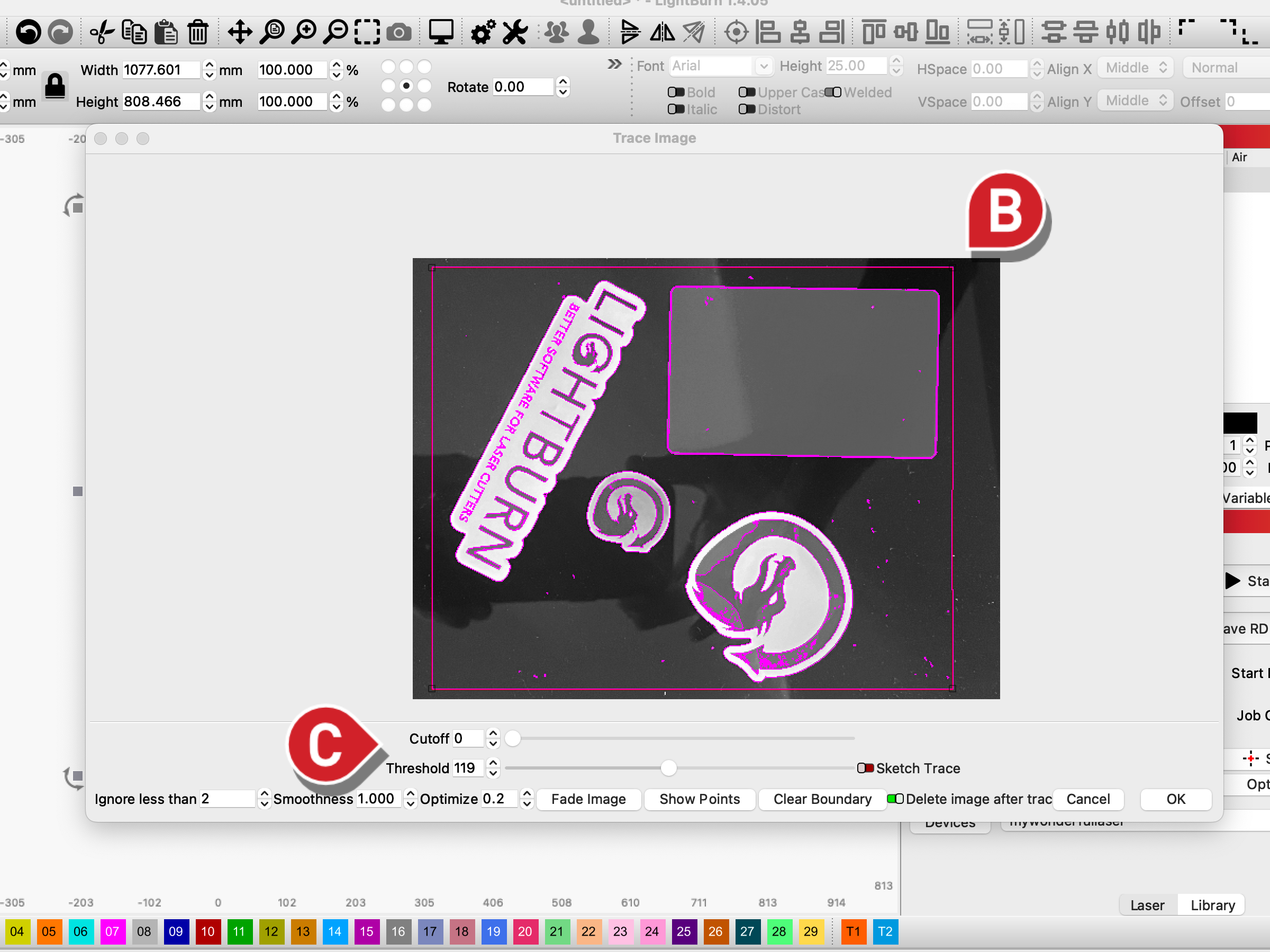

Next we'll Import the photo into LightBurn and Trace it.
Import ( Ctrl+I / Cmd+I ) the photo into LightBurn.
Right-click the image and select Trace Image. In the Trace window, box-select only the portion of the capture where your stickers and object are.
With the black background, you should have no trouble getting outlines of each of the stickers and object, but, if necessary, you can adjust the Cutoff and Threshold sliders.

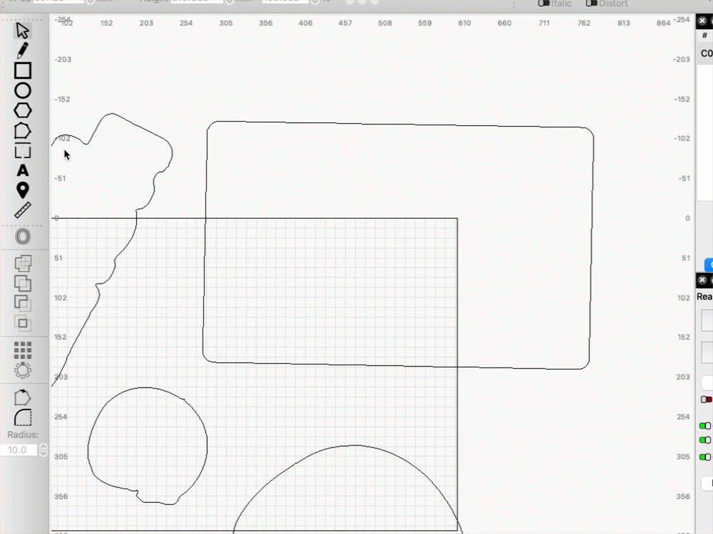

3. Edit Vectors¶
The resulting vectors will automatically be selected and grouped. In addition to the outlines, they'll likely include some additional graphics you don't want.
Ungroup ( Ctrl+U / Cmd+U ) the vectors, but keep all of them selected.
Then, Hold Ctrl or Cmd while clicking on each of the outlines of the stickers to Deselect them.
When all of the outlines are deselected, Delete the remaining selection.

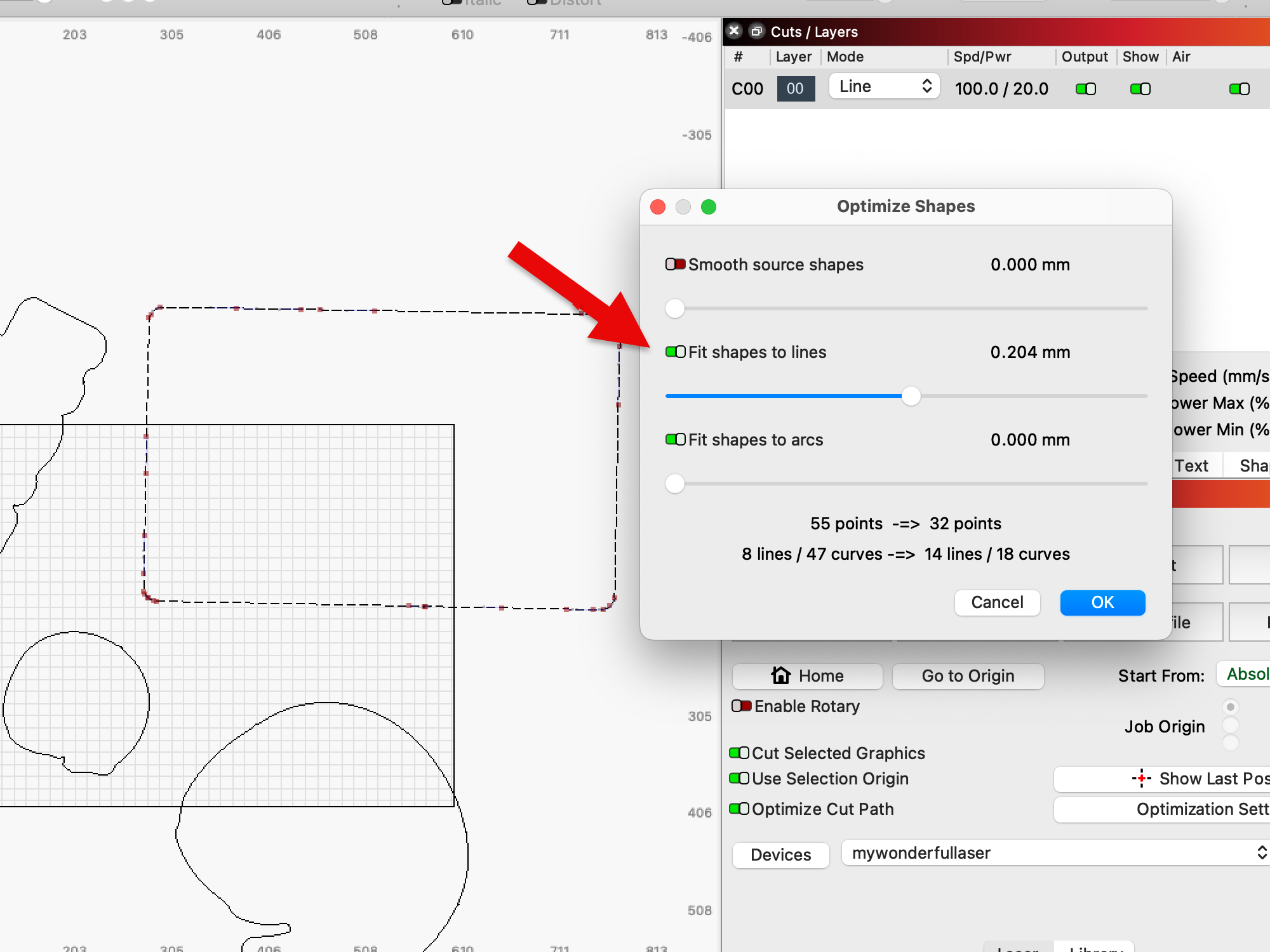

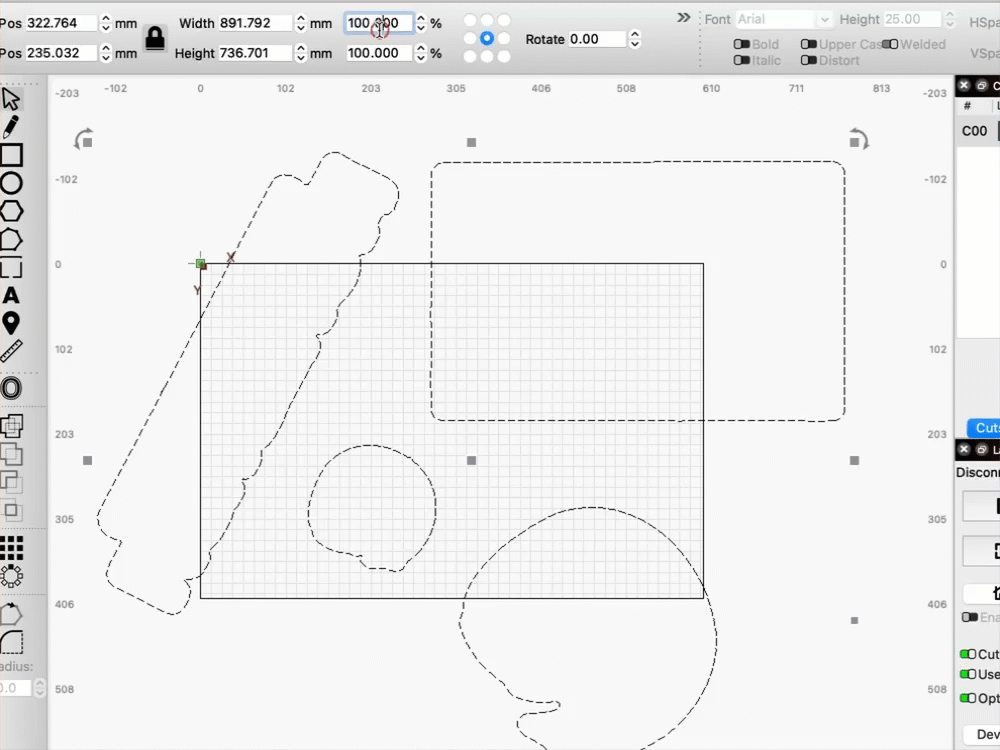

4. Rescale Outlines¶
Here comes the math part — don't worry, it's simple and will be over quickly.

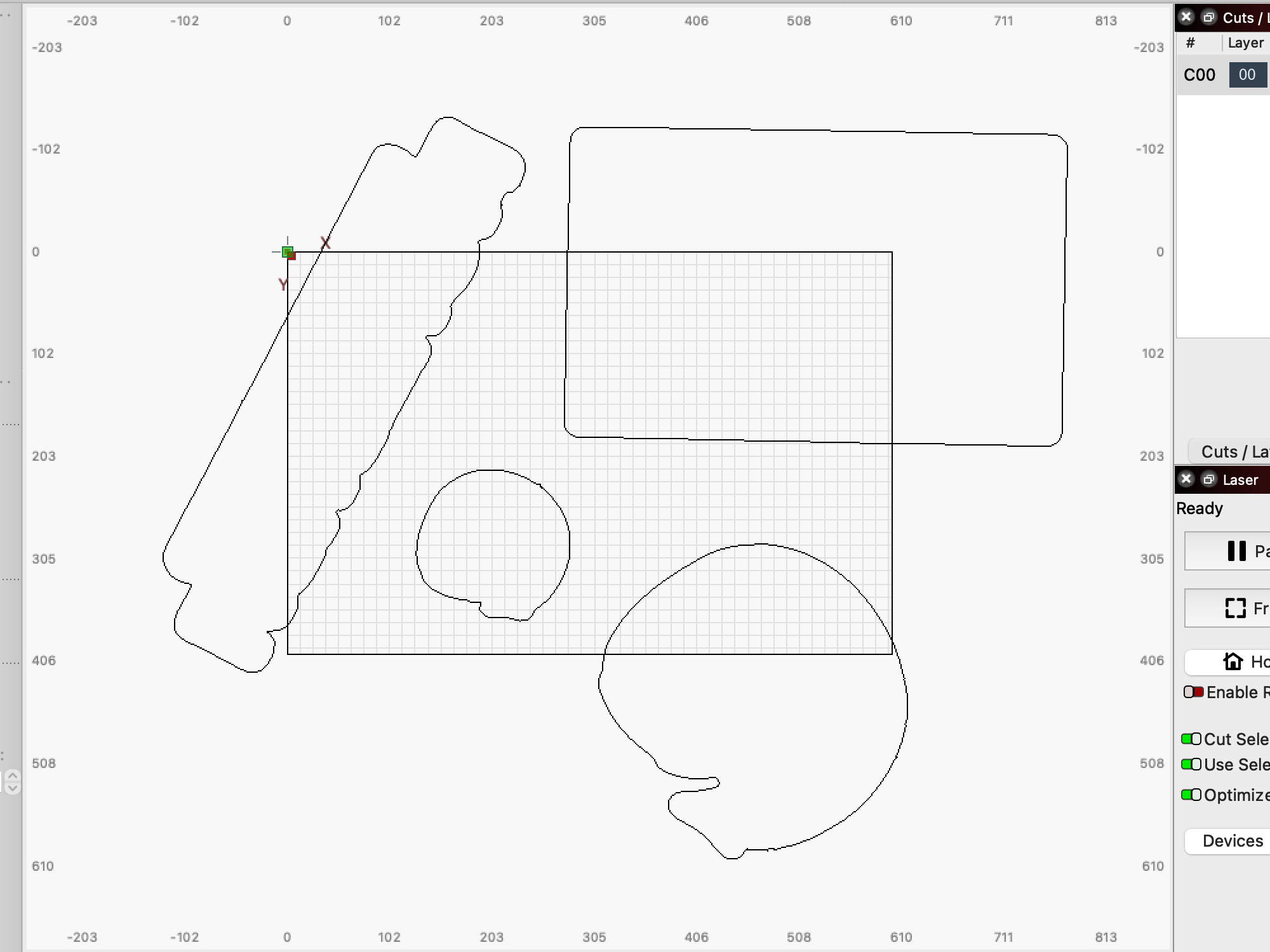

To get the outline of the reference object perfectly vertical or horizontal, first Select it and go to Edit → Optimize Selected Shapes and use the Fit shapes to lines slider to fit it to lines. About halfway along the slider will do.
Then, select the Edit Nodes tool, hover over one if its edges, and press A to align it to the nearest vertical or horizontal angle.
Select the outline of the reference object you traced, and read its Width or Height measurement in the Numeric Edits toolbar.
Divide the known Width or Height of the actual object by the Width or Height of the outline you read in the Numeric Edits toolbar. In our case, the known Width of our cards was 86 mm, and the Width in LightBurn was 494.115 mm, for a result of ~0.174. We'll use that value to rescale our graphics.
Select all the rest of the graphics and enter the value, expressed as a percentage, in the Numeric Edits toolbar. For our result of .174, that meant entering 17.4% in the Numeric Edits toolbar. All of the outlines will now be scaled to the actual size of your stickers.
Select and Delete the outline of the reference object.

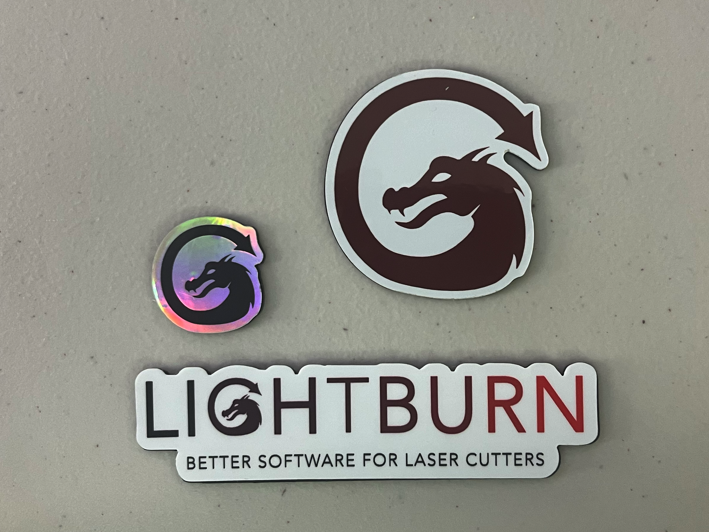

Stick on the Magnets¶
We're almost done, this part is easy!
Peel one side of the adhesive and apply it to a magnet.
Then peel the other side of the adhesive and attach the magnet to an acrylic backing. Repeat for all magnets and backings.
If your stickers are relatively large, you may want to strategically place a few magnets around the edges.
Put your new fridge magnets on your fridge!
