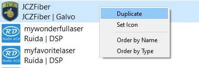

Duplicate Original Laser
In many cases, changing the galvo lens means that you'll need to adjust many settings and recalibrate it, effectively making it a "new" machine when you do so. To duplicate a device in LightBurn, click Devices in the Laser Window, right-click on a given laser, and select Duplicate.
Tip
Be sure to give the duplicate a descriptive and accurate name to contrast it to the original, and ensure that it's the on you edit later.
