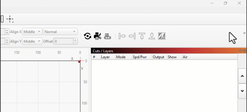

You can find Quick Nest in the Docking Toolbar or by going to Arrange → Dock → Nest Selected.
Accessing the docking toolbar

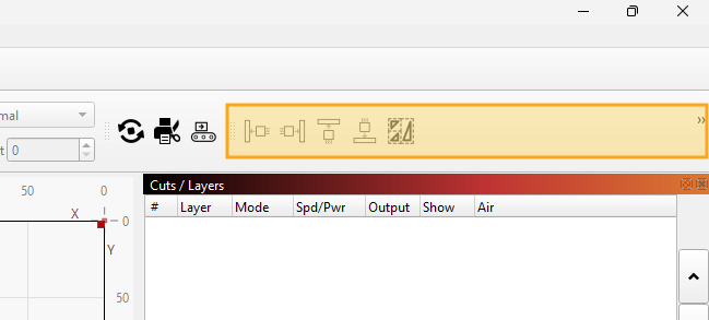

By default the Docking Toolbar is in the top right corner of the screen. Depending on your screen size, you may see a short version like the screenshow below, with an arrow to the right to expand the toolbar.
Screenshot of the docking toolbar in context
To see all the options, you can expand the toolbar with the arrows to the right, drag it to the left to give it more space, or drag it out of the toolbar area entirely. All three are shown below.
Expanding the docking toolbar
More about the Docking Toolbar

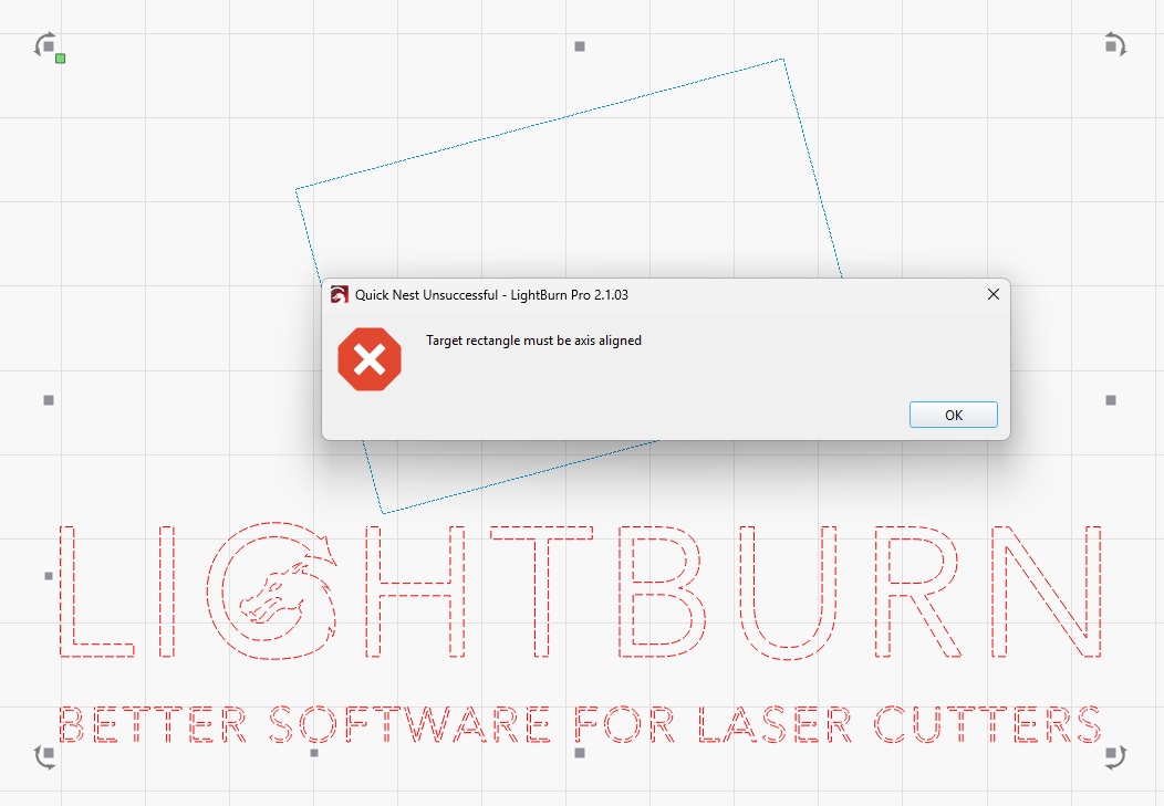

Target Rectangle Must be Axis Aligned
To use Quick Nest, the rectangle you're nesting into must have sides that are straight up and down and sideways.
If you get this error, make sure your bounding box is a rectangle and that it's not at an angle.

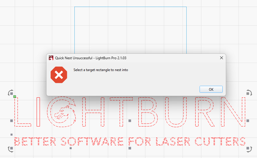

Select a Target Rectangle to Nest Into
If you get this error message, LightBurn doesn't see a selected rectangle to use as a container.
Fix the error by selecting a rectangle to arrange your parts inside of in addition to the parts to be nested. In the example below, the blue rectangle wasn't selected, so LightBurn has nothing to nest the parts into.
Screenshot of error message
Why is the I in LightBurn not selected?
In the screenshot above, the letter I in LightBurn isn't selected, because selecting it and not the larger blue box results in a different error. The reason for this is a bit technical, but if you're interested, keep reading.
The letters used in the demo file here are actually paths, not text objects, and the letter I would be a valid rectangle to nest into if it were big enough. This isn't a problem when the larger blue rectangle is selected, but when I don't select that rectangle, Quick Nest tries to nest into the I. This actually could have resulted in one of two different error messages:
  1. Optimization Yielded Zero Bounding Box: If none of the shapes selected are small enough to nest inside the I, Quick Nest will be unable to create a suitable arrangement and you will receive this error.
  2. Some Objects Remain Un-Nested: If there are shapes small enough to be nested into the I, Quick Nest will nest the objects it can, and you will receive this error.

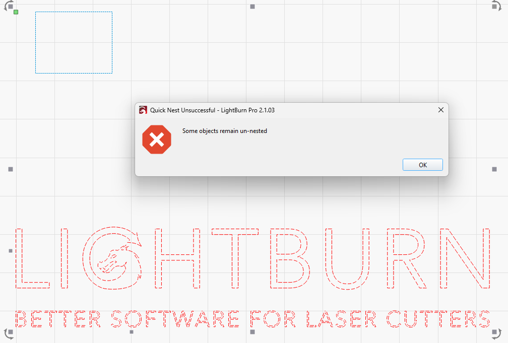

If you get this error message, one or more of the parts you're trying to nest are to big to nest in your selected rectangle with the current settings.
When you press OK, LightBurn will still nest as many of the parts as possible, leaving out the ones that can't be nested. If your target rectangle is big enough to nest your largest part, you will not see this error message.

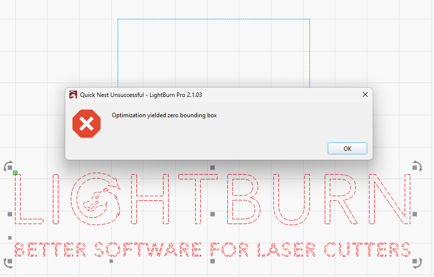

If you get this error message, it means Quick Nest is unable to create a suitable arrangement at all.
In certain circumstances, if you don't select a rectangle to nest into you can get this error message instead of Select a Target Rectangle to Nest Into. In the screenshot below, the blue rectangle isn't selected, but the red I, which is actually a rectangle, is selected. Quick Nest tries to nest into the I and fails, resulting in the Zero Bounding Box error. More about how this happens.
