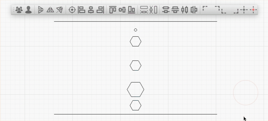

Distribute Vertically
Distribute V-Spaced Distribute V-Spaced icon creates even spacing between the edges of all selected objects in the vertical dimension.
Distribute V-Centered Distribute V-Centered icon creates even spacing between the centers of all selected objects in the vertical dimension.
Distribute Vertically Example

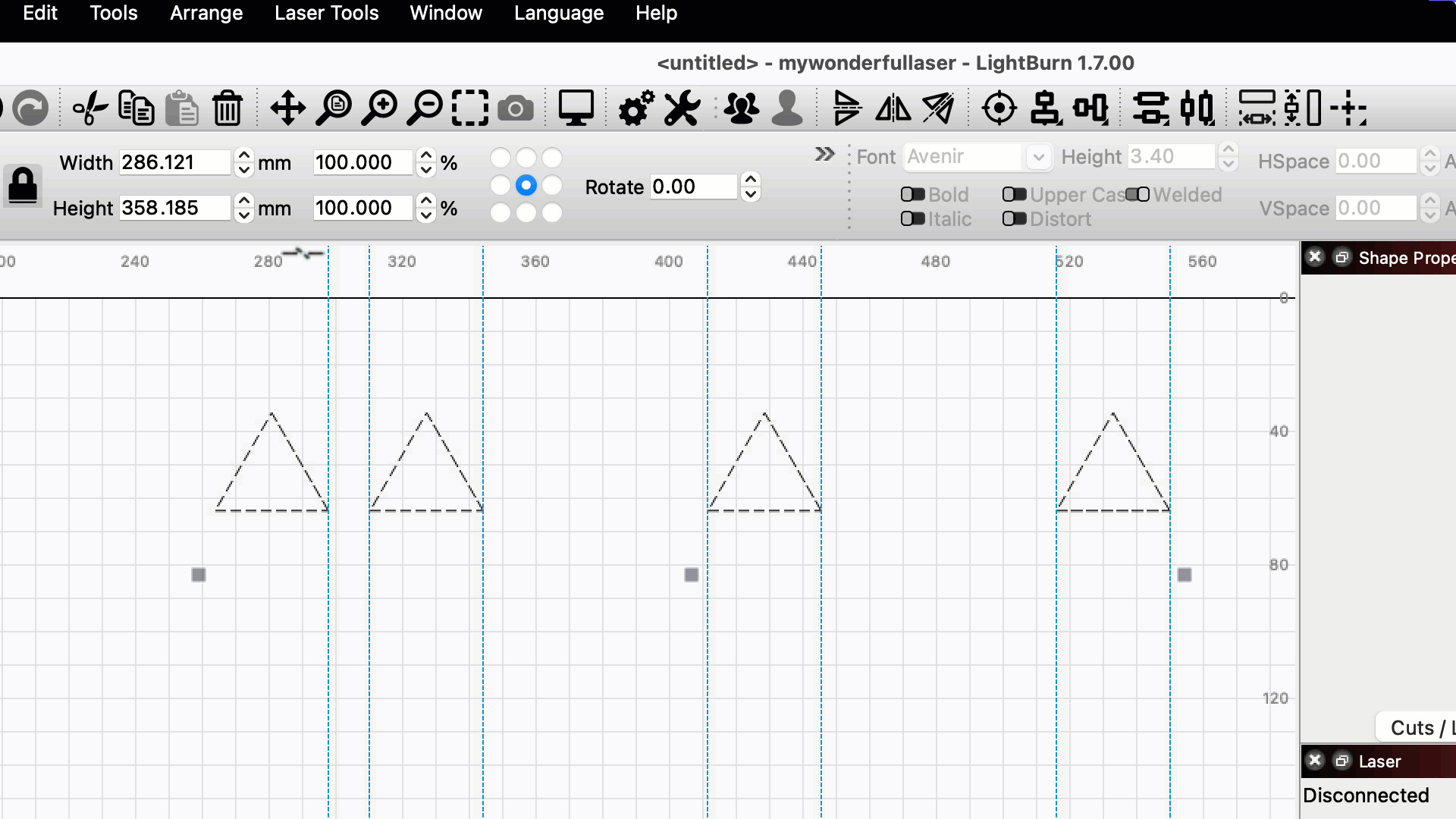

Distribute Horizontally
Distribute H-Spaced Distribute H-Spaced icon creates even spacing between the edges of all selected objects in the horizontal dimension.
Distribute H-Centered Distribute H-Centered icon creates even spacing between the centers of all selected objects in the horizontal dimension.
Distribute Horizontally Example

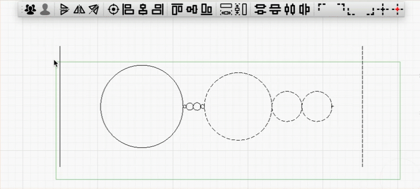

Notes on Spacing
The Distribute tools take an average of the current spacing between the edges or centers of your selected objects and move them to equalize that distance.
It is not always the case that the resulting average distributes objects such that there is positive spacing between all edges of all objects — only that the distance is even. If the amount of existing negative spacing (overlap) between objects in your selection exceeds positive spacing, the resulting distribution will also have overlap.
If large and small objects are distributed together with even spacing between their centers, they may overlap afterward, even if they were not overlapping to begin with.
Demonstration of Negative Spacing with the Distribute tools

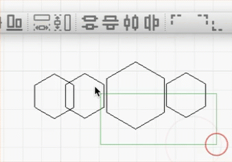

Move H Together
Alt/Option+Shift+H
Moves all selected objects so that they are evenly distributed, and their horizontal edges are abutting along vertical planes.
The last objected added to your selection is anchored in place, and all other objects will be moved relative to its location.
Move H Together
Move V Together
Alt/Option+Shift+V
Moves all selected objects so that they are evenly distributed, and their vertical edges are abutting along horizontal planes.
Move V Together
