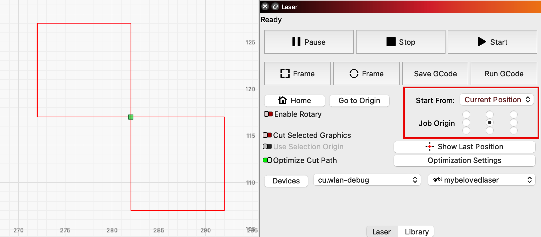

  2. Load an inexpensive, expendable material into your laser's bed. Place it in a location that both the red dot and laser's beam can reach. Position your laser over the material.
  3. Download this 2 square pattern, and Import it into LightBurn.
  4. Make sure the pattern is assigned to a layer set to Line Mode, and apply appropriate settings to mark it on the material you loaded into your laser, without cutting through.
  5. Select Current Position as the Start From mode, and center for the Job Origin position.
    Note
    If you are using a DSP device, go to Laser Tools → Machine Settings and make sure Return Position is set to No Return.
  6. Press Start in the Laser Window to run the job.

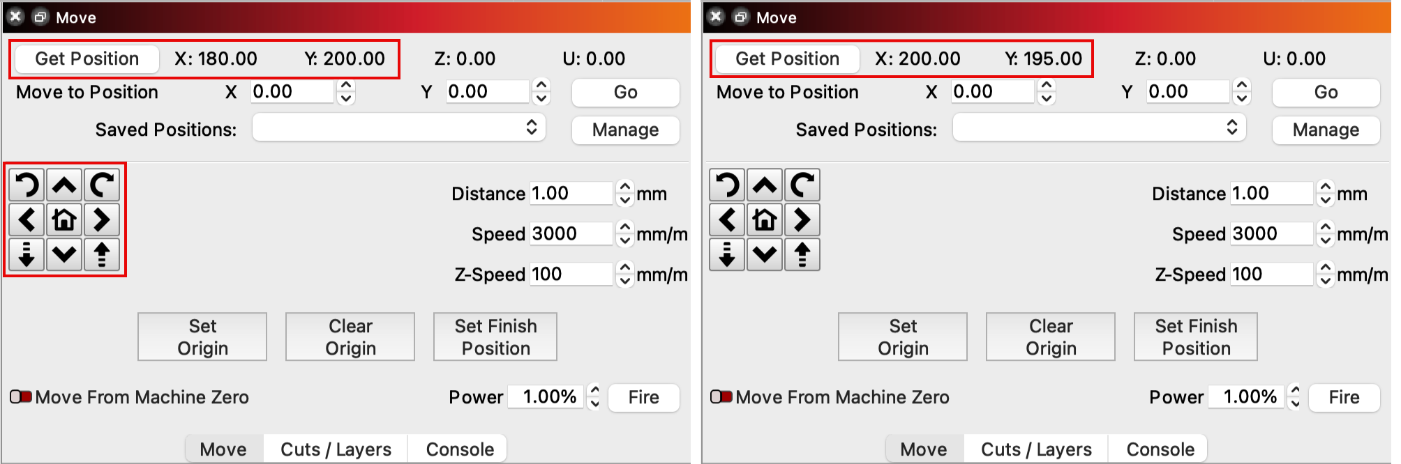

  7. In the Move Window, press Get Position, and record the X and Y positions reported.
  8. Jog your laser until your pointer's red dot is perfectly aligned to the center of the 2 square pattern — where the squares' bottom right and top left corners meet.
  9. Press Get Position once again, and record the X and Y positions reported.
  10. To calculate your X and Y offsets, subtract the X and Y positions you recorded in Step 9 from the ones you recorded in Step 7.
    For example, if you recorded X: 180 in Step 7 and X: 200 in Step 9:
        180 - 200 = -20
    And if you recorded Y: 200 in Step 7 and Y: 195 in Step 9:
        200 - 195 = 5
  11. In the Device Settings window, enter the results from Step 10 in the X and Y fields in the Laser Offset section and toggle on Enable pointer offset.
