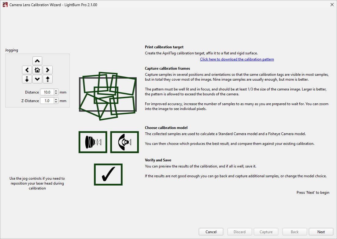

The Camera Calibration Wizard has on-screen directions to walk you through the process. Here's a quick overview if you want to just jump in and get started.
  1. Prepare the calibration pattern as described above.
  2. Open the Camera Lens Calibration Wizard and click Next to continue.

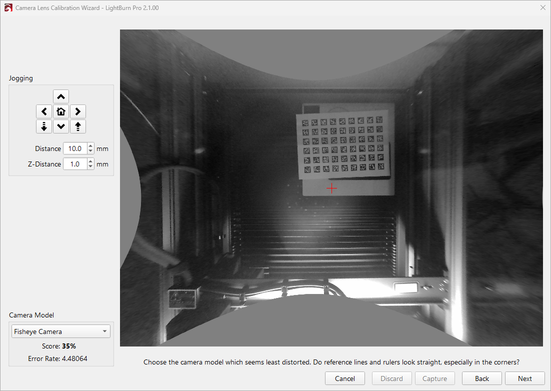

  3. Capture 5 images of the calibration pattern in the locations highlighted by the wizard - the four corners and the center of the workspace. You can use the jogging controls to move your laser out of the way. Click Next to continue.
  4. Select your Calibration Model. You can preview the results of each model by selecting it. You want straight lines to appear straight, and should pay attention to what the corners of the bed look like.

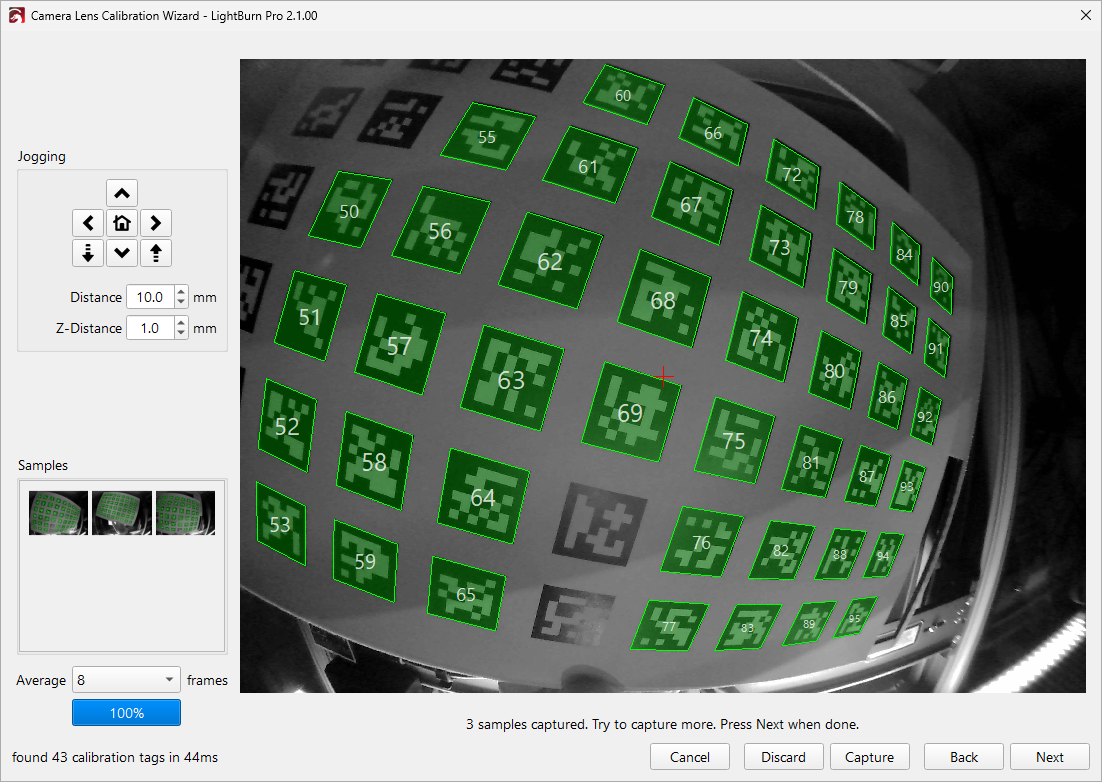

The next screen will walk you through capturing Calibration Frames, which are images showing the calibration pattern in each corner of your laser's bed as well as the center.
  1. Place your calibration pattern on the bed of the laser and adjust it to be in the highlighted box (the blue overlay shown in the top left in the screenshot above). Detected tags will be highlighted in green. You can use the Jogging Controls in the bottom right to move the laser head out of your way.
  2. Click the Capture button to capture a frame. If you're unhappy with the frame you captured, you can discard it with the Discard button.
  3. Move the calibration pattern to fit in the next box and repeat the process.
After you've captured the 5 required frames, you should see something like the screenshot below.
screenshot after capturing 5 calibration frames
At this point, the view of the calibration tags should be more accurate than at the beginning, but will likely not look entirely correct. You can keep going to take more calibration frames, or click Next to continue to the next step.

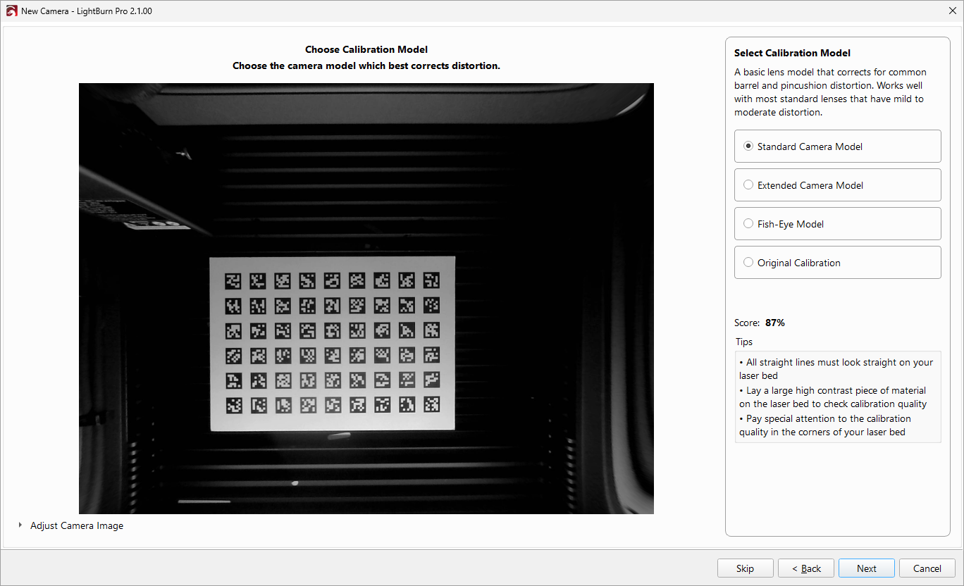

4. Choose Calibration Model
There are 4 different mathematical models LightBurn can apply for the corrections.
Screenshot of choosing the calibration model
Click the model options on the right to preview what the camera image looks like under each. A large, high contrast pattern (for instance, the calibration pattern) can be helpful for checking the accuracy of the calibration. Select the model that looks the most accurate and click the Next button to continue.
Each model includes a description with more information.

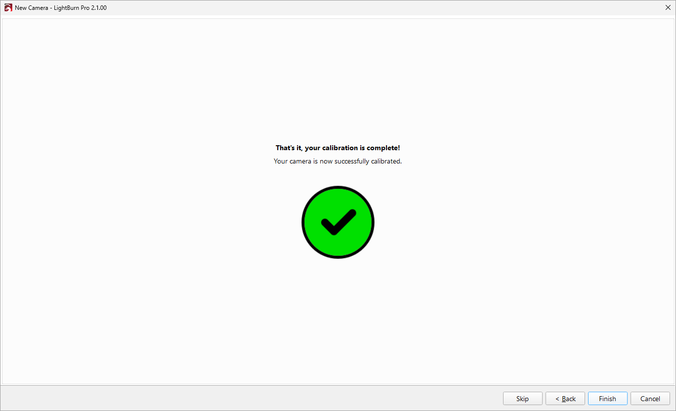

5. Success!
On the final screen, click Finish to close the process and save your changes. Next, you'll need to do Camera Alignment to align your camera to your workspace.
Screenshot of completed calibration

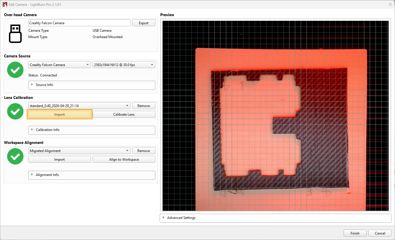

Import Existing Calibration
If you've already calibrated your camera and exported a LightBurn Camera File, you can import and reuse that calibration. Camera Lens Calibration only depends on the camera, not the mounting within the device, so even if you've moved the camera, you can still reuse the lens calibration.
  1. Open the Edit Camera window in one of the following ways:
    • In the Laser Tools menu, select Manage Cameras, then select the camera you want to edit and click the Edit button.
    • In the Cameras Window, right-click on the camera you want to edit to open the context menu and select Edit.
  2. Select the Import button in the Lens Calibration section. See the screenshot below for the location.
  3. Select your .lbcm file and click OK.
Screenshot showing location of import button
