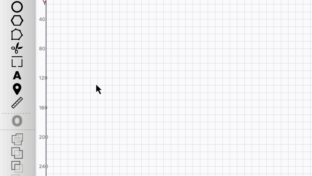

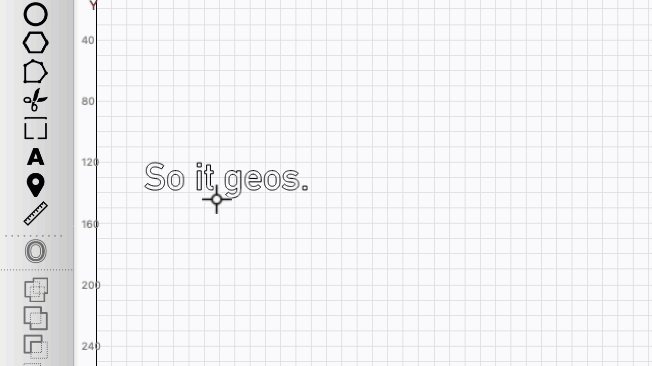

To add a Text Object to your project, click the Create Text icon in the left sidebar, go to Tools → Edit Text, or press Ctrl/Cmd+T.
Click anywhere in your Workspace and type in the text you'd like to add.
Press Enter while typing your text to jump to a new line and continue typing.
Press Esc to finish creating the Text Object.
Note
By default, the location you click will be the center of the Text Object you create, but you can adjust alignment in the Text Options Toolbar.
Create Text Demo

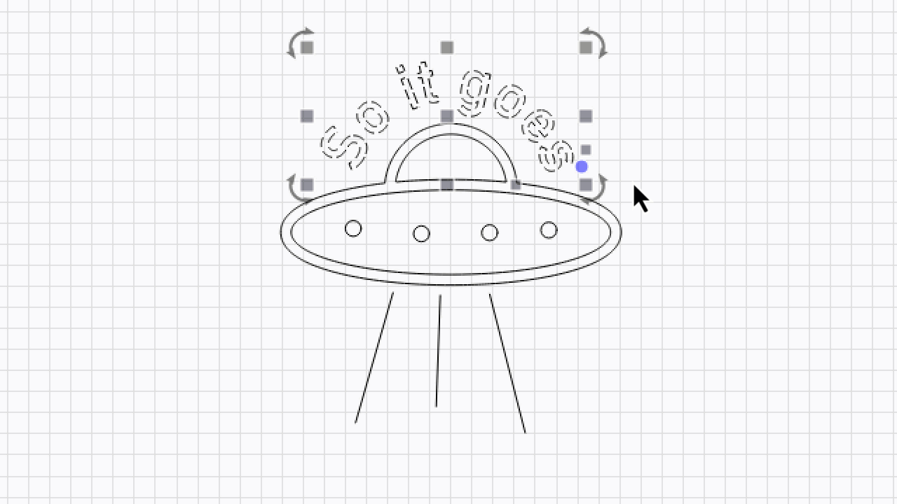

Bending Text

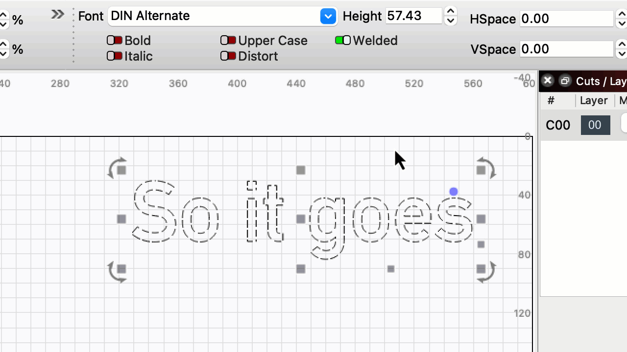

In addition to the Transform Control Handles used to Move, Resize, Rotate, and Shear objects, Text Objects have a special handle for Bending.
Select any Text Object to show a blue dot over the text, then hover your cursor over the dot until you see the Bend cursor Bend Cursor.
Click, hold, and drag the cursor up or down to curve the text around a circle.
Text Bending Example
Double-click the dot to clear the curve and restore the text.
Unbend
Enable or disable the Distort toggle in the Text Options Toolbar to choose whether to distort the text as part of the curve, or leave the individual characters unchanged.
Distort

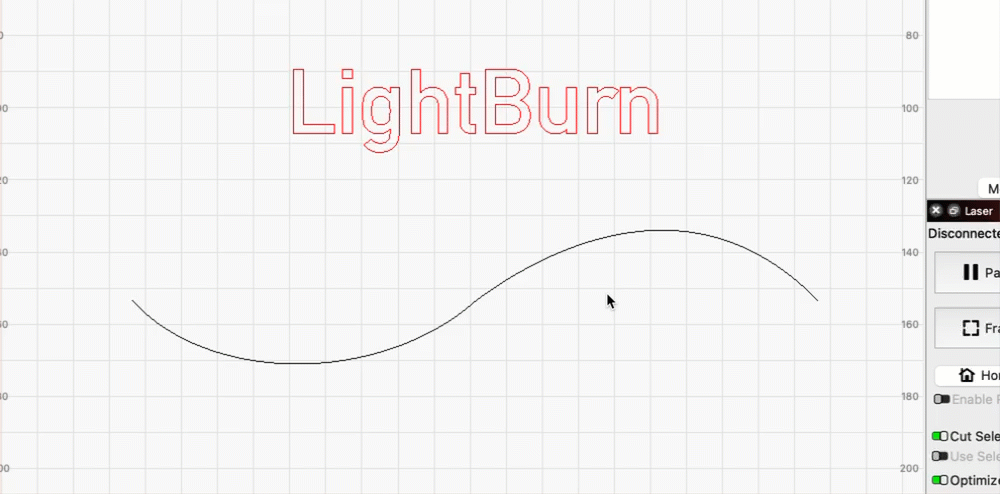

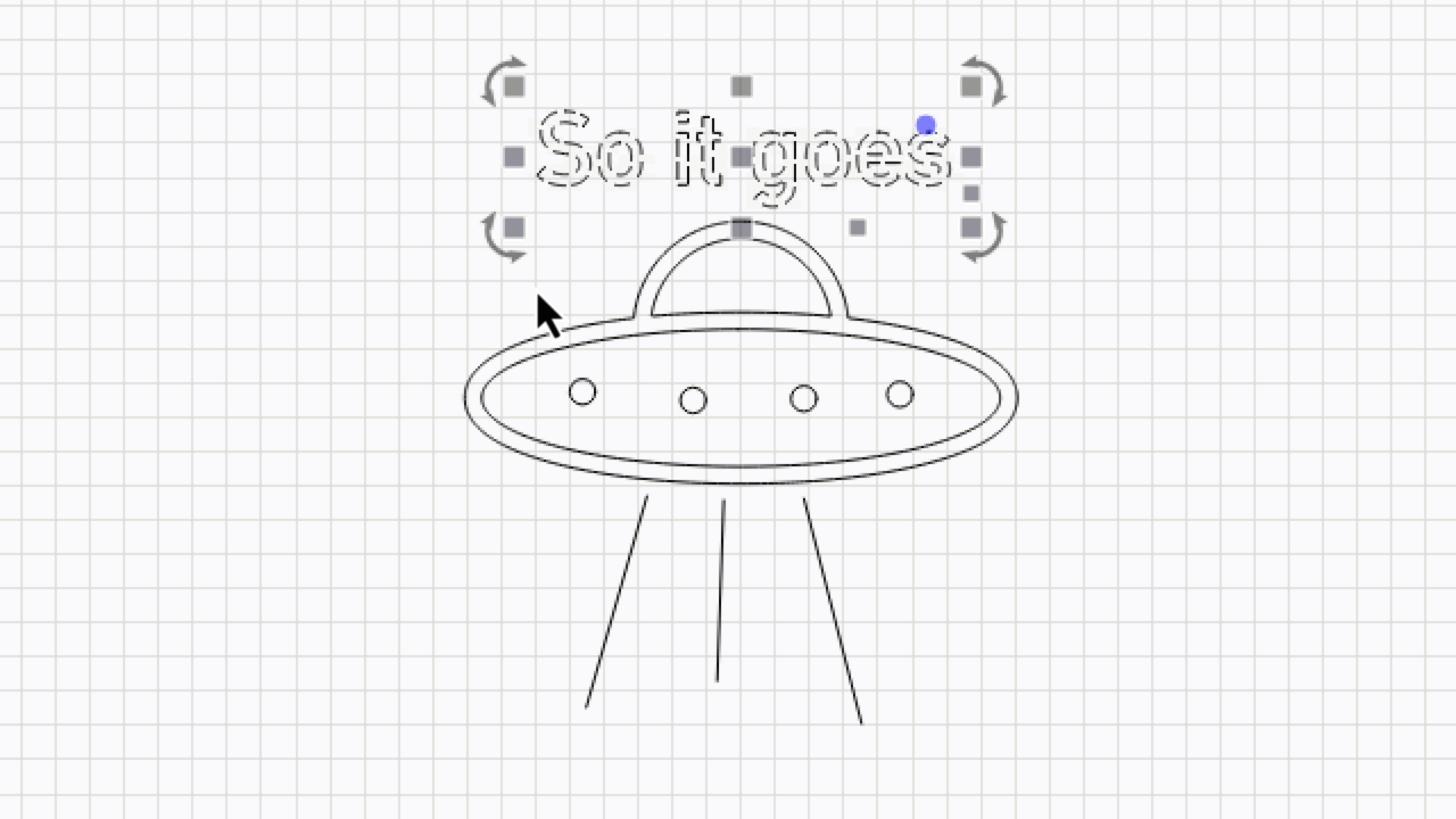

To curve text around more complex paths, use Apply Path to Text.
Apply Path to Text Demo.

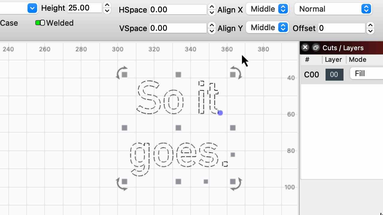

The Text Options Toolbar is where you adjust attributes of Text Objects, including, Font, size (Height), spacing (HSpace and VSpace), and more.
Accessing the Text Options Toolbar
The Text Options Toolbar is located in the top toolbar in LightBurn by default, to the right of the Numeric Edits Toolbar. The options in this toolbar are only available when you have a Text Object selected.
Tip
The layout of LightBurn is highly customizable. For more information on enabling and disabling windows and toolbars, or rearranging the default layout, see Customizing the LightBurn Window.
Options
  • Use the Font dropdown menu to select a a font. See below for more information on fonts.
  • Height sets the overall height of text. Height varies based on your selected font, and is not exact — it is generally the height of a capital letter X in the font, but every font has an internal size that is scaled by this Height, and the dimensions aren't required to be accurate.
  • HSpace adjusts the horizontal spacing between individual characters, as a percentage of the font size. Positive numbers space the characters out more, and negative numbers move them closer together.
  • VSpace adjusts the vertical line spacing as a percentage of the font height. Positive numbers increase the distance between lines, and negative numbers reduce it.

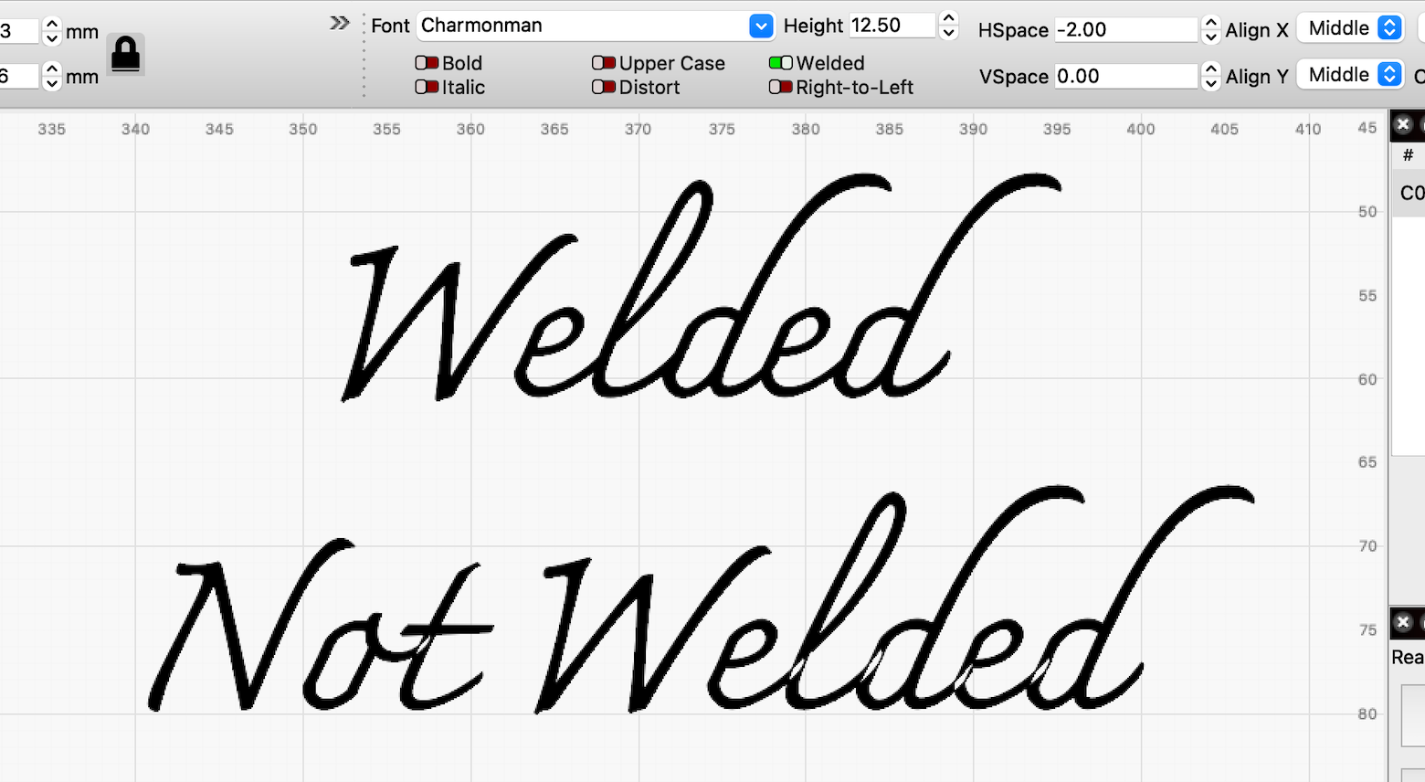

  • Welded enables automatic welding of characters. When characters touch or overlap, as is common with script fonts, enabling this option will automatically weld the overlaps together. Characters will also weld together if HSpace is reduced to a point where they overlap.
    Welded vs. Unwelded comparison
    Weld Comparison

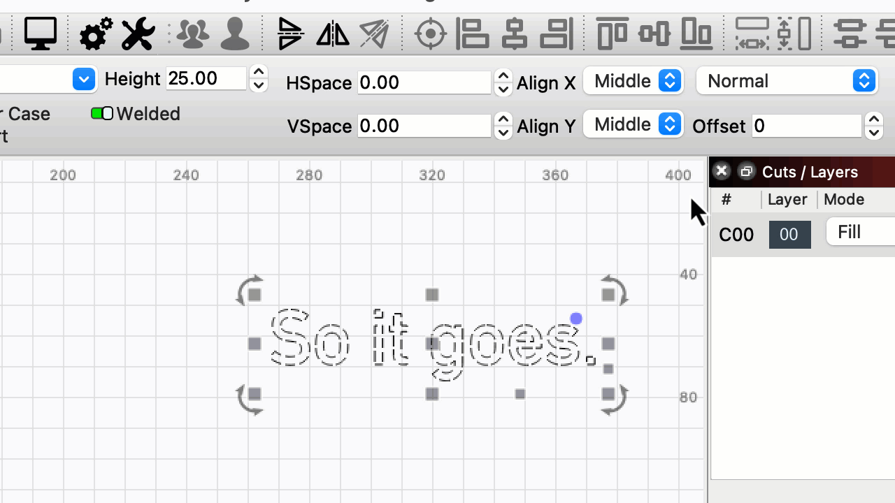

  • The Text Mode dropdown menu and Offset field are used when working with Variable Text. For information on these options, see Variable Text.
    Leave this value set to Normal if you are not using Variable Text

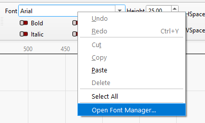

Your favorite fonts will appear at the top of the font list, followed by your most recently used fonts.
For additional options, while the font list is active, right-click the font list and select Open Font Manager....
Screenshot of context menu

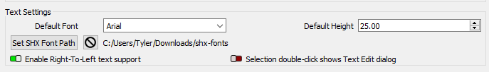

There are several global font settings in the Editor Settings tab of the Settings window.
Text Settings
  • Default Font changes the automatically selected font for new projects.
  • Default Height changes the automatically applied font Height for new projects. If you change this value, you need to close and relaunch LightBurn before the change will be applied to new projects.
  • Enable Right-to-Left text support allows you to turn on Right-to-Left font rendering for any text. This setting is automatically enabled on first run if a Right-to-Left language is the current system input language, but it can be forced on here later if necessary.
  • Enable Selection Double-Click Shows Text Edit Dialog to open a text edit window when you double-click text in your Workspace.

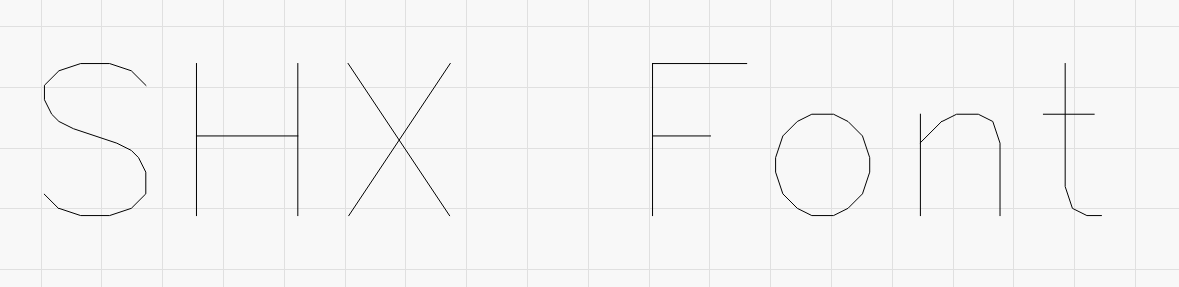

SHX Fonts
Looking for single line fonts? Find them in the "Zip Files" section
Set SHX Font Path sets the directory containing SHX font files — clicking this button will open up your system's file explorer window, where you can navigate to the location of the SHX font folder on your computer. Click the button next to Set SHX Font Path to clear the path.
Once LightBurn knows where to load the SHX fonts from, they will automatically appear in the Font dropdown menu in the Text Options Toolbar.
SHX Fonts are differentiated from normal fonts by the icon next to each entry:
  • denotes an SHX font.
  • denotes a standard operating system font.
SHX fonts lack many of limitations of standard system fonts and have the ability to define single line fonts, such as this:
Single Line Font

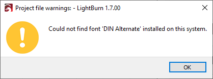

Moving LightBurn Files With Fonts
If you want to move designs containing text between computers and continue to edit the Text Objects, be sure to install all necessary fonts on all computers you're using.
When you save a copy of a file that contains text, LightBurn automatically includes a copy of the text as a path and embeds it into the file. If you open the file on another computer that has the same font, you will be able to edit the Text Objects as usual.
However, if you open the design on a computer without the font, LightBurn will warn you about the missing font(s) and load the path embedded in the file. This prevents the file from breaking when you move to another computer, but you won't be able to edit the text without the correct font.
Font not found warning message
If the font is installed at a later time, LightBurn will recognize it and the text will become fully editable again.
Right-click the imported text and select Convert to Text to change the font of the text, and regain the ability to fully edit it.
