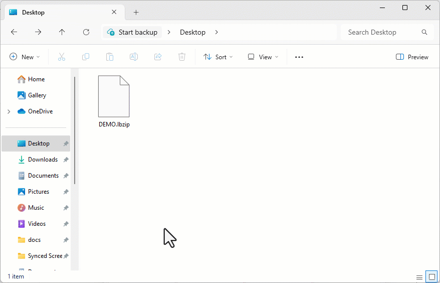

Creating .lbdev files
Warning: .lbdev files are not guaranteed to be backwards compatible with older versions of LightBurn.
If you need to create a .lbdev file, you can extract one from a User Bundle if needed. To do this:
- Export a User Bundle as described above.
- Open the
.lbzipfile in Windows Explorer or in Finder. - Change the extension of the file to
.zipinstead of.lbzip. - Open the zip folder and copy the
.lbdevfile you're looking for to a suitable location.
