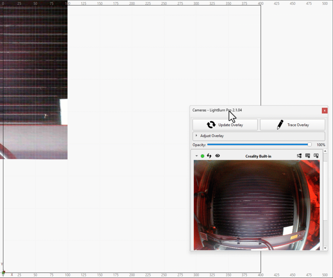

Use the Cameras window to view and manage connected cameras. To enable the Cameras window, go to Window → Cameras.
By default, the Cameras window floats over the Workspace. You can dock it by dragging it to the top or side of the LightBurn window.
Click any option in the image below to jump directly to more information about it, or scroll down for a list of options and descriptions.

Overlay¶
Update Overlay¶
Click Update Overlay to update the background of the Workspace with your camera image.
Trace Overlay¶
Click Trace Overlay to open LightBurn's Trace Image tool and trace directly from the camera.
Adjust Overlay¶
Overlay DPM¶
Use the Overlay DPM slider to increase or decrease the resolution (in Dots Per Meter) of the camera overlay.
Overlay Opacity¶
Use the Overlay Opacity slider to increase or decrease the opacity of the camera overlay. Higher (more opaque) values make the overlay easier to say, while lower values fade out the overlay and make it easier to see your own artwork.
Overlay Width / Height¶
Adjust the size of the camera overlay.
X Shift / Y Shift¶
Shift the camera image in the X and/or Y directions, if the entire image is shifted over from where it should be.

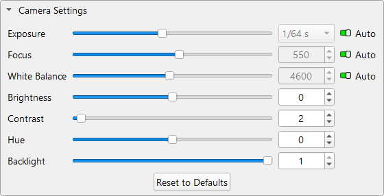

Camera Settings¶
The Camera Settings section contains settings for adjusting your camera image.
The default settings here are chosen to work for most setups, but you can adjust your settings using the sliders or numeric entry boxes. For Exposure, Focus, and White Balance, you can also enable or disable automatic adjustment here.
Advanced¶
The Advanced section contains less commonly used camera settings.
Preview FPS¶
Use the dropdown to set the framerate of your camera. Higher numbers capture more images per second, giving you a more responsive preview, but also increasing the demand on your computer.
If your camera seems to be slowing down your computer, try lowering the framerate. On the other hand, if you've got a powerful computer and want a more responsive preview, you can try increasing the framerate.
