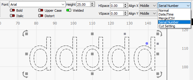

Selecting a Variable Text Mode
To create Variable Text, first use the Create Text tool to enter the appropriate expressions for the type data you'd like to output, then select the matching Text Mode from the dropdown menu in the Text Options Toolbar.
Select Date/Time (for date and time stamps), Merge/CSV (for entries in a CSV file), Serial Number, or Cut Setting.

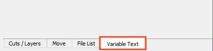

Accessing the Variable Text Window
The Variable Text Window is not enabled by default. To enable it, go to Window → Variable Text.
The Variable Text Window will appear docked behind the Cuts / Layers Window on the upper right side of your screen. Click the Variable Text tab to bring the Variable Text Window to the front.
Variable Text Window tab next to other docked window tabs

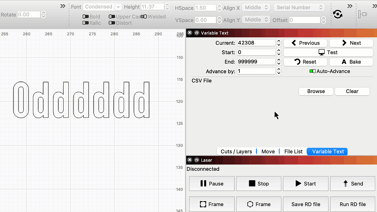

Current
Determines the serial number or row from a CSV file that will be substituted in place of the formatted expressions the next time the project is output.
Note
The Current value advances between the Start and End values. In other words, the sequence returns to the Start value when increasing beyond End, or to the End value when decreasing beyond Start.

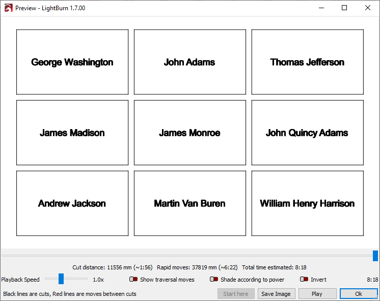

Using Variable Text in Virtual Arrays
When using Variable Text in a Virtual Array, the Test button will not show the final output of the Variable Text in LightBurn's workspace. To see an accurate preview, you'll need to use the Preview window.

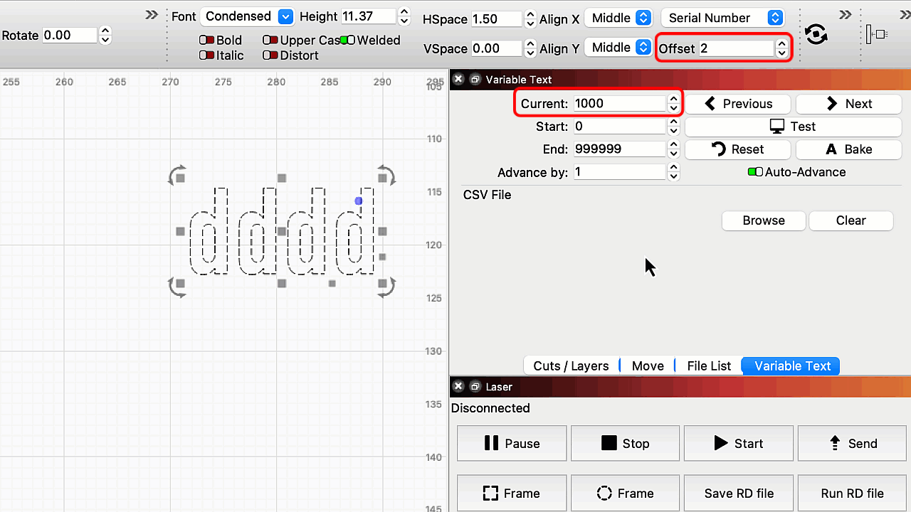

Variable Text Offsets
Text Objects in LightBurn have an adjustable property called Offset, available in the Text Options Toolbar. Using Offsets allows you to use the same formatting expression to output different data.
The Offset value is added to the Current value in the Variable Text Window when LightBurn evaluates the Text Object to determine the data to output in its place.
For example, if you applied an Offset of 2 to a Text Object formatted to output a serial number, with a Current value of 1000, the output serial number will be 1002.
Serial number Offset demo
Tip
Use the Offset value in conjunction with the Advance by value to increment batches of the same design using Variable Text. For instance, if you created a design with 4 name tag labels on the page, you would set the Offset value for the four labels to 0, 1, 2, and 3, and set the Current value to Advance by 4 with each run.

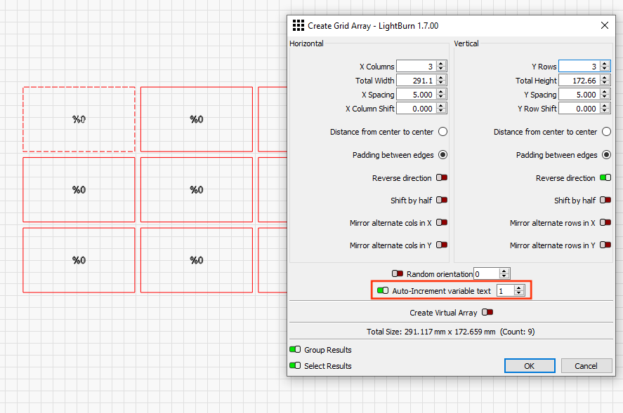

Automatic Offsets
Some LightBurn tools can apply automatically advancing Offset values to duplicated objects.
Use Grid Array, Circular Array, or Copy Along Path to lay out copies of designs while increasing the Offset of each copy by a specified amount.
  • Grid Array Auto-increment Offset demo
  • Grid Array Auto-increment Offset demo Preview

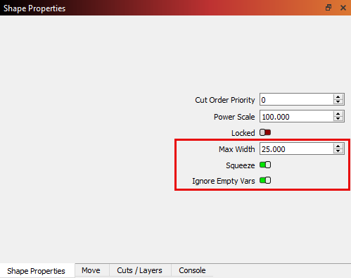

Shape Properties and Variable Text
There are three settings in the Shape Properties Window that are useful when working with Variable Text.
Variable Text Shape Properties
  • Max Width sets the maximum possible width of selected Text Objects — use this field to prevent Variable Text outputs from exceeding a specified width after they're converted from formatted expressions.
  • The Squeeze toggle determines whether Text Objects will be rescaled in both directions in order to fit within the Max Width value.
    When enabled, text will be shrunk horizontally, if necessary to stay within the Max Width, but maintain the same height.
    When disabled, text will be shrunk proprotionally, both horizontally and vertically.
  • Ignore Empty Vars instructs LightBurn to remove newlines preceding empty Variable Text fields when aligning text.
Max Width and Squeeze Demonstration
