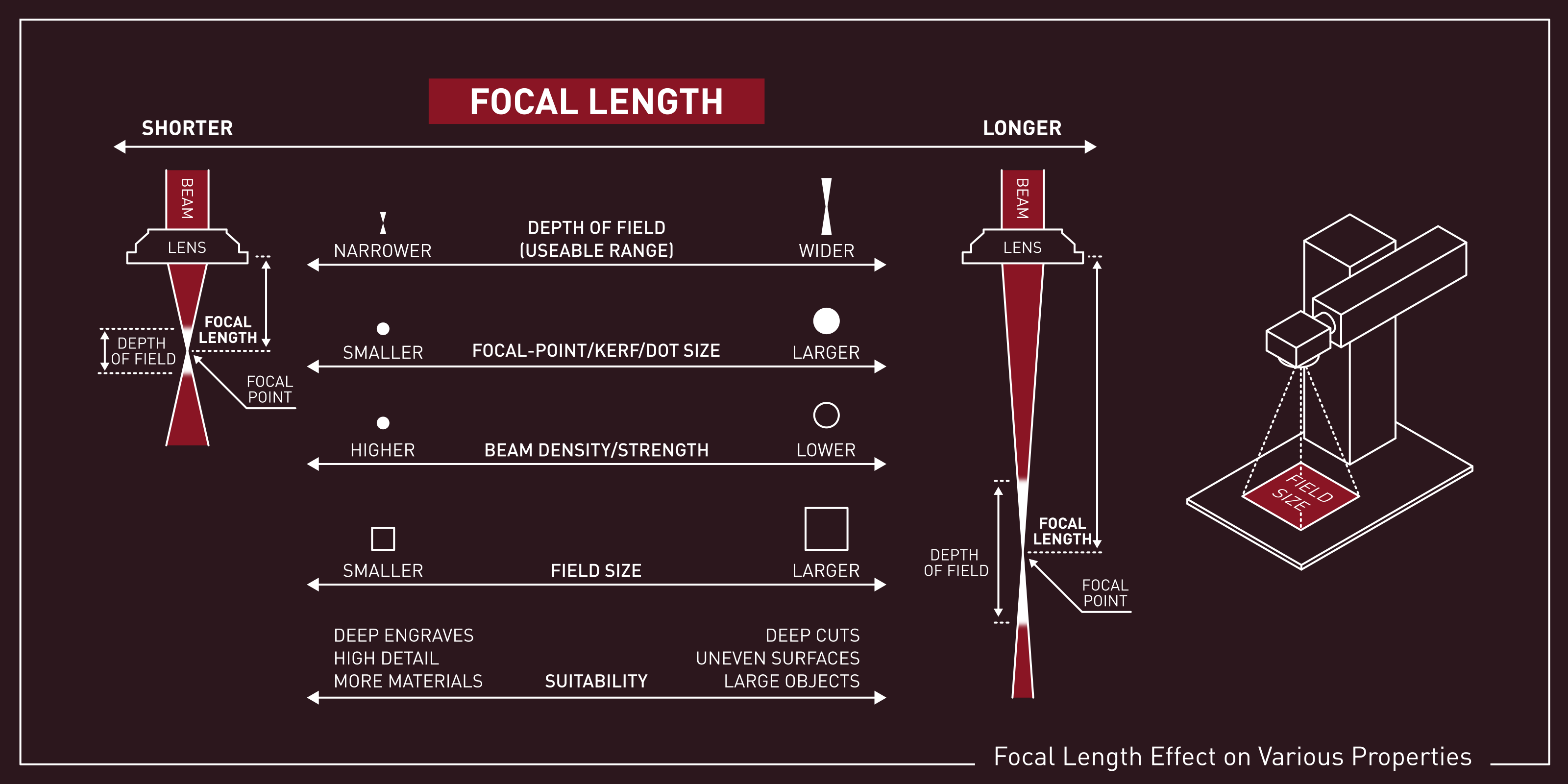

Finding Your Focal Point
Each lens should be labeled with a focal length, such as F330 for 330 mm lenses or F160 for 160 mm lenses. This is a good starting point for focusing, but manufacturing differences result in discrepancies between lenses, so you should still fine-tune the focus by looking for crisp outlines in framing or listening for audio cues.
To use "crisp outlines" to find the focal length, you'll need to Frame a design and raise/lower the galvo until the edges are as crisp as possible. This requires your galvo to have an in-line red dot.
With audio cues, you'll instead listen for louder burning or sizzling noises while the job is running. The correct focal length will generally make the loudest sounds.
While the depth of field is a range that produces engraved results, finding the optimal focal point within that field is important to ensure the best results, and is best found through trial and error.
