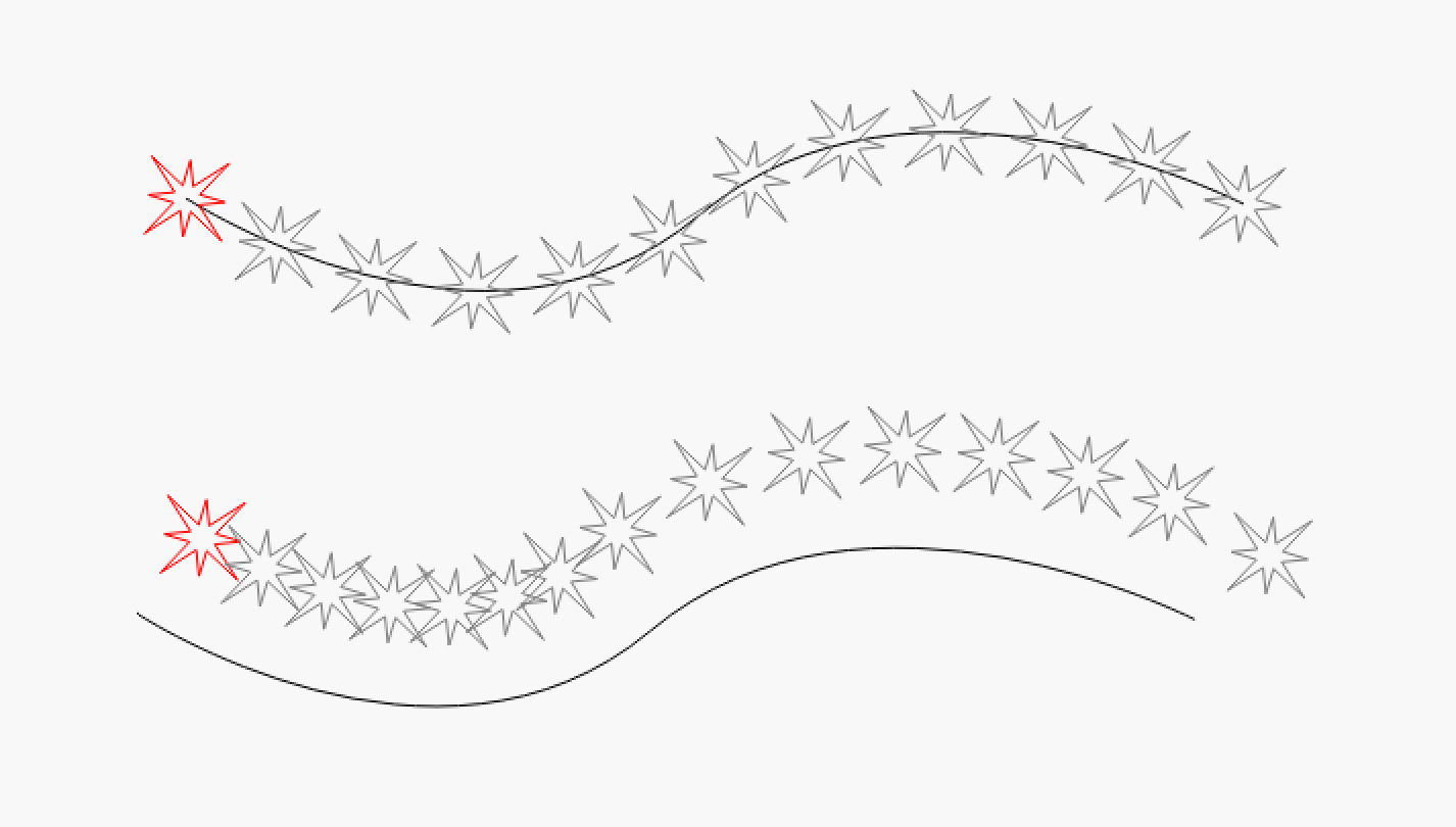

Placement
The placement of the original object to be copied relative to the start of the path determines the position of the copies.
CopyAlongPath-Placement
Place the center of the object to be copied on the start of the path to superimpose each copy over the path.
Offset the object to be copied from the start of the path to maintain that distance from the path with each copy.

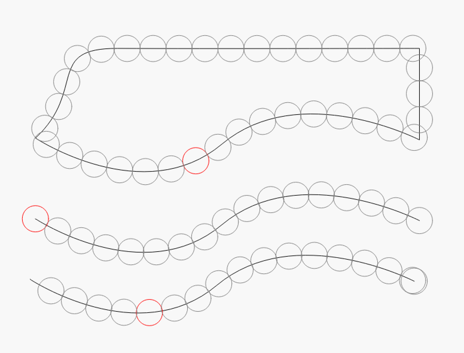

Open vs. Closed
CopyAlongPath-OpenClosed
When using a closed path, the copied objects will start at whatever part of the path is closest, and then wrap around the circuit of the path to meet back up at the same point.
When using an open path, it's best to center the object to be copied over an end point of the path. This will create even spacing along the entire path.

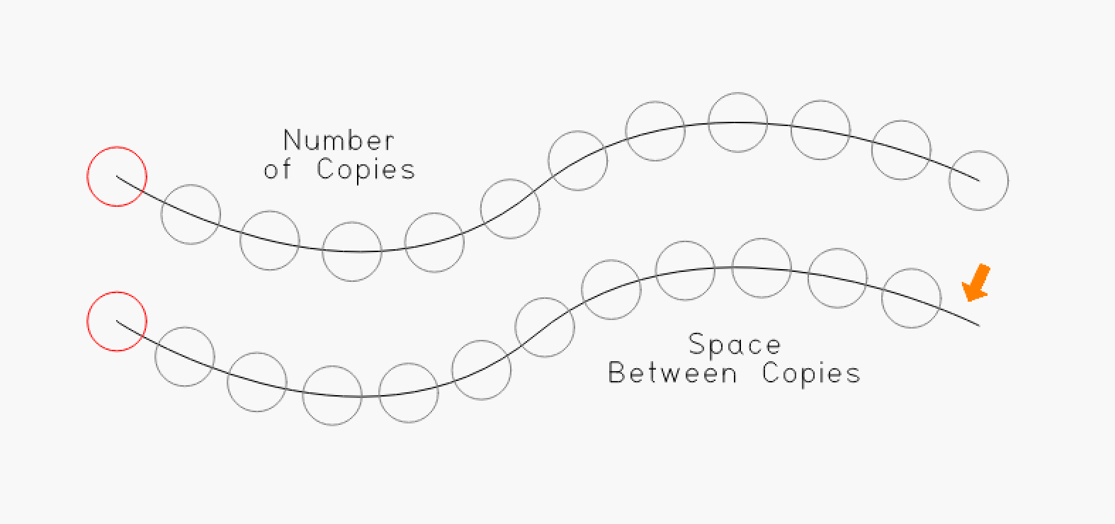

Spacing
spacing The spacing of copied objects is measured from the centers of each copied object. There are two ways of spacing the copies objects along the path:
  • Number of Copies spreads a certain quantity of them along the path, with even spacing between.
  • Space Between Copies fills the path with as many copies as it can fit, given the spacing you provide. This usually leaves some excess line at the end of the path.

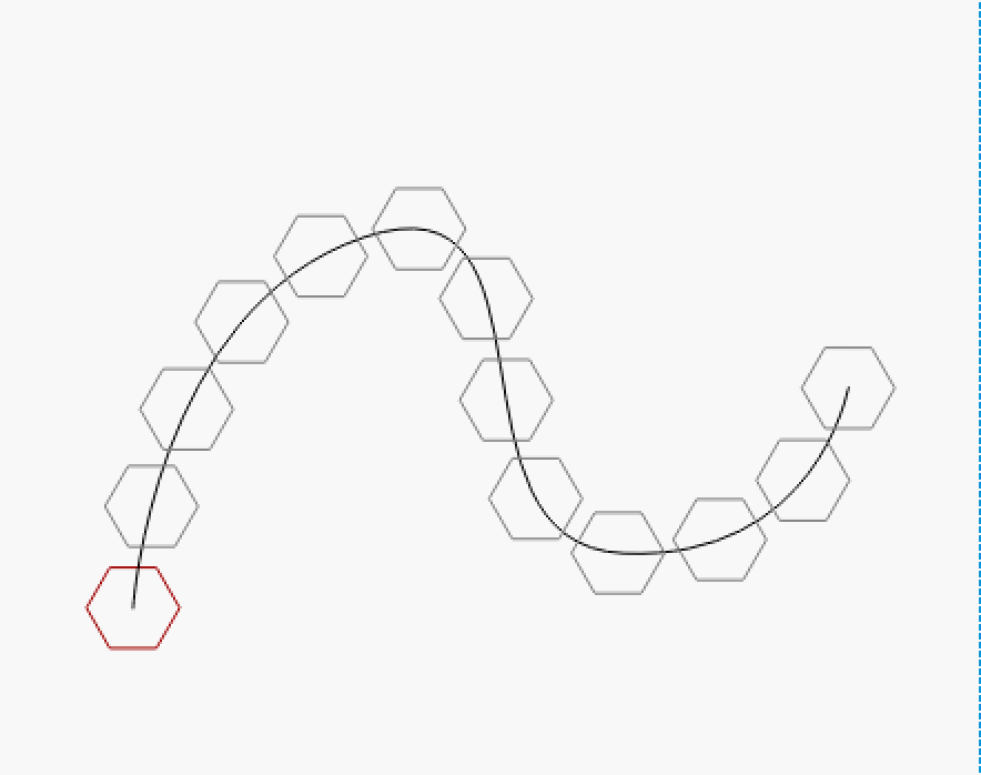

Rotate Copies
rotation
Enable Rotate Copies to create duplicates that are oriented acording to the changes in direction of the path. Disable this option to create objects that remain in the same orientation as the originally-copied object.

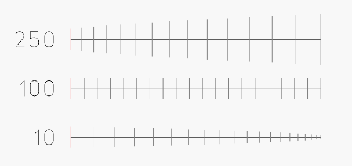

Scale Copies
rotation
Enable Scale Copies and enter a value in the adjacent field to incrementally change the size of each copy, with the final one reaching a size equal to this percentage of the original's size. A number larger than 100 will increase the sizes of the copies, a number lower than 100 will decrease them, and setting it to 100 (or disabling the switch) will keep the copies the same size as the original.
