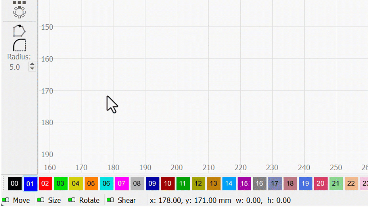

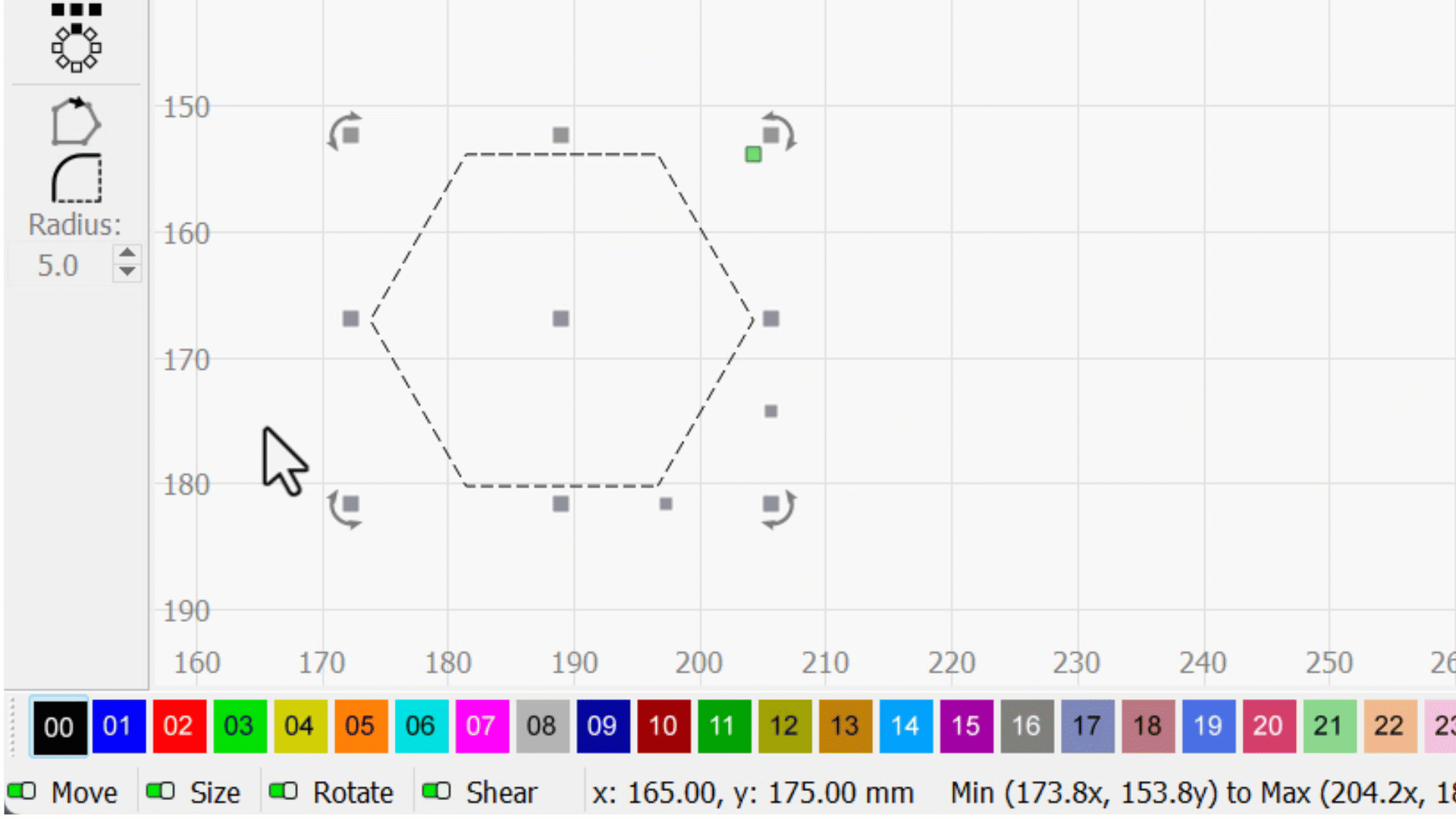

You can use the Color Palette at the bottom of the Main Window to assign colors/layers to graphics in your project. If you already have objects selected, clicking a color will set the selected objects to that color/layer:
Changing shape layer with Color Palette
If you don't have any objects selected, clicking a color will determine the color/layer that subsequent new objects you create will be set to:
Changing layer color for new shape

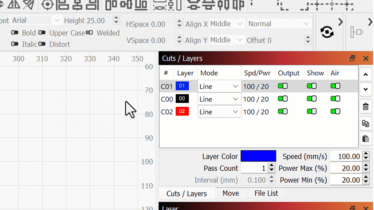

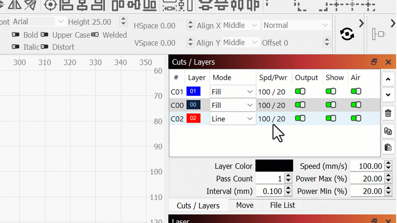

Once any graphic in your project has been assigned to a color/layer, you'll see that layer appear in the Cuts / Layers Window. You can use the drop down menu in the Cut / Layers Window to set the mode of given layer:
Setting layer mode in Cuts/Layers window
By default, operations are performed by your laser according to the order of the layers in the Cuts / Layers Windows. Click and drag a layer or use the arrow button on the side to change the layers' order:
Changing layer order

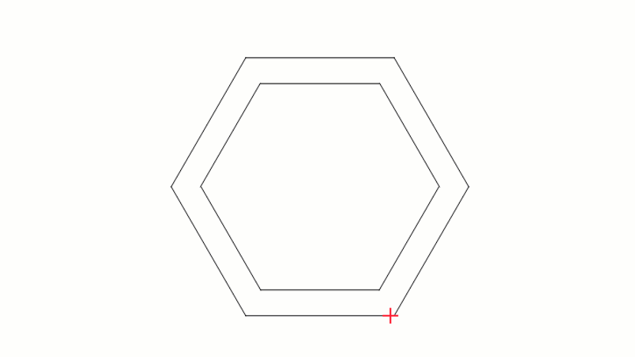

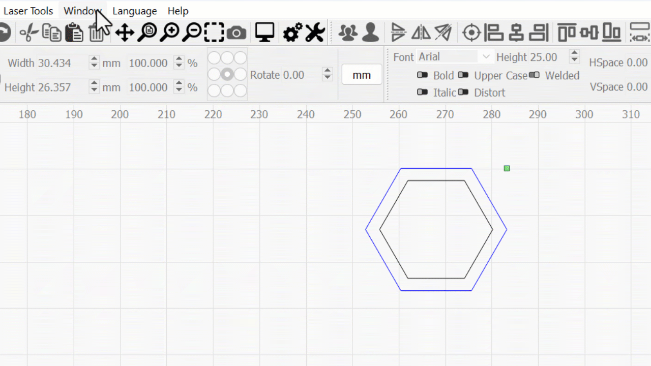

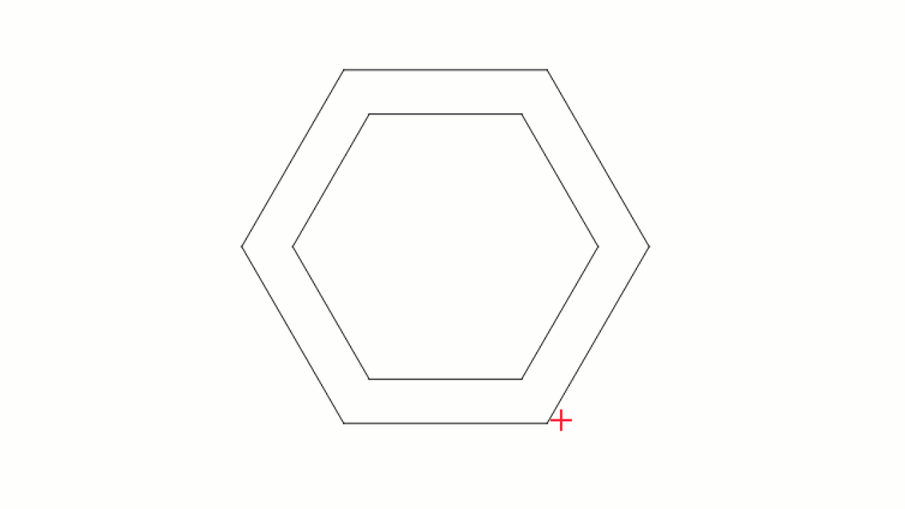

For instance, if you have two shapes set to the same layer, and one is inside of the other, the area between the two outlines will be filled.
Interior Fill Demo

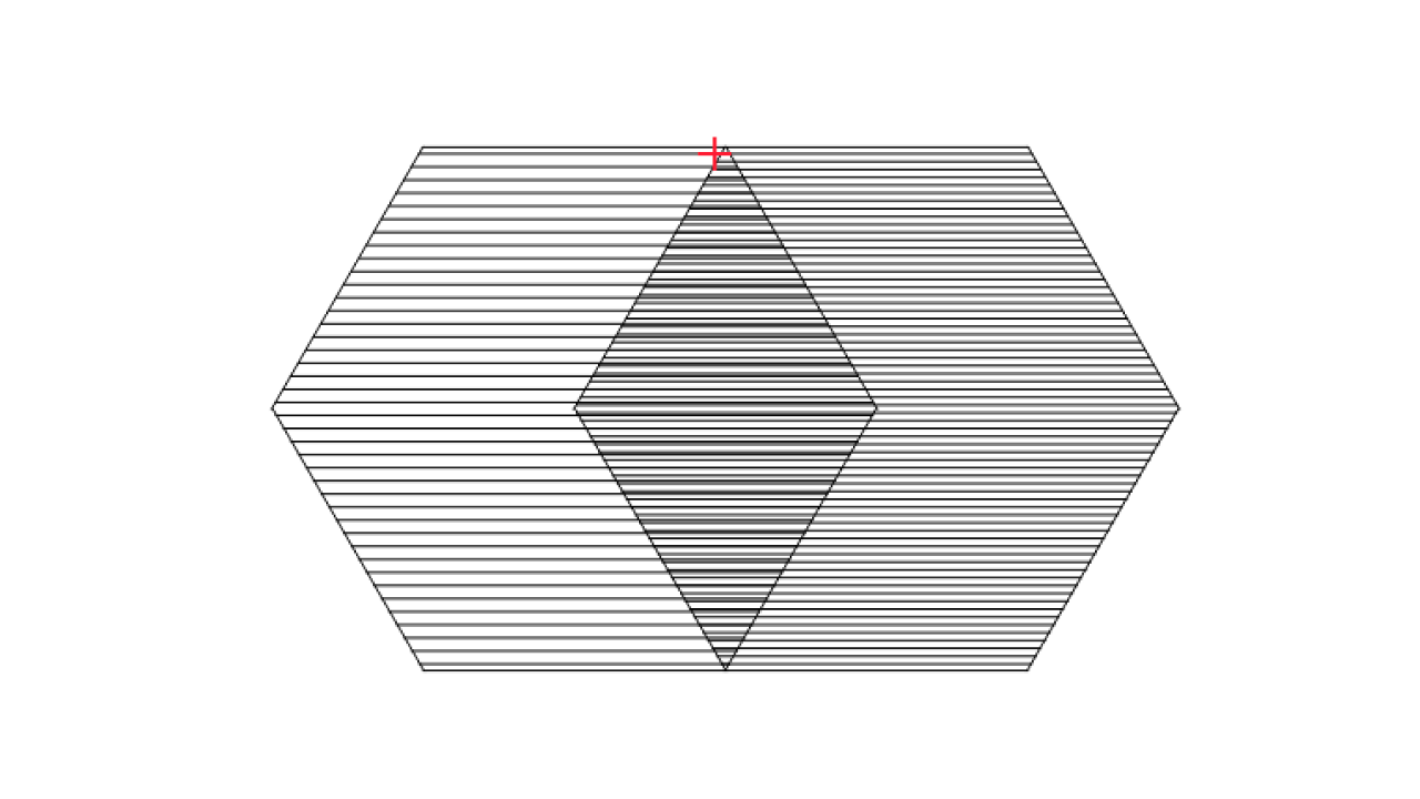

If those same two shapes are set to different layers, the entirety of the outer shape and the entirety of the inner shape will both be engraved, meaning the area within the inner shape will be engraved twice.
Overlapping Fill Demo
This difference in logic may not be what you're expecting if you come from other design software, where parts of layers can be hidden behind others, and not appear in the final outcome.

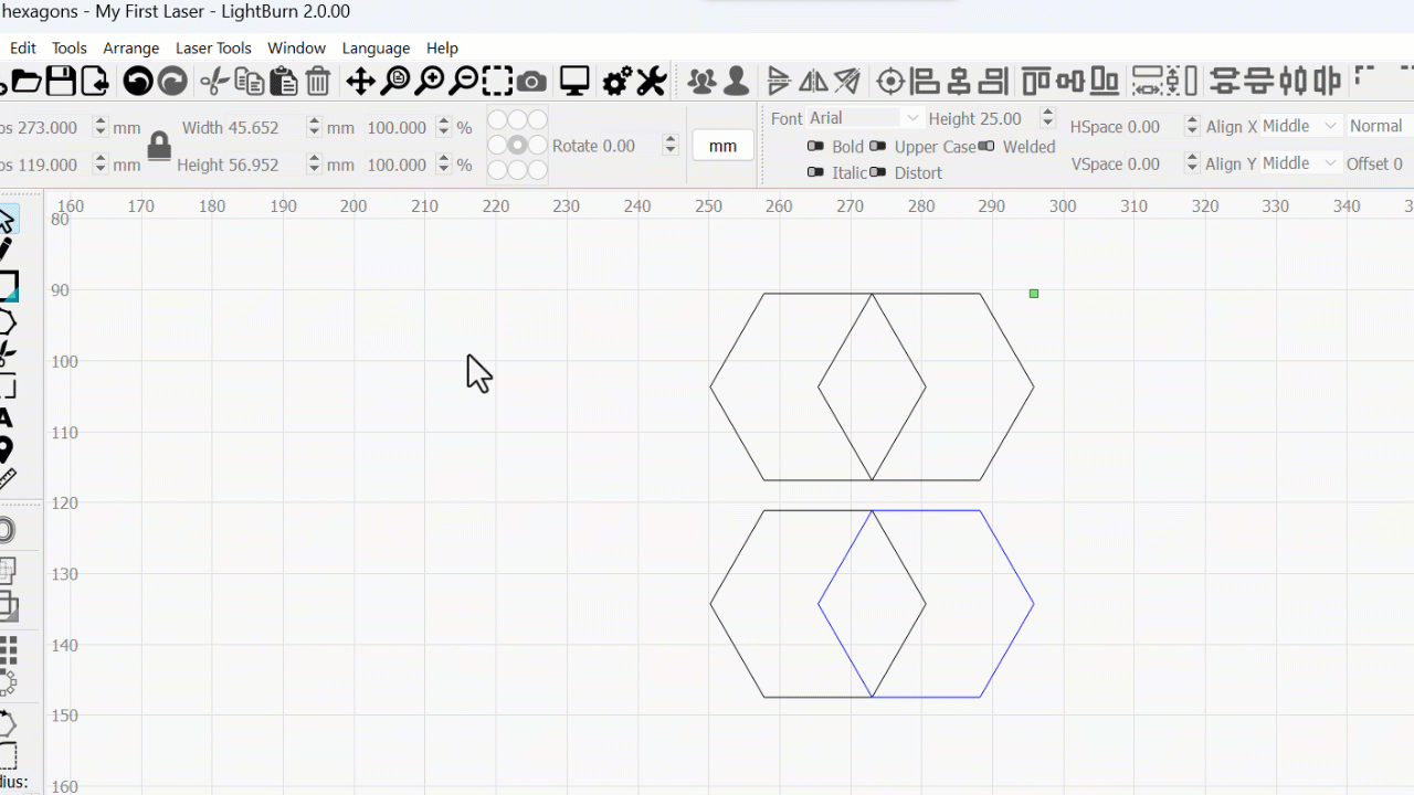

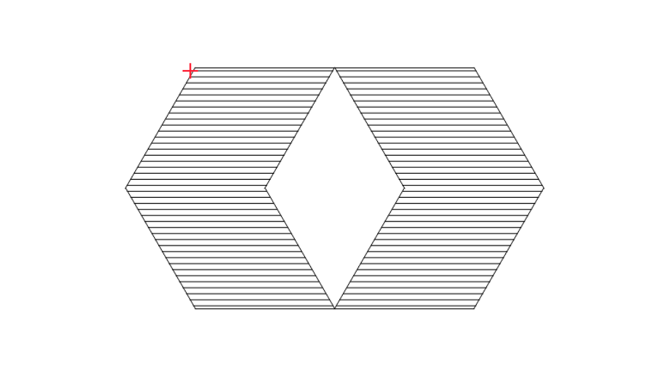

The same logic holds true when shapes only partially overlap — if the shapes are assigned to the same Fill Mode layer, the area where they overlap will not be engraved. If they are set to different Fill Mode layers, the area where they overlap will be engraved twice.
Partially overlapping shapes set to the same layer
Partially overlapping shapes set to different layers
In most cases (but not all!) you probably do not want these overlapping areas engraved twice, so always keep this in mind as you're creating and modifying designs.
