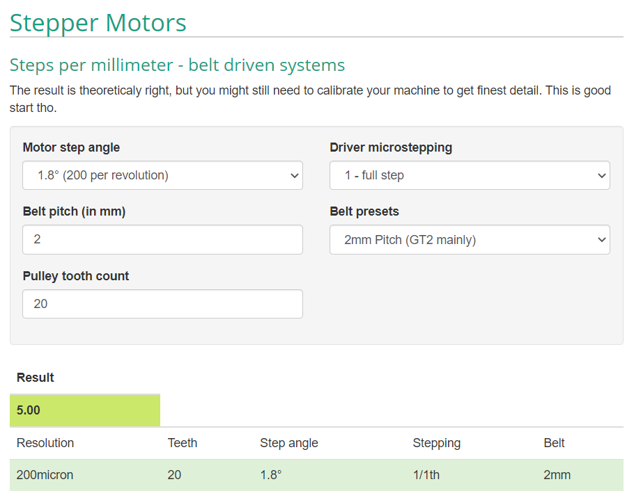

For the above configuration, setup the calculator as shown below:
You would needs 5 steps per mm of movement. This is because a 20 tooth pulley represents 40 mm of movement for one full rotation (20 teeth * 2 mm per tooth) and there are 200 steps per full rotation. So 200 / 40 = 5.

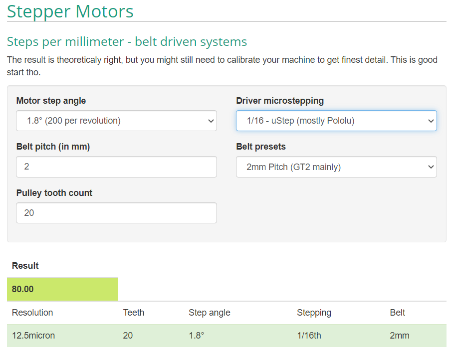

Very few machines will ever run in "full step" mode as shown in the example above. As you can see at the bottom of the example above, the resolution is 200 micron or 0.2 mm. That means the absolute smallest distance that can be moved is 0.2 mm, which is not nearly good enough. Modern stepper motor drivers, however, can pull off a trick known as microstepping, in which they can move in steps between the natural steps of the motor. A common option is 1/16th microstepping which means that it divides each natural step into 16 sub-steps, multiplying the number of steps required per full rotation from 200 to 3200!
As you can see now, the steps/mm value jumped from 5 to 80 and now has a resolution of 12.5 micron or 0.0125 mm.
