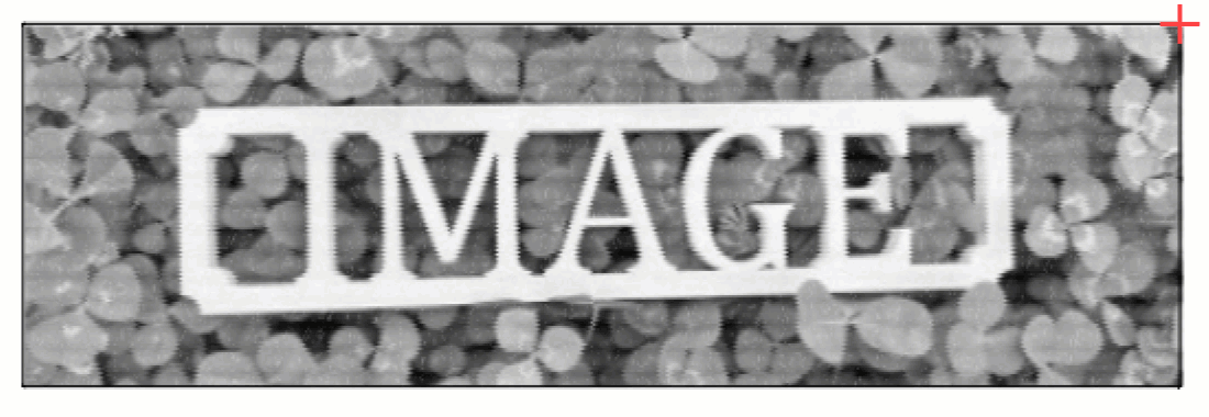

Images can only be used for engraving, not cutting. When a laser produces an image, it does so by scanning side-to-side across the material surface. As it moves, it can create shading by either switching the beam on and off to form little dots, or by varying the power. Producing an image in this way generally takes a considerable amount of time, as each line is usually a fraction of a millimeter apart, and it takes hundreds of lines to form most images.
Image Appearance and Quality
When an image is used, LightBurn assigns it to a layer set to Image Mode. When selected, images appear with a border in the color of the layer they are assigned to. If you zoom in on an image, or make an image larger, the blocks of color will eventually become noticable, resulting in an undesirable "pixelized" quality.

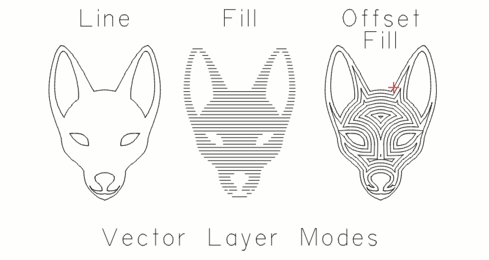

To use a vector to cut, score, or make a line or perimeter, you must assign the shapes to a layer set to Line Mode. This tells the laser to trace/follow the paths and shapes of the vector.
vector layer mode types

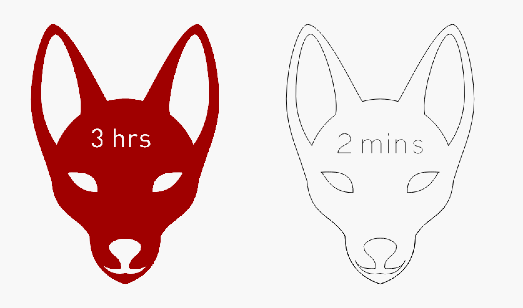

Vectors used to engrave an area must be closed shapes and assigned to a layer set to either Fill or Offset Fill. Engravings are produced in a similar fashion to images — with many lines next to each other — however, there is no variation in power, nor dot-dithering, so the result is a flat color without gradients or shading.
Filling areas is generally much more time consuming than marking or scoring them, so it's a good idea to consider if a design can be produced using Line layers.

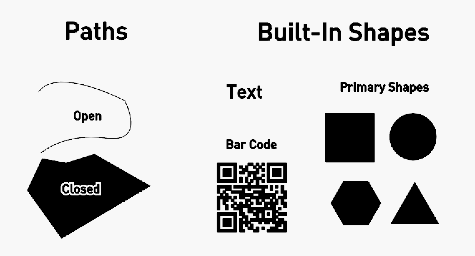

The most simple form of vectors in LightBurn are paths, created using Draw Lines and edited using Edit Nodes. These paths can be open or closed.
LightBurn also offers more intelligent vectors in the form of built-in shapes. These have properties that remain editable so long as the object isn't converted to a path. Built-in shapes include Text, Bar Codes and Primary Shapes such as Ellipses, Rectangles, and Polygons.
