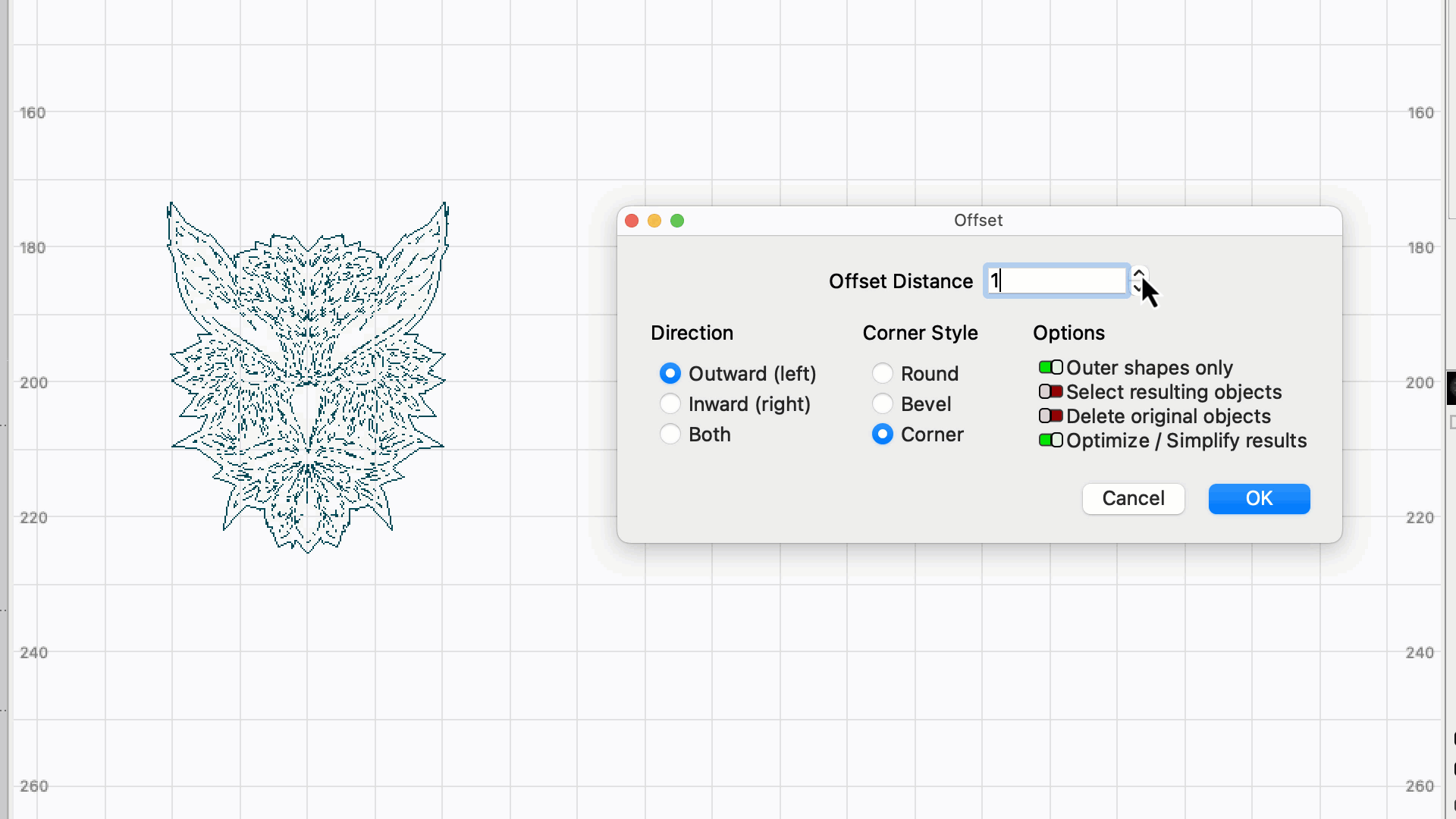

Offset Distance
Offset Distance controls the amount the new shape will be offset away from the original. Adjust the distance by typing a value into the adjacent field, clicking the arrow buttons, hovering over it and scrolling with your mouse wheel, or dragging with two fingers, if you're using a trackpad.

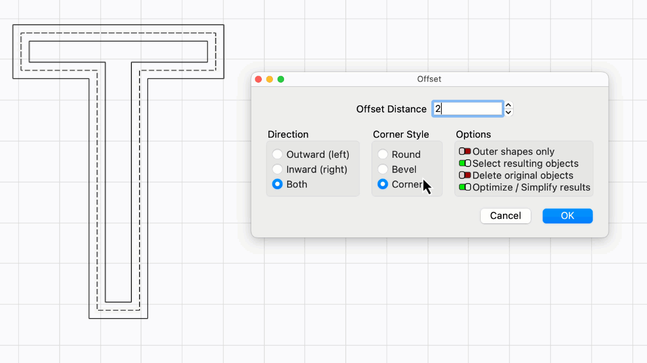

Corner Style
Corner Style controls the appearance of the corners in the offset shapes. You can choose Round, Bevel, or Corner.
Corner Styles
Corner Style and Inward/Outward Corners
Corner Style affects outward- and inward-pointing corners differently — offset corners are only beveled or rounded when they're created in the direction a corner points. In the opposite direction, offset corners are always corners as well.
Notice the difference in the inward and outward offsets for the letter T below. The corners of the outer offset are beveled and rounded where the corners of the T point out, while the corners of the inner offset are beveled and rounded where the T's corners point in.
Offset Shapes inner/outer corner demo

  • Outer shapes only: will ignore any shapes contained within others when creating the offset, leaving just the outermost border.
    Use Offset Shapes to create a cut around a complex engraving

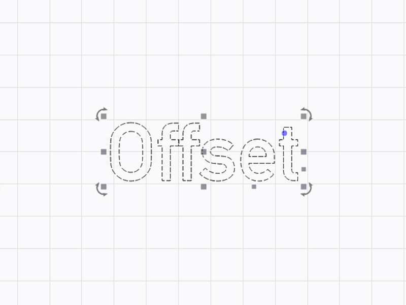

Previewing and Completing the Offset
When you open the Offset dialog window, the offset that will be created as the result of your settings will appear in your Workspace, and will live-adjust to reflect settings changes you make.
Click OK to create the offset, or Cancel to discard the settings and exit the window.
Offset Shapes example
