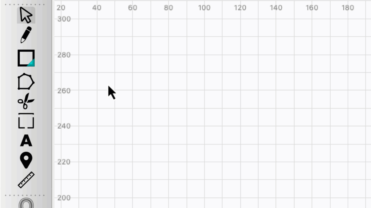

Each Primary Shape is available in the Draw Shapes submenu of the Creation Toolbar or Tools Menu.
In the Creation Toolbar, click the arrow in the lower right corner of the icon, or click and hold anywhere on the icon, to open a submenu with the indivual tools.
Click one of the Primary Shape tools from the submenu to enable it.
By default, the Draw Shapes icon is set to the Rectangle tool, and clicking once anywhere on the icon (other than the arrow in the bottom right) without holding will enable Rectangle creation.
Once you've selected a different shape from the submenu, its icon will appear, and you'll be ready to create it. If you exit the Draw Shapes tool, you can click once to re-enable creation of the last-selected type of shape.

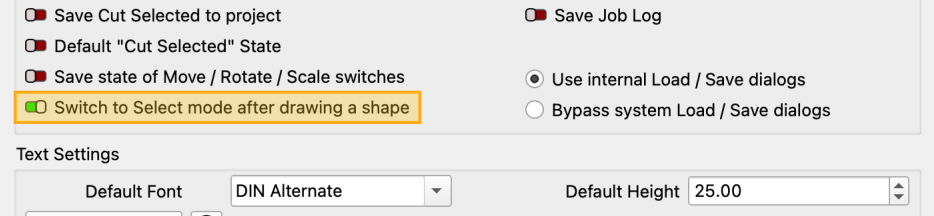

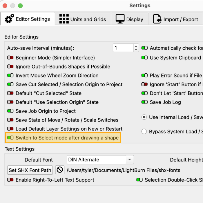

Enable Switch to Select mode after drawing a shape in the Editor Settings tab of your Settings to immediately exit the Draw Shapes tool after creating a shape and enable Selection mode instead.
Switch to Select mode after drawing a shape switch in the Settings window

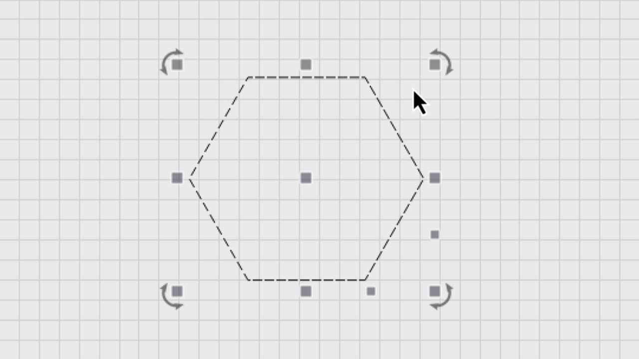

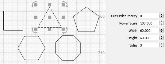

Sides — Polygons Only
Adjust the number of Sides of a Polygon in the Shape Properties Window to form different shapes — 3 will create a triangle, 6 will create a hexagon, 8 will create an octagon, and so on.
The Triangle, Pentagon, and Octagon tools all create polygons with the appropriate number of sides already set in the Shape Properties window, but each can be changed to a different type of Polygon after they've been created.
polygons of different sides
It's also possible to change the number of sides by holding Ctrl / Cmd and dragging the purple control handle that appears near the polygon. using control to change the sides

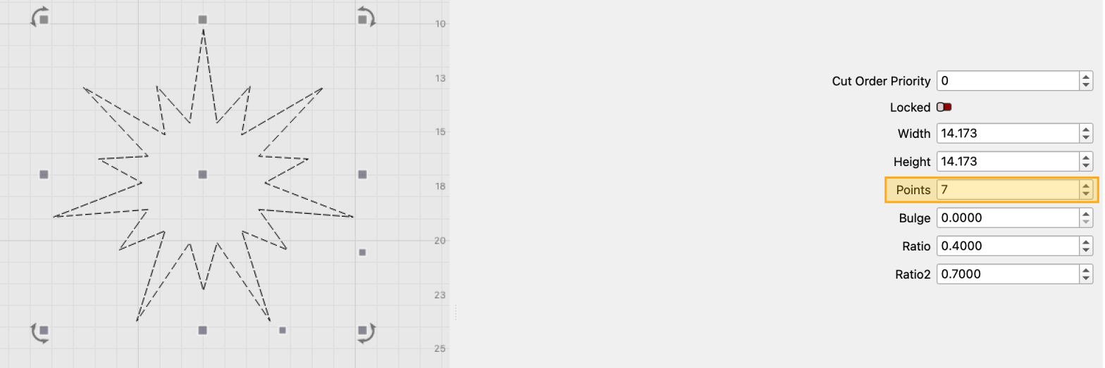

Points
The Points field controls the number of points on a Star.
For Dual Radius Stars, two sets of points are created, the Points field controls the amount of each individual set — in other words, the total number of points is two times the value entered in the Points field.
Points of a Star

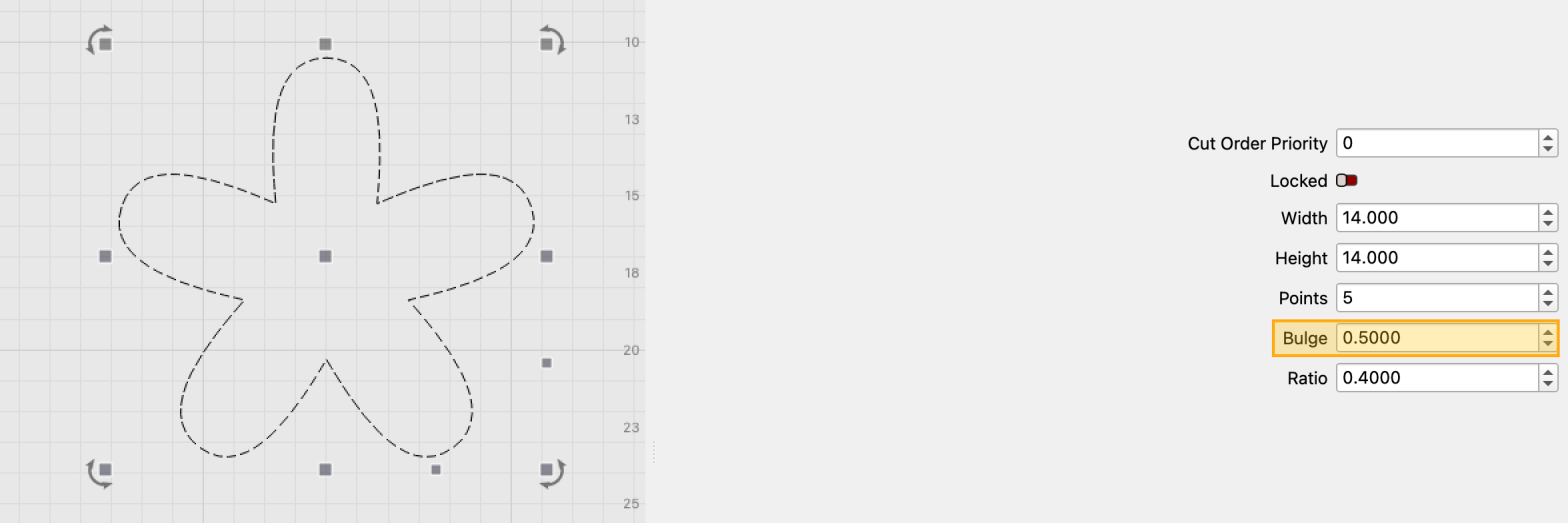

Bulge
Applying a Bulge value creates an arc from the top of each point to its base. Accepted values range from 0 to 1.
Bulge of a Star

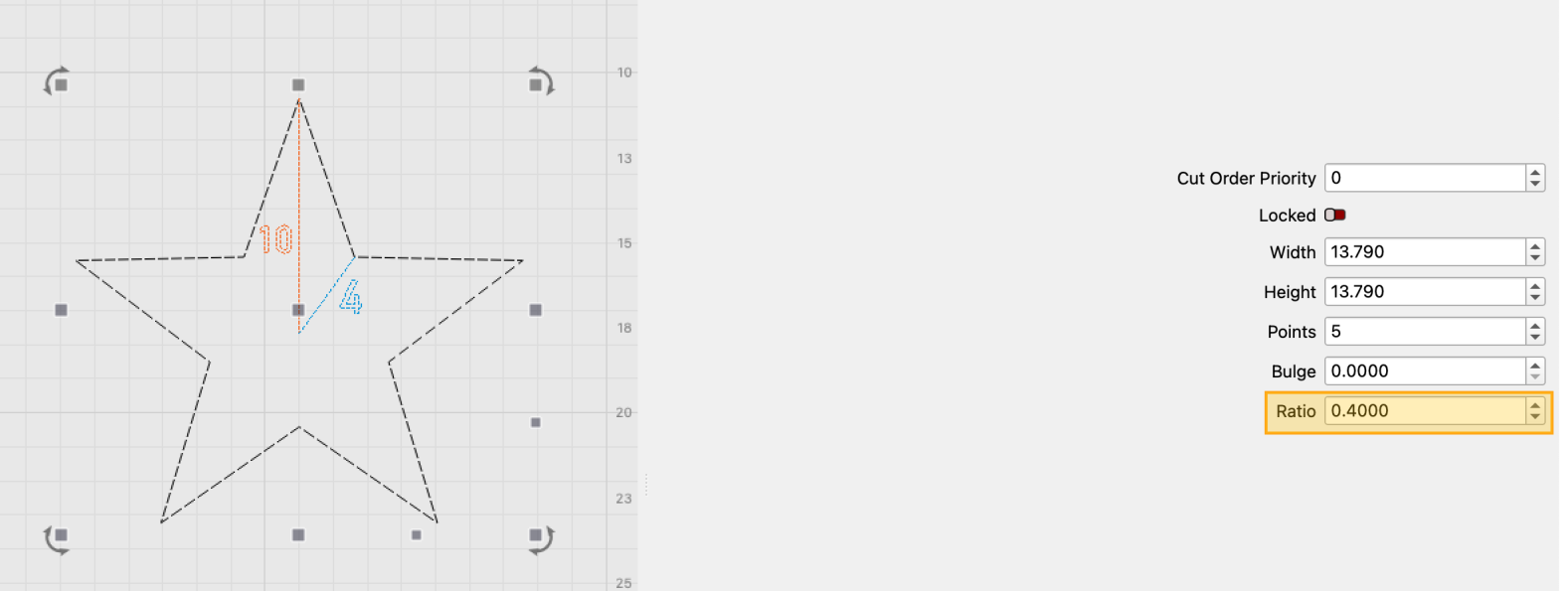

Ratio
Ratio defines the relationship between the distance from the Star's center to an outer point and to an inner corner, effectively determining the length and angle of star points.
For Dual Radius Stars, you can enter a separate value in Ratio and the Ratio2 fields to adjust the two sets of points individually.
Ratio of a Star
