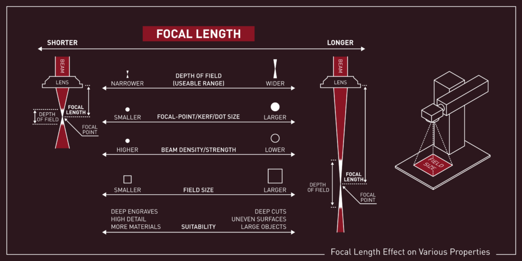

1. Focal Length
Focal Length Diagram
Diagram of the effect of focal length on image engravings
Focal length affects the strength and size of the laser dot where it meets the material. A laser that is perfectly focused will have the smallest dot possible, with the highest strength of the beam.
To find the correct focal length for your hardware, use Laser Tools → Focus Test, if your machine has a motorized Z Axis.
For lasers without a motorized Z Axis, use the method of focusing described by your machine’s manufacturer.
Tip
Some people prefer the look of a slightly defocused laser for engraving, as it softens the edges between scan lines. However, adjusting settings is easiest with a focused laser. We recommend keeping the laser focused while conducting the following steps, and playing with defocusing as an optional step at the end.

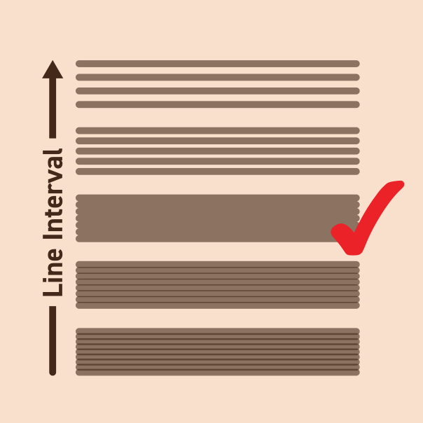

3. Line Interval/DPI
Line Interval Diagram
Ideal settings for Line Interval/DPI
Line Interval and DPI are tied together. They change the distance between each pass (scan) of the laser head. If Line Interval is too low (and DPI too high), images will be very dark (as the lines overlap). Too high and the image will be too light.
Use Laser Tools → Material Test to find the ideal interval. You’re looking for the value that creates lines that just touch (don’t overlap, nor have a gap). Try values between 120 and 300 dpi (0.08-0.2 mm). You will need a microscope or strong magnifying glass.
If you don’t wish to use the Interval Test, or you are having trouble seeing the overlap of lines on your material, try engraving a gradient and manually varying the Line Interval in the Cut Settings Editor.
When you have found an ideal Line Interval setting, apply it to a layer set to Image Mode in the Cut Settings Editor, or save it to an entry in the Material Library.
Tip
  • When working with material with a grain (e.g wood), orient the test so the scan lines are perpendicular to the grain — parallel makes it difficult to distinguish between engraving texture and material texture.
  • A raking light can help to differentiate scan lines.
  • For best results, create future images with the same DPI as dictated by the Line Interval you found in this step.

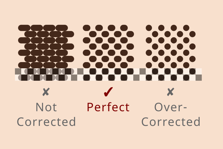

4. Dot Correction
Dot Correction Diagram
Diagram showing different levels of Dot Correction
Beams have a thickness which makes dots longer than they should be — we can correct that with Dot Width Correction. Make sure you adjust your settings in Cut Settings Editor as described below:
Additional information on these settings
Using a smoother/more organic image mode (e.g. Jarvis) would not produce this consistent pattern. Bidirectional scanning can result in every other layer being slightly offset, unless you've already perfected your Scanning Offset Adjustment table. This doesn't matter for the more organic image modes, but it's very visible in Ordered.
Ordered Image Mode on a 50% gray rectangle should produce a checkerboard pattern that is 50% engraved and 50% not. Test out the same image with different Dot Width Correction values — the number should always be smaller than whatever you’re using as your Line Interval setting. The valid range is from 0 to your interval value.
Tip
Use Convert to Bitmap to create a 50% gray rectangle.
Once you have found the optimal Dot Width Correction value, apply it to a layer set to Image Mode in the Cut Settings Editor, or save it to an entry in the Material Library.
Make sure to switch back to Jarvis Image Mode, and turn Bi-directional scanning back on (it’s a lot quicker).
