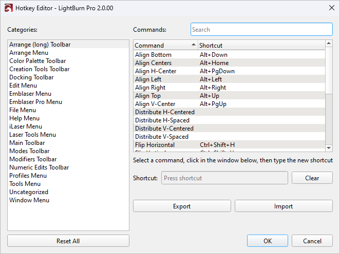

Use the Hotkey Editor to customize LightBurn's hotkeys. From this window, you can add new keyboard shortcuts and edit or delete existing ones. Access the Hotkey Editor by going to File → Preferences → Edit Hotkeys.
Hotkey Editor
You can also download printable hotkey cheatsheets.
Using the Hotkey Editor
To customize hotkeys:
  1. Find the command you want to modify using the categories on the left or the search bar at the top of the window.
  2. Select the command.
  3. Click in the Shortcut text box.
  4. Type the new hotkey, or press Clear to erase the hotkey.
  5. Click OK to save your changes when you're finished.
From this window, you can also use Reset All to return hotkeys to their defaults, or use the Export and Import buttons to back up your custom hotkeys or restore a backup. Custom hotkeys can also be imported and exported as part of a User Bundle.
