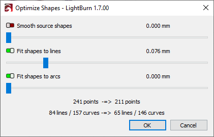

Optimize Shapes Window
Screenshot of the Optimize Shapes window
The Optimize Shapes tool adjusts selected shapes within a specified error tolerance, which defines the maximum amount the new optimized shapes can deviate from the original source shapes.
Error tolerance is controlled by the sliders beneath each optimization option. Switches next to each option control whether they are enabled or disabled.
Optimizations are visible in your Workspace as you make changes — adjust the tolerance sliders or enable and disable options to see the result of different combinations of tolerances and optimizations.
Press OK to confirm changes and Optimize the source shapes, or Cancel to discard the changes and leave the shapes as they are.
Smooth source shapes
Smooth source shapes smooths out wavy or jagged lines. This is often useful for cleaning up vectors from Image Tracing. Increase the value to strengthen the smoothing effect, at the expense of potentially losing small details or rounding off sharp corners.
Fit shapes to lines
Fit shapes to lines simplifies shapes by turning sections that are close to being a line into lines. This can reduce node count or help clean up graphics with many small or overlapping lines.
Fit shapes to arcs
Fit shapes to arcs simplifies shapes by converting lines into arcs. This can reduce node count or recreate true arcs from software that exports them as many small line segments.
Points, Lines, and Curves
At the bottom of the window, LightBurn displays the number of Points (nodes), Lines, and Curves (arcs) in the original shapes and in the optimized versions of the shapes.
