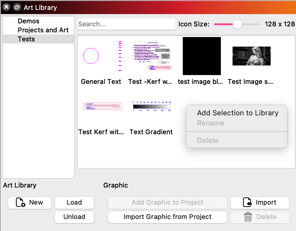

You'll see a list of Art Libraries on the left, and thumbnails of the artwork within the currently selected Library on the right.
Note
If there are no Libraries listed, a New Library must be created, or an existing one Loaded, in order to access artwork.
Creating a Library
To create an empty Library, click the New button, then choose a location and name for the .lbart file — this is where added artwork will later be stored, in compact form.
Loading and Unloading Libraries
To add a previously saved Library, click the Load button in the bottom of the Art Library Window. Saving, transferring, and Loading Libraries makes it possible to share artwork between computers and users.
To remove a Library from the list, click Unload. Unloading a Library removes it from view, but does not delete the file or its contents from the hard drive where it is saved.
Storing Art in a Library
Use the Import button to add artwork from saved files to your Library. You can import multiple files at once using this method, and each will become an individual entry in the current Library.
To add selected objects from your current project, do one of the following:
  • Click Import Graphic from Project in the Art Library window.
  • Right-click in the Art Library Window and choose Add Selection to Library.
  • Right-click in the Workspace and select either Add to Current Art Library or Add to New Art Library from the context menu that pops up. Add to Current Art Library is only available if you've already loaded an Art Library.
Editing Art and Libraries
Right-clicking artwork in an Art Library brings up the options to Delete or Rename it.
To change the name of a Library, change the .lbart file name in your file browser, and then Unload and Reload the Library in LightBurn.
To copy artwork from one Library to another, drag and drop in the Art Library window. To move artwork, hold Shift while dragging the artwork.
