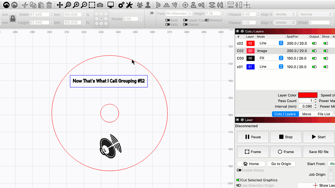

Group selected objects to treat them as a single unit when they are:
You can create Groups out of any objects, including objects assigned to different layers, and multiple types of objects such as lines, shapes, text, and images. You can even combine objects that have already been Grouped into other Groups.
Grouping Demo

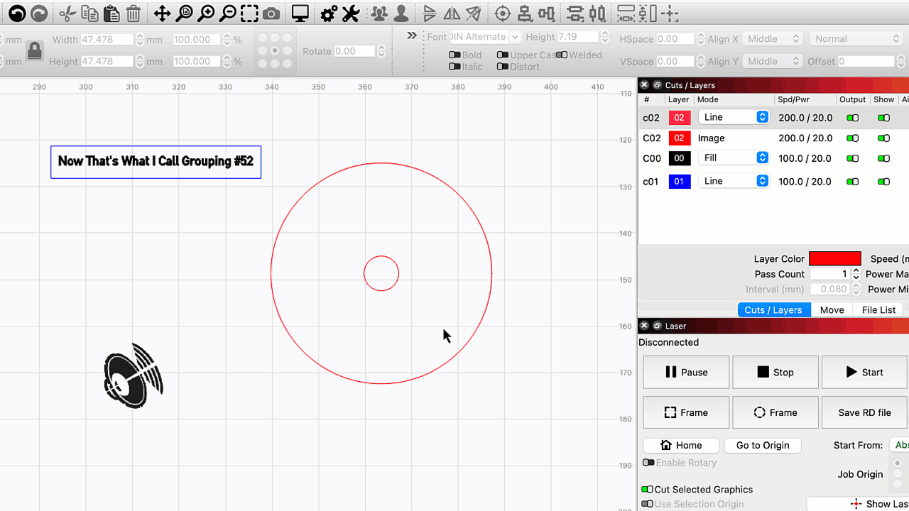

Ungroup
Ctrl/Cmd + U
Ungroup selected (previously Grouped) objects to treat them as discrete, independently adjustable units again.
If you have a Group made up of other Groups, you'll need to Ungroup multiple times to separate all objects into individual units again.
Ungrouping Demo

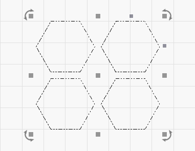

Selection Appearance of Grouped Objects
You can tell whether an object is Grouped based on its appearance when you select it.
Ungrouped objects are drawn with an animated dash pattern instead of solid lines, while Grouped objects are drawn with a dot-dot-dash pattern.
Ungrouped Objects Selected
Grouped Objects Selected

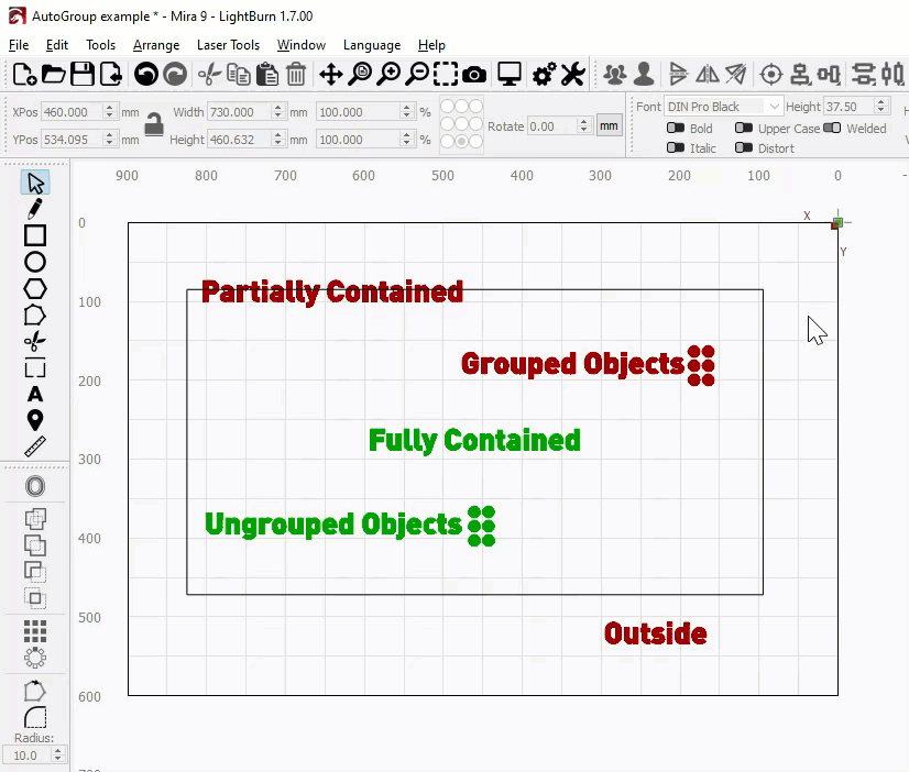

Auto-Grouping
Auto-Group identifies shapes that are fully contained within another shape and Groups them together with the outer shape.
In the animation above, the objects shown in red are unaffected by Auto-Group, either because they're not fully contained within the rectangle or because they are already Grouped. The green objects are automatically Grouped with the rectangle.
To use Auto-Group:
  1. Select the shapes you want to use Auto-Group on.
  2. Make sure the shapes are not Grouped using Arrange → Ungroup or Ctrl+U.
  3. Use Arrange → Auto-Group to automatically group all fully contained shapes inside the outermost shape.

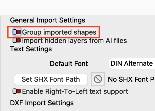

Imported shapes are Grouped by default. Disable Group imported shapes in your Settings to turn off automatic Grouping upon importation. Group imported shapes disabled
