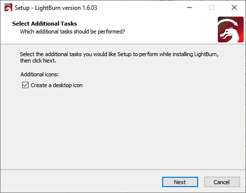

Installation works the same way as most Windows software. Start the installer by double-clicking the file you downloaded from the LightBurn website. Windows may ask if you trust us first.
Click Next, then click Install to begin the installation process. When it completes, you'll see the following screen with options for installing drivers, viewing the change log, and launching LightBurn.
Installing Drivers
If you have never installed LightBurn on this computer before, you might need to install drivers. This is not necessary when updating an existing installation.
  • Check Install FTDI Driver to install the driver used by DSP controllers, like Ruida and TopWisdom.
  • The EZCAD2 / EZCAD3 driver is used by supported Galvo devices using EZCAD2 and EZCAD3 boards. Read more on our Galvo Driver Installation page.
Installing the driver for BSL Galvo Lasers
If you have a BSL Galvo laser, you may need to separately install a driver supplied by your machine's manufacturer, or install the stock software that came with your machine.
Start LightBurn however you usually do to begin using the software.

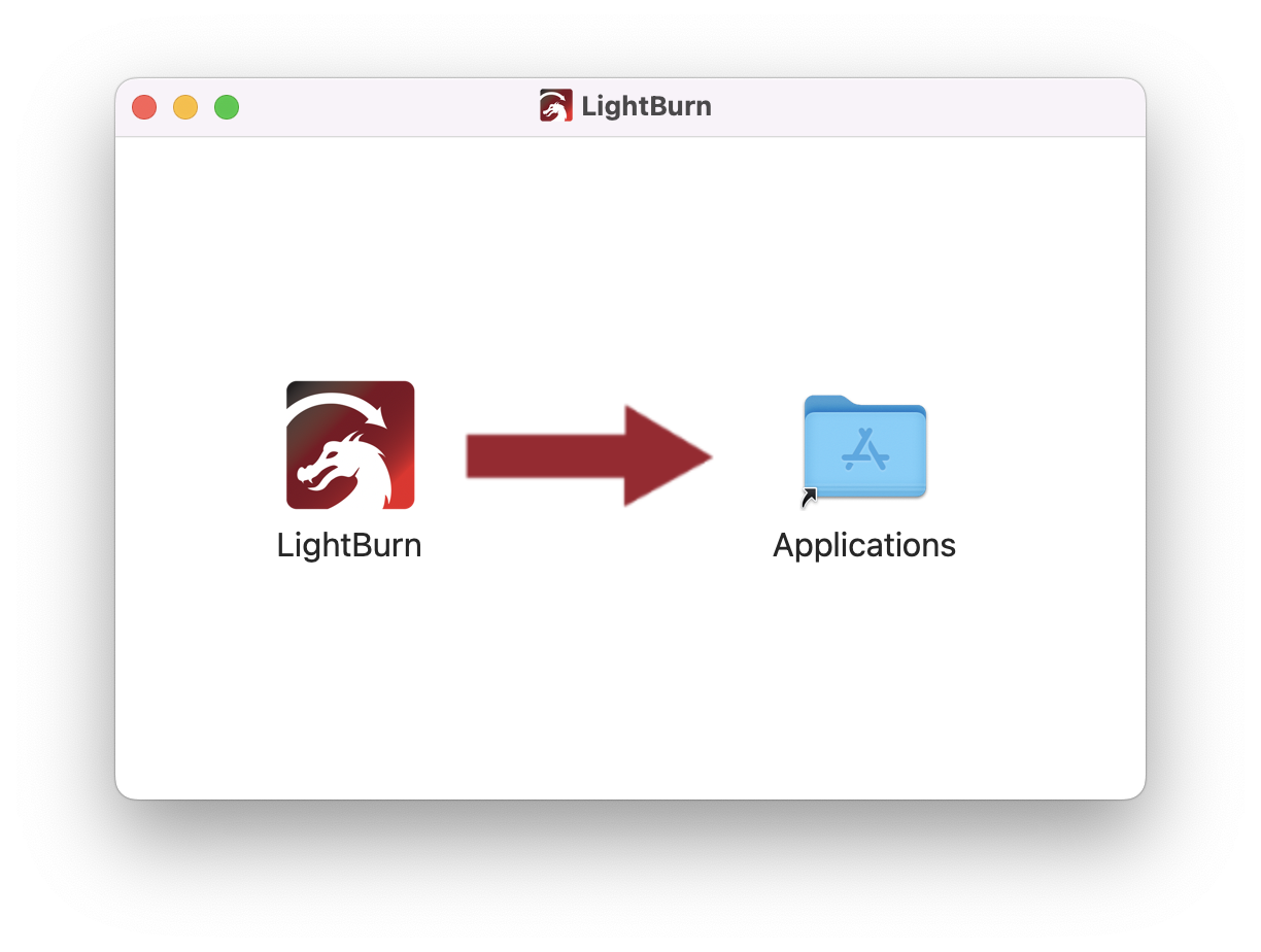

To install LightBurn on an ARM-based Mac (using an M1 chip or later), you must have Rosetta installed.
In most cases, Rosetta is automatically installed on ARM-based Macs, and manual installation is unnecessary. If Rosetta is not installed, you'll be prompted to install it when you attempt to open LightBurn.
Installation works the same way as most macOS software. After downloading the DMG file, open the file and drag LightBurn into your Applications folder.

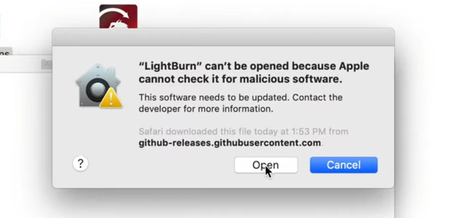

Notarization bypass for LightBurn 1.1 and earlier
Versions before 1.2 were not notarized to be recognized by your computer as coming from a trusted developer. If you installed an older version, you'll need to follow the steps below the first time you run LightBurn:
  1. Open a Finder window.
  2. Browse to the Applications folder.
  3. Right-click or two-finger tap the LightBurn icon.
  4. Choose Open from the menu.
  5. When macOS asks if it should open the program, say yes to add an exception allowing your computer to run LightBurn normally. Once this is done, you will not need to repeat the process unless you reinstall LightBurn.
