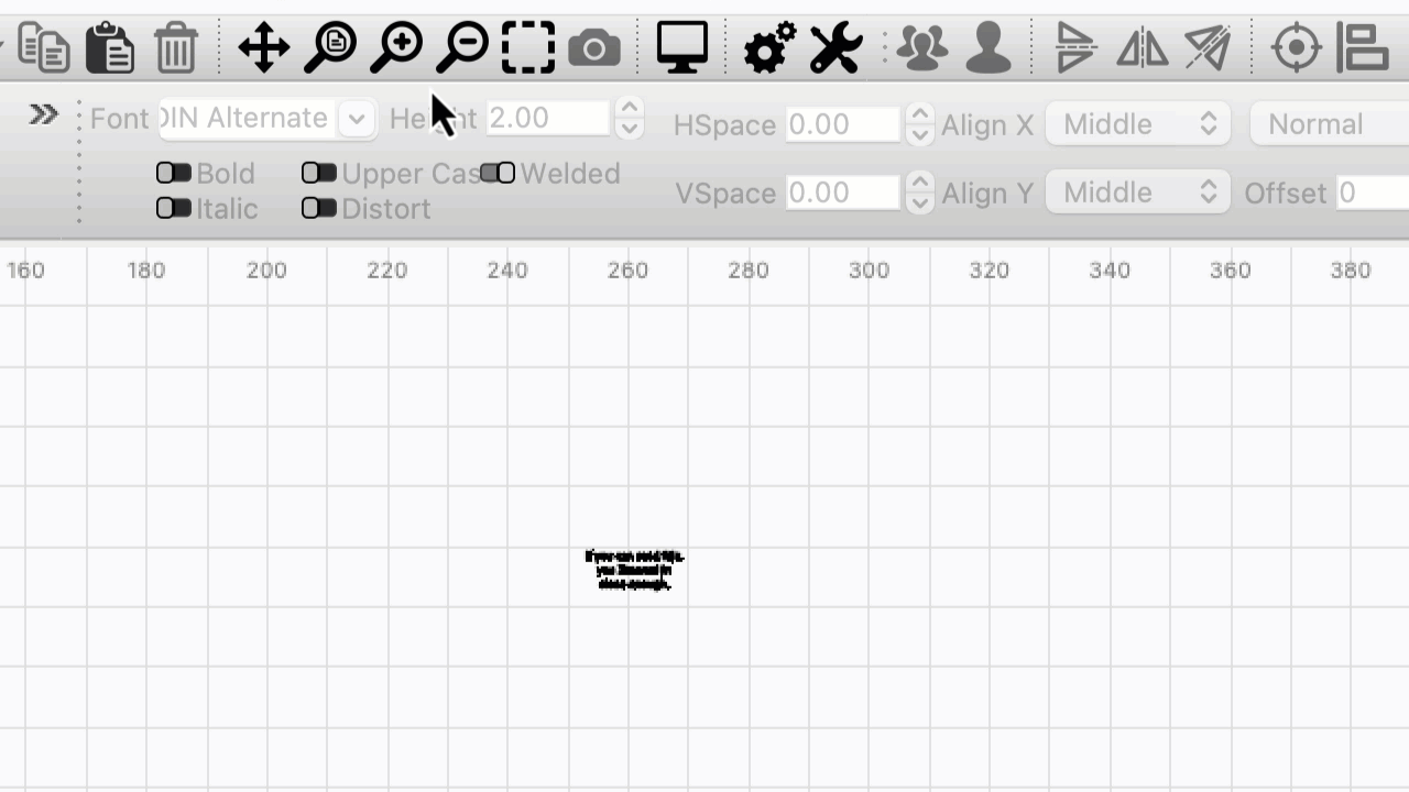

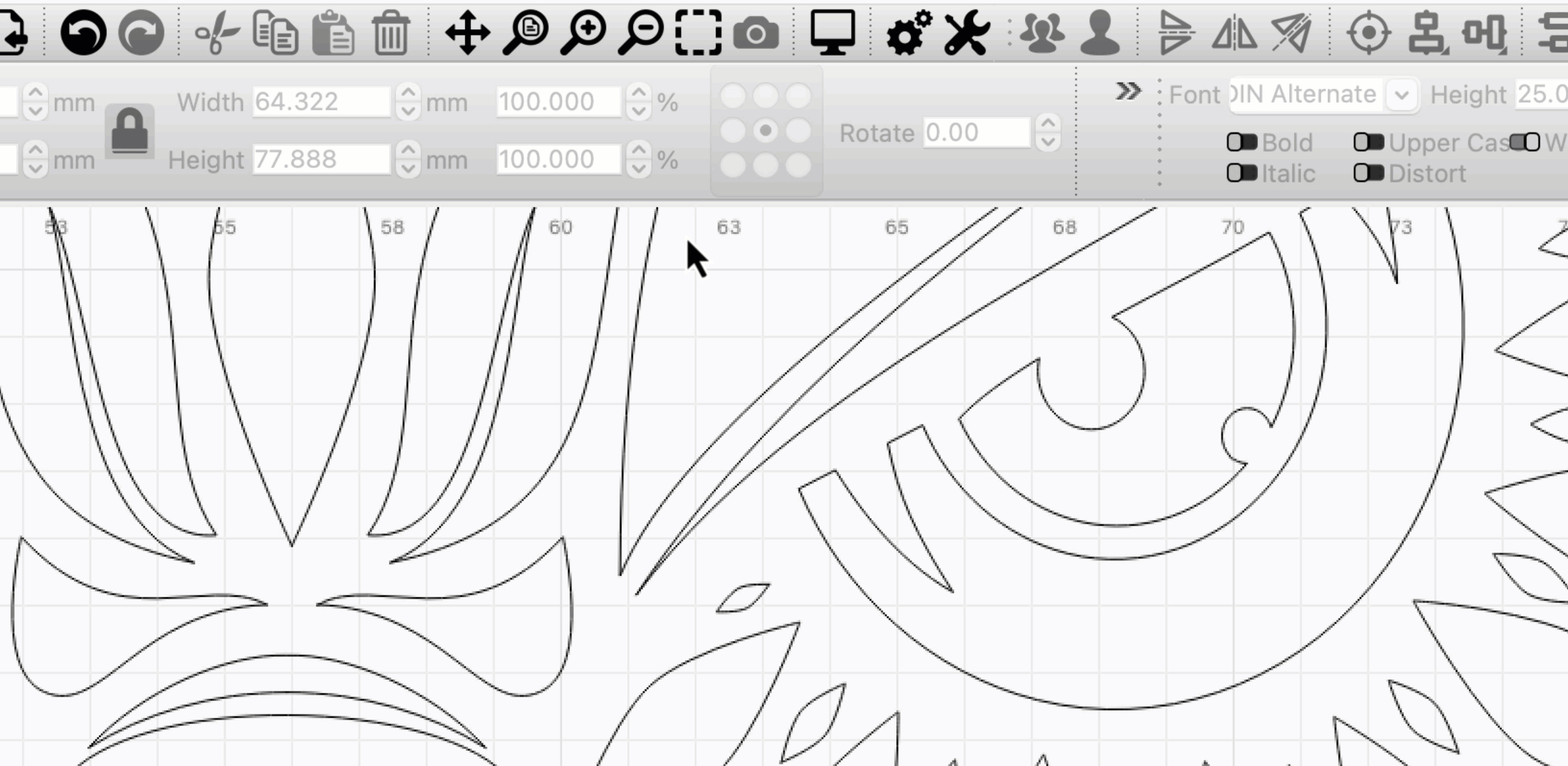

Zooming
Zoom In and Out
The most common method to quickly navigate a design is by zooming with the scroll wheel on a mouse, followed by two-finger dragging if you're using a trackpad. By default, rolling it backwards will Zoom Out, and rolling it forward will Zoom In, toward whatever your cursor is pointing.
These directions can be swapped by going to File → Settings and toggling on Invert Mouse Wheel Zoom Direction.
However, there are many ways to Zoom In and Out:
Method Zoom In Zoom Out
Roll the scroll wheel on a mouse Forward Backward
Slide two fingers on most touchpads Backward Forward
Window Menu Zoom In Zoom Out
Keyboard shortcuts (Edit Window in focus) + -
Keyboard shortcuts (Edit Window not in focus) Ctrl / Cmd++ Ctrl / Cmd+-
Main Toolbar In Out

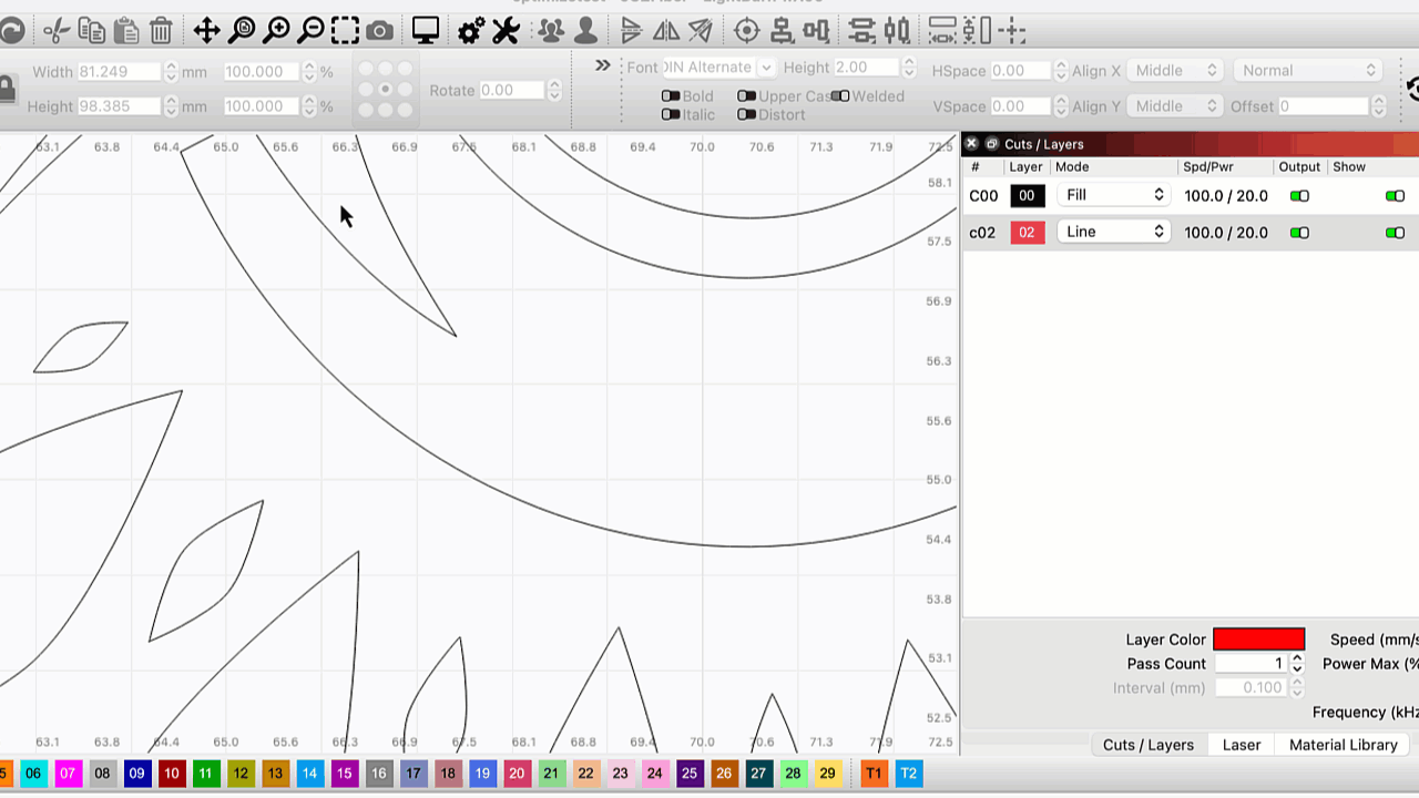

Zoom to Page
To Zoom your field of view to show the entire Workspace, go to Window → Zoom to Page, press Ctrl / Cmd+0, or click the Zoom to Page button In in the Main Toolbar.
Zoom to Page Demo

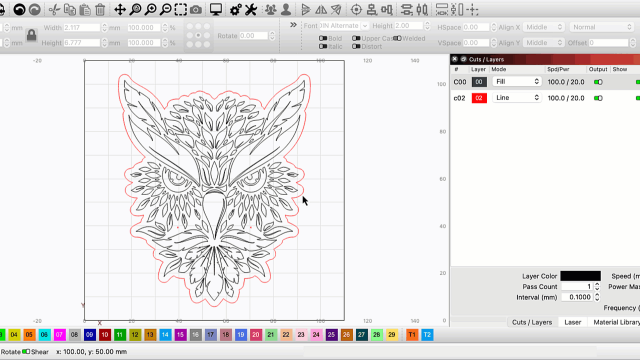

Frame Selection
To Zoom your field of view to frame your current selection, go to Window → Frame Selection, press Ctrl / Cmd+Shift+A, or click the Frame Selection button In in the Main Toolbar.
Zoom to Frame Selection Demo
