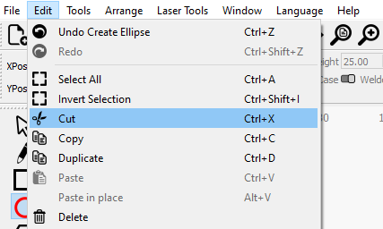

Cut, Copy, Paste, Duplicate, Delete in the Edit Menu

Copy
Ctrl/Cmd+C
Saves a copy of selected objects to your clipboard.
Cut
Ctrl/Cmd+X
Deletes selected objects in your Workspace while saving a copy of them to your clipboard at the same time.
Duplicate
Ctrl/Cmd+D
Creates copies of selected objects, directly on top of the existing objects.
Paste
Ctrl/Cmd+V
Inserts objects copied to your clipboard into your Workspace. Pasted objects are centered at the location of your cursor at the time of pasting.
