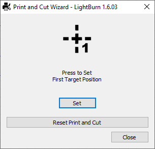

  3. In your LightBurn Workspace, select the first crosshair mark.
  4. Using the buttons in the Move Window or on your controller's keypad (if applicable), jog your laser over the first Target Position in the existing output in your laser's work area.
  5. Use the laser Fire button in the Move Window or the Pulse button on your laser's controller (if applicable) to align the laser's beam to the center of the Target Position. If your laser has a red dot pointer, position it over the center of the Target Position instead of firing or pulsing the laser.
    Warning
    Make sure you are wearing properly rated safety glasses before firing or pulsing your laser. Consult your laser's manufacturer to make sure your safety glasses are properly rated for your laser.
  6. After aligning the laser to the Target Position, click Set to set the laser's current location as the first Target Position. If you are not using the Print and Cut Wizard, select Set First Target Position from the Print and Cut submenu, or press Alt/Option+1.
    Print and Cut Wizard — setting first target position

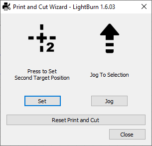

  8. Select the second crosshair mark in your LightBurn Workspace.
  9. Jog your laser over the second Target Position in the existing output. The Jog button beneath Jog To Selection in the Print and Cut Wizard will automatically jog your laser to the predicted location of the second Target Position. Use the Move Window or controller's keypad to correct or fine-tune alignment if the predicted location is imprecise.
  10. After verifying alignment, click Set to set the laser's current position as the second Target Position. If you are not using the Print and Cut Wizard, select Set Second Target Position from the Print and Cut submenu, or press Alt/Option+2.
    Second Target Position - jogging and setting

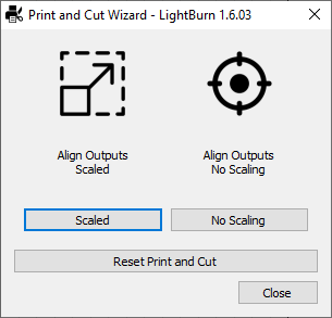

  12. Select Scaled (Alt/Option+3) or No Scaling (Alt/Option+4) to align the current project in your LightBurn Workspace to the Target Positions in your laser's work area. In the Print and Cut submenu, these options appear as Align Output to Targets and Align Output to Targets (no scaling).
    • The Scaled option resizes your project to account for any discrepancy between the size of your project in LightBurn and the size of the pre-existing output in your laser's work area, based on the distance between the Target Positions.
    • The No Scaling option aligns the project but does not resize it according to the distance beteween the Target Positions.
  13. The wizard will close when you select one of the above options. You can select an alternative option by re-opening the wizard, selecting it from the Print and Cut submenu, or by using the appropriate hotkey.
    Choose Reset Print and Cut to remove the current alignment and start the process over.

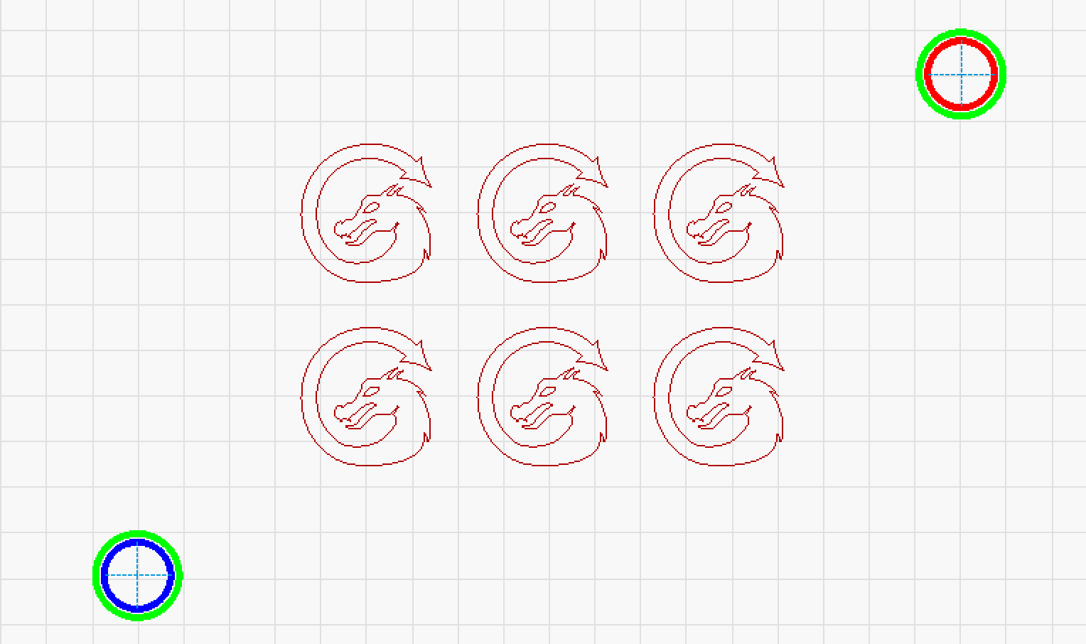

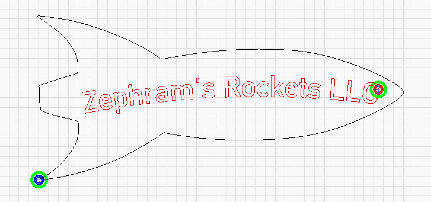

  14. The Enabled Mode(s): Print and Cut indicator will appear at the bottom right corner of your screen:
    Print and Cut Enabled indicator
    And green outlines will appear around both crosshair marks:
    Print and Cut Enabled green circles

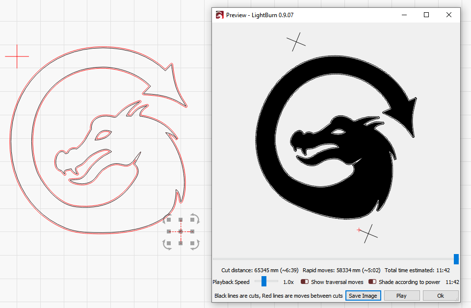

  15. After verifying that your project will output correctly by Framing and viewing it in the Preview window, Start the job.
    Expected appearance of Print and Cut Preview
    You should expect to see your project rotate in the Preview window, if the location of the Target Positions you've set indicates that a change in orientation is required. Print and Cut rotated Preview

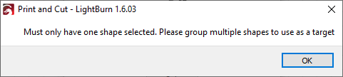

Multiple Shapes Selected
Must have only one shape selected. Please group multiple shapes to use as a target
You may not use multiple shapes as a registration mark, unless they are Grouped. If you are using a crosshair mark as your Target Position graphics, you must Group the lines before setting the positions.

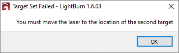

Must Move the Laser
You must move the laser to the location of the second target
The laser has reported no movement from the position it was in when you set the first Target Position.
Make sure the laser is still connected and reporting its position. If the laser has disconnected, you must re-home and start the process over.
Make sure you are moving the laser using the jog buttons in the Move Window or on its controller's keypad (if applicable), and not by hand.

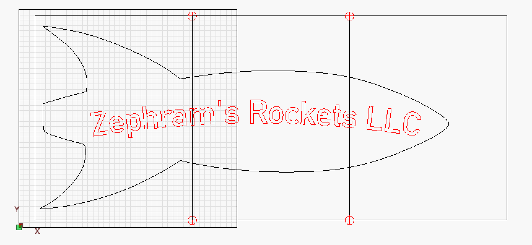

Cutting a Project Larger Than Your Laser's Workspace
In order to cut a project larger than your laser's work area, divide it into sections using Cut Shapes, and add crosshair marks to each section, to use as Target Positions to align the subsequent section to.
Be sure to divide the sections and position the crosshair marks such that each section and the crosshairs from the previous section can fit in your laser's work area.
After a set of crosshairs of each section have been engraved, set them to a Tool layer, so they are not output to your laser again — be sure not to delete or move them, you'll still need them for alignment. Set the rest of the graphics in each completed section to a Tool layer as well, or delete them.
Larger than workspace Print and Cut Example
