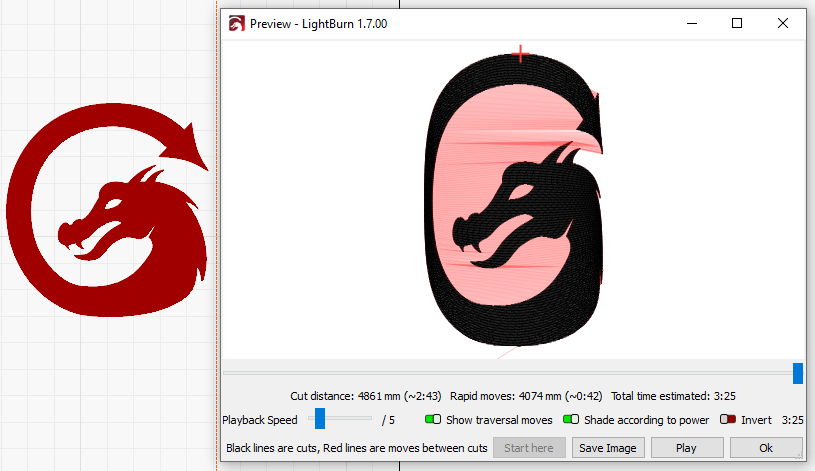

Cylinder Correction warps the output of your design to correct for distortion caused by engraving cylindrical objects, without using a rotary. This tool is currently only available for Galvo lasers. EZCAD users may be familiar with this tool by the name ProjectMark.
Screenshot of results

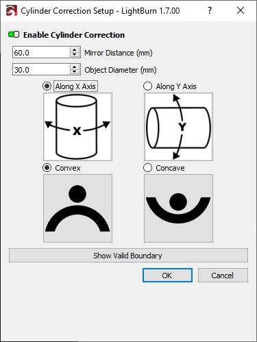

Using Cylinder Correction
Open the Cylinder Correction Setup window by going to Laser Tools → Cylinder Correction Setup, or clicking the Cylinder Correction button in the Modes Toolbar.
Make sure Enable Cylinder Correction is turned on.
Tip
If Show cylinder correction enable in main window is enabled in your Settings/Preferences, you can also enable or disable Cylinder Correction Mode using the switch in the Laser Window.
Rotary Enable Switch
Cylinder Correction Setup screenshot
From the setup window, you'll adjust the Mirror Distance, Object Diameter, axis to curve around, and direction of the curve.

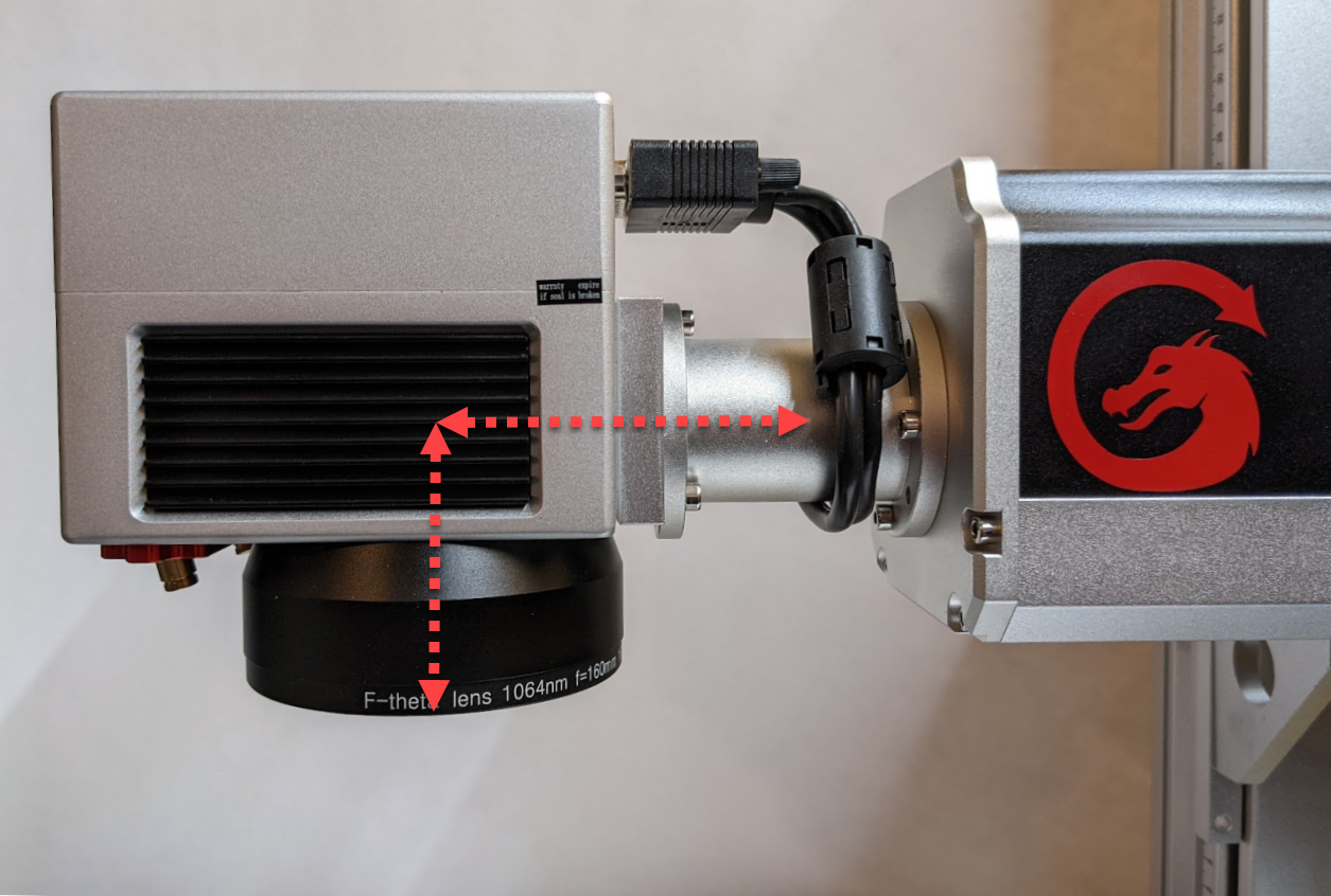

Mirror Distance
Warning
This is not the focus distance between the object and the lens, but the distance to the galvo mirrors themselves. Keep reading for help measuring this.
To use Cylinder Correction, you'll need to identify where your mirrors are. The mirrors are typically centered along a tube connecting the galvo head to the laser source. In the image below, a horizontal line marks the center of this tube.
Galvo mirror location example
Measure the vertical distance from this line to the bottom of the lens — shown with a vertical line in the image above — and add this to your focus distance to find the mirror distance. We recommend saving this measurement so you don't have to keep re-measuring.
Object Diameter
Measure the diameter of the object and enter it into this box.
X or Y Axis
Select whether the object curves along the X (horizontal) axis or Y (vertical) axis. Only one of the two can be selected. The images below the options show a simplified representation of what each option would look like.
Convex or Concave
Select whether the object is Convex — curving outwards to make up the outer surface of a cylinder — or Concave — curving inwards to make up the inner surface of a cylinder. As with the X and Y Axis, the images show a simplified representation of Convex and Concave curves.

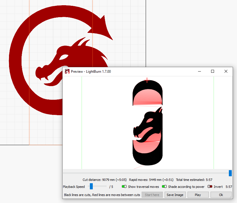

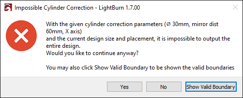

Show Valid Boundary
There are limits to where on a given object your laser can actually reach. The Show Valid Boundary button will insert a rectangle on the T1 Tool layer into your design to show the area that can be engraved.
Cylinder Correction Impossible Boundaries screenshot
If you try to Preview or run a cylinder-corrected engraving while a portion of your design is outside of the valid area, LightBurn will pop up a warning asking you whether you'd like to continue anyway, show the valid boundary, or cancel. If you engrave anyway, LightBurn will automatically cut off the portions of the design outside the valid boundary area, as shown below.

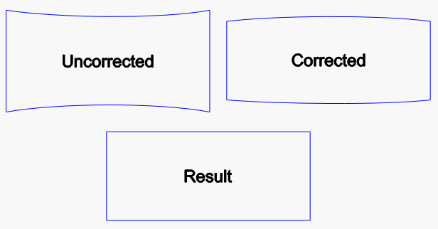

How It Works
Galvo lasers project the laser from a single point above your object. When marking a cylindrical object, the increased travel distance for the laser as the surface of the object curves away causes the shape to widen and bend, similarly to the uncorrected rectangle in the diagram below.
Cylinder Correction alters the output to warp your design in the opposite direction, negating the warping caused by the curve of the object. If your measurements are correct, this produces clean, undistorted output like the result shown in the diagram above.

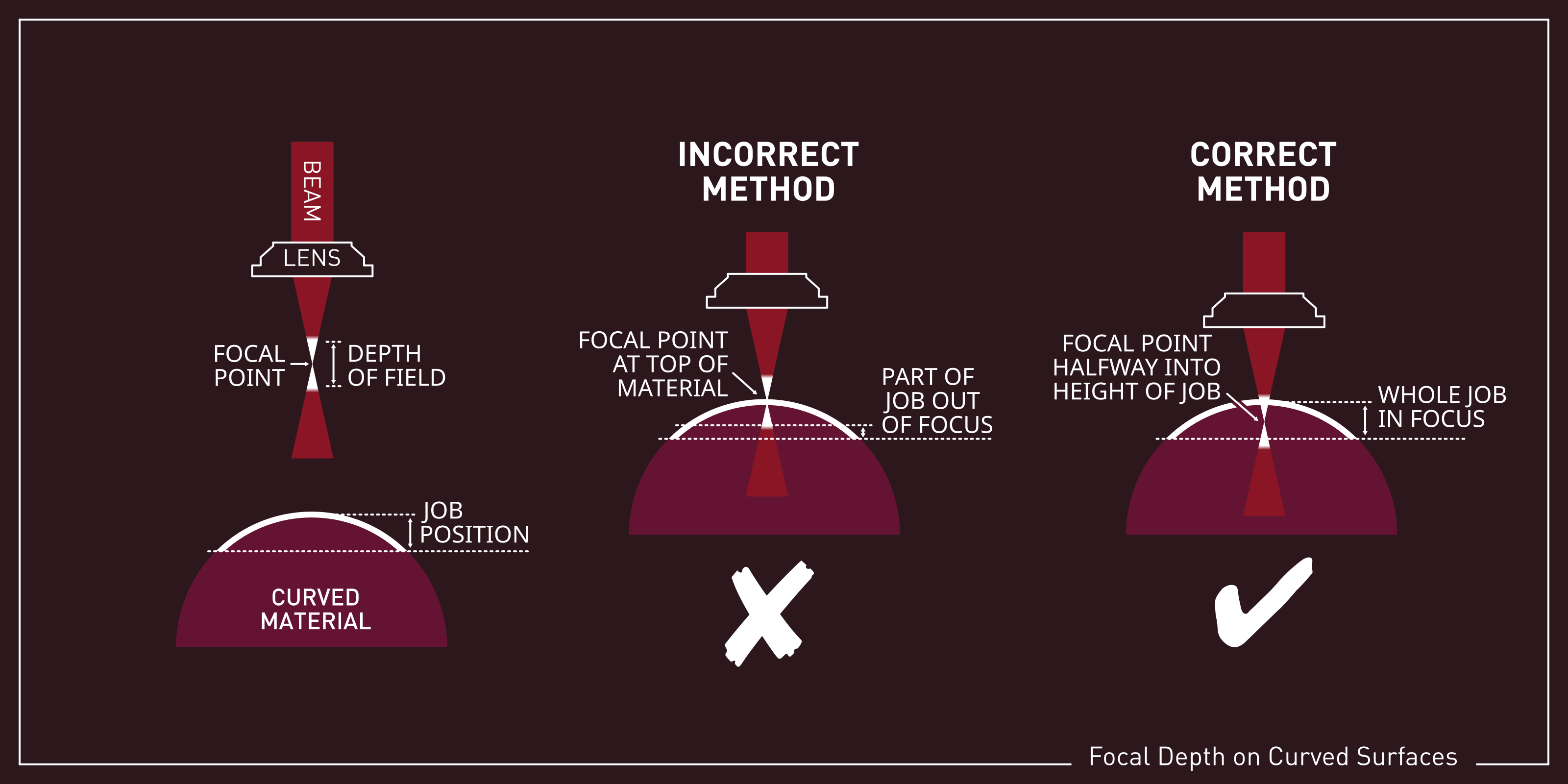

Lens Selection
When using Cylinder Correction, you'll be marking across a larger range of focal distances than is typical when marking flat surfaces. For instance, if you have a 75 mm diameter tumbler and are engraving a 50 mm wide graphic, there will be about 10 mm difference in focal distance across your design.
For best results, use a lens with a larger field (working area) if possible. Wider field lenses have a lower power density but a longer focal range. To take advantage of the full focal range, focus your lens below the upper surface of the cylinder, as shown in the diagram below.

  • If the outer parts of your design are missing, make sure that it's fully within the valid boundaries.
