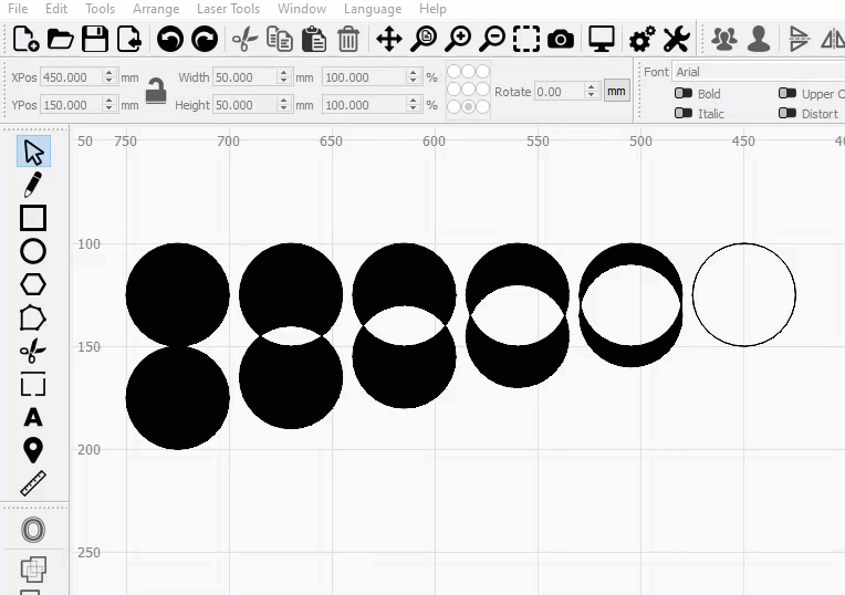

Preview
The Preview window simulates movements and lasering operations before sending a project to the machine. Because it can be difficult even for experienced users to keep track of which layers are set to which mode, and whether all of their cut settings are in order, we strongly recommend previewing every project, before sending it to your laser.
If what you see here doesn't align with your expectations, you've got some editing to do. Make sure all of your shapes are set to the correct layers, and those layers are set to the correct modes. If you're working with layers set to Fill Mode, make sure they're overlapping only as you intend.

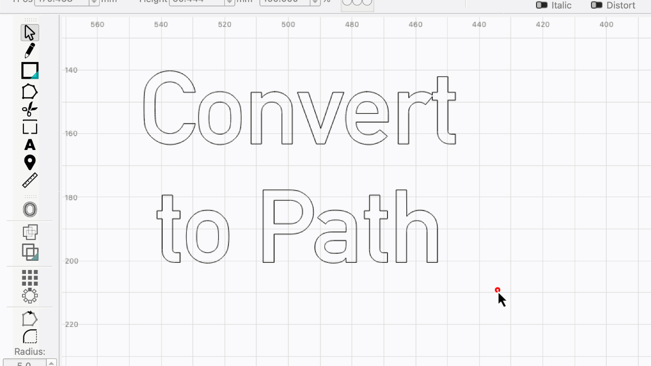

Convert to Path
Convert to Path transforms built-in shapes created in LightBurn into paths made up of lines, curves, and nodes. These paths can be edited using the Edit Nodes tool.
The following built-in shapes must be converted to paths in order to edit their lines, curves, and nodes:

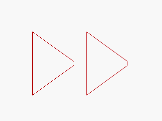

Close Path connects individual shapes with one start and one end point by creating a new line between the points.

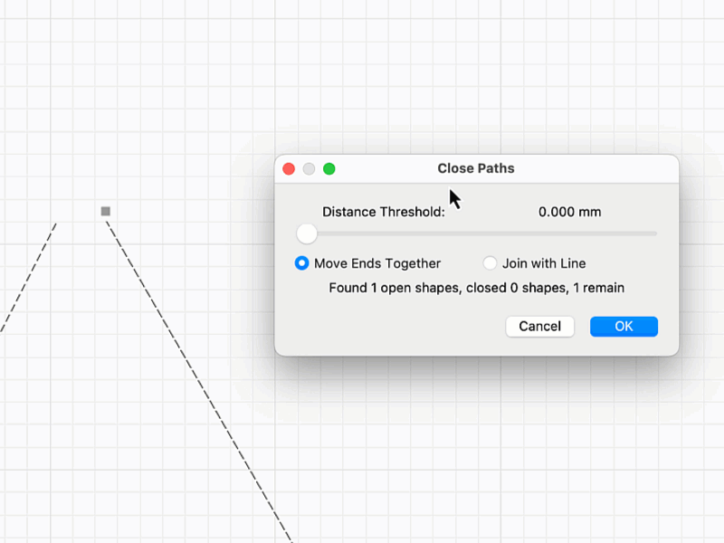

Close selected paths with tolerance works similarly to Close Path to close shapes with start and end points that are not the same, while providing greater control over how far apart they must be in order to connect them, and how they will be connected.

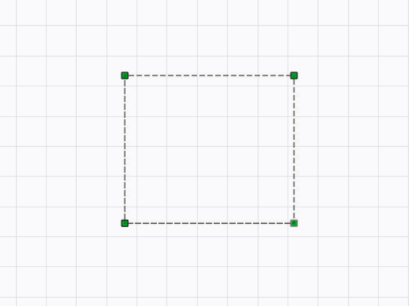

Auto-join selected shapes connects line or curve segments whose start and end nodes are directly on top of (or very near to) one another, but not technically connected. When the segments are connected, they are combined into a single path (a sequence of lines, curves, and nodes).
Auto-Join is most often helpful in cases where you've Imported graphics containing open shapes that you would like to use with a function that requires closed shapes.
To connect start and end nodes using Auto-Join, the nodes must be within .05 mm of one another.

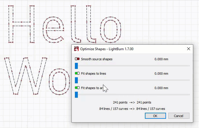

Optimize Selected Shapes
The Optimize Shapes tool simplifies and smooths selected shapes by reducing the node-count or by fitting them to arcs or lines. This is often useful when importing art created in other software, or cleaning up traced artwork.
