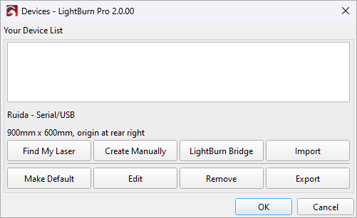

The first time you open LightBurn, you'll be greeted by the Devices window, where you'll see an empty list, along with several options for creating a device profile at the bottom. You need to have at least one device profile created in order to use LightBurn, so if you close out of this window without creating one, you'll see a warning message with the option to go back and set up a device, have LightBurn automatically create a dummy profile for you, or close out of the software.

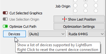

  2. Click on the Devices button in the Laser Window, found in the lower right-hand corner of the program window by default, to open the Devices window.
    Note
    If this is your first time running LightBurn, the Devices window will open automatically.
    Devices
  3. Click the Find My Laser button to launch the Device Discovery Wizard.

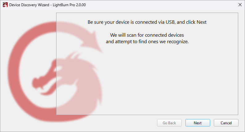

  4. Click the Next button to begin scanning for connected devices.
    FindMyLaser

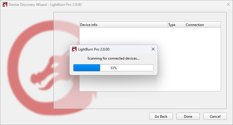

  5. A new window will open showing the progress of scanning for USB-connected devices.

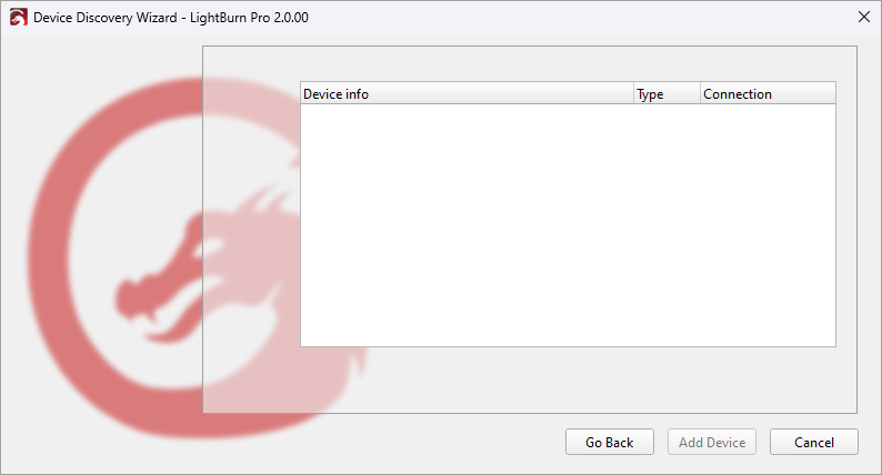

  6. The Device Discovery Wizard will display a list of recognized devices. Select your laser from the list and click Add Device.
    Ruida: Packet vs. Serial
    Some laser models will appear on the list twice, with two connection types, Packet/USB or Serial/USB. Serial/USB is the recommended option, while Packet/USB is an alternative option that does not work on all systems, but can sometimes improve file transfer problems.
    FindMyLaser
    Warning
    If your laser wasn't found automatically, see Troubleshooting.

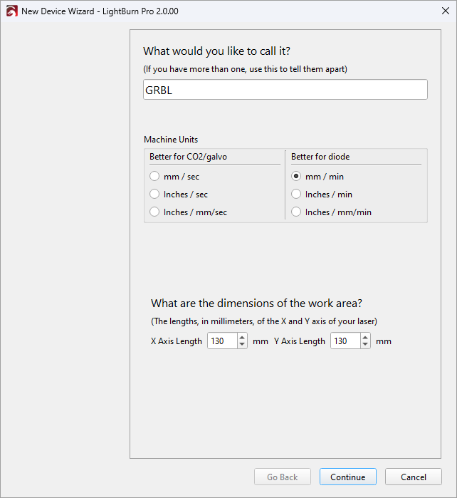

  7. Name your device, choose the units you want to use for this device, and confirm that the dimensions of the work area are correct.
    FindMyLaser
    Note
    Some lasers require additional information in order to complete the setup process. Continue below.

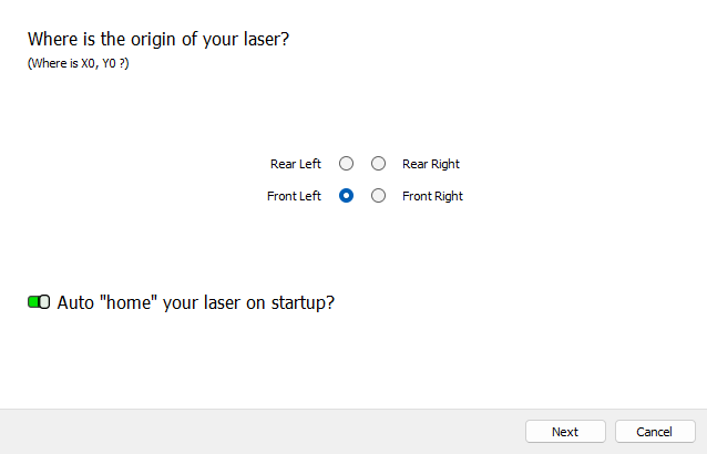

  1. Set the machine origin. Nearly all GCode systems use the Front Left corner as the origin, regardless of where they home to. If you select the incorrect origin, your output will be flipped or mirrored — you can correct the origin later in Device Settings.
  2. Enable Auto "home" your laser on startup if your machine has homing or limit switches, to automatically send your laser a homing command each time the device has been connected.
    Warning
    If your laser does not have homing switches, leave Auto-home off.
    If you see Error: 9 in the Console Window later, it means you've enabled this feature but your machine is not equipped or configured for homing. You can disable Auto-Home later in Device Settings.
  3. Select Next to continue.
    FindMyLaser
