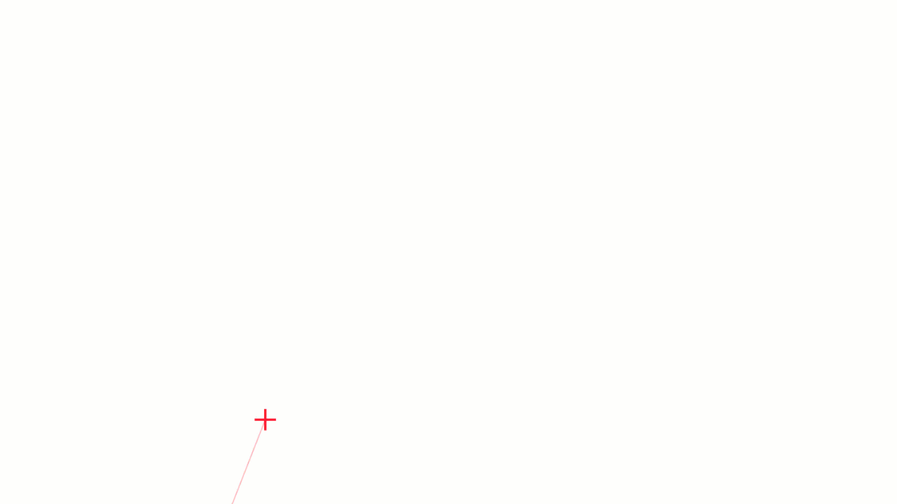

The extra Overscanning movements are indicated in red. Enable Show traversal moves in the Preview window to see these movements.

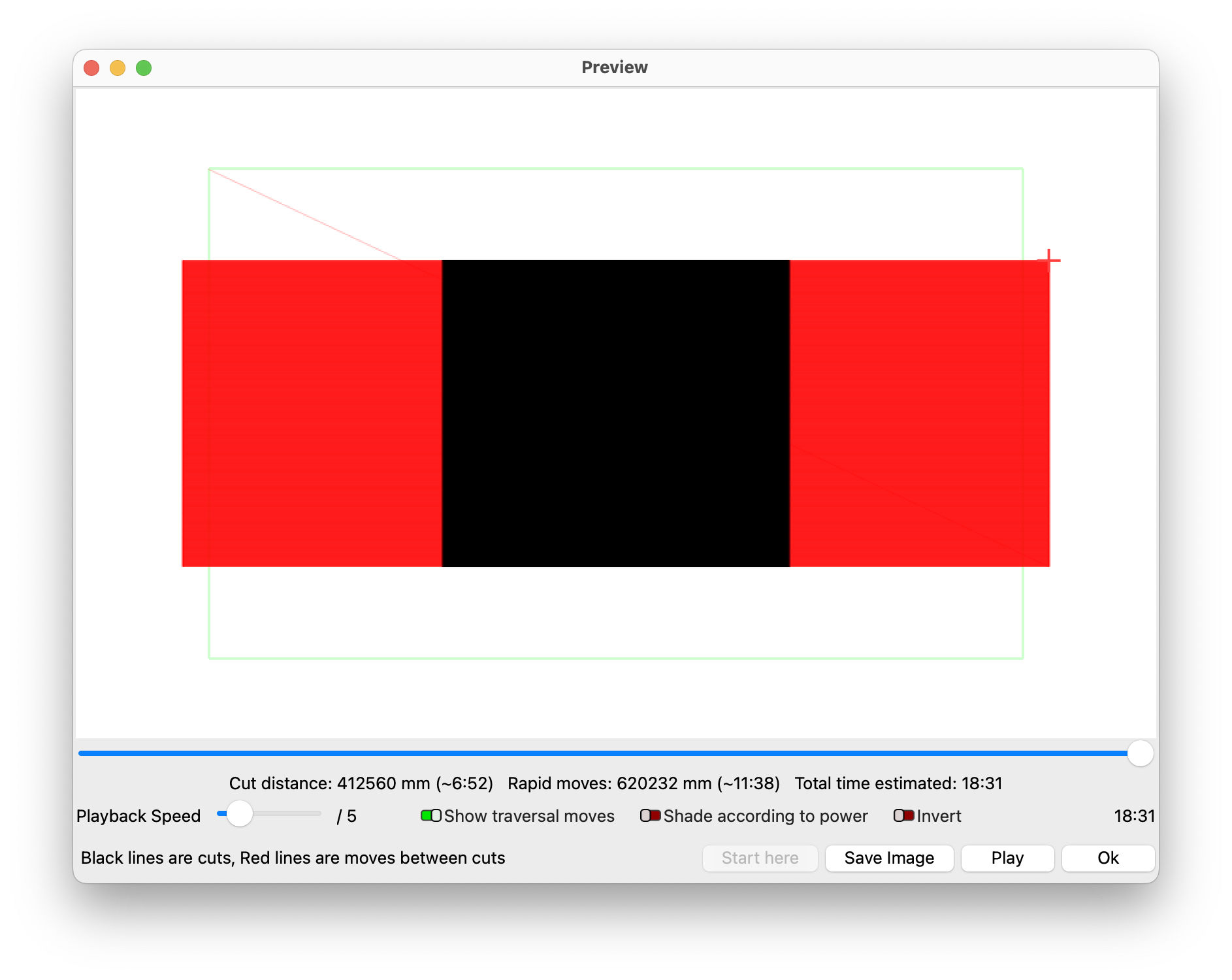

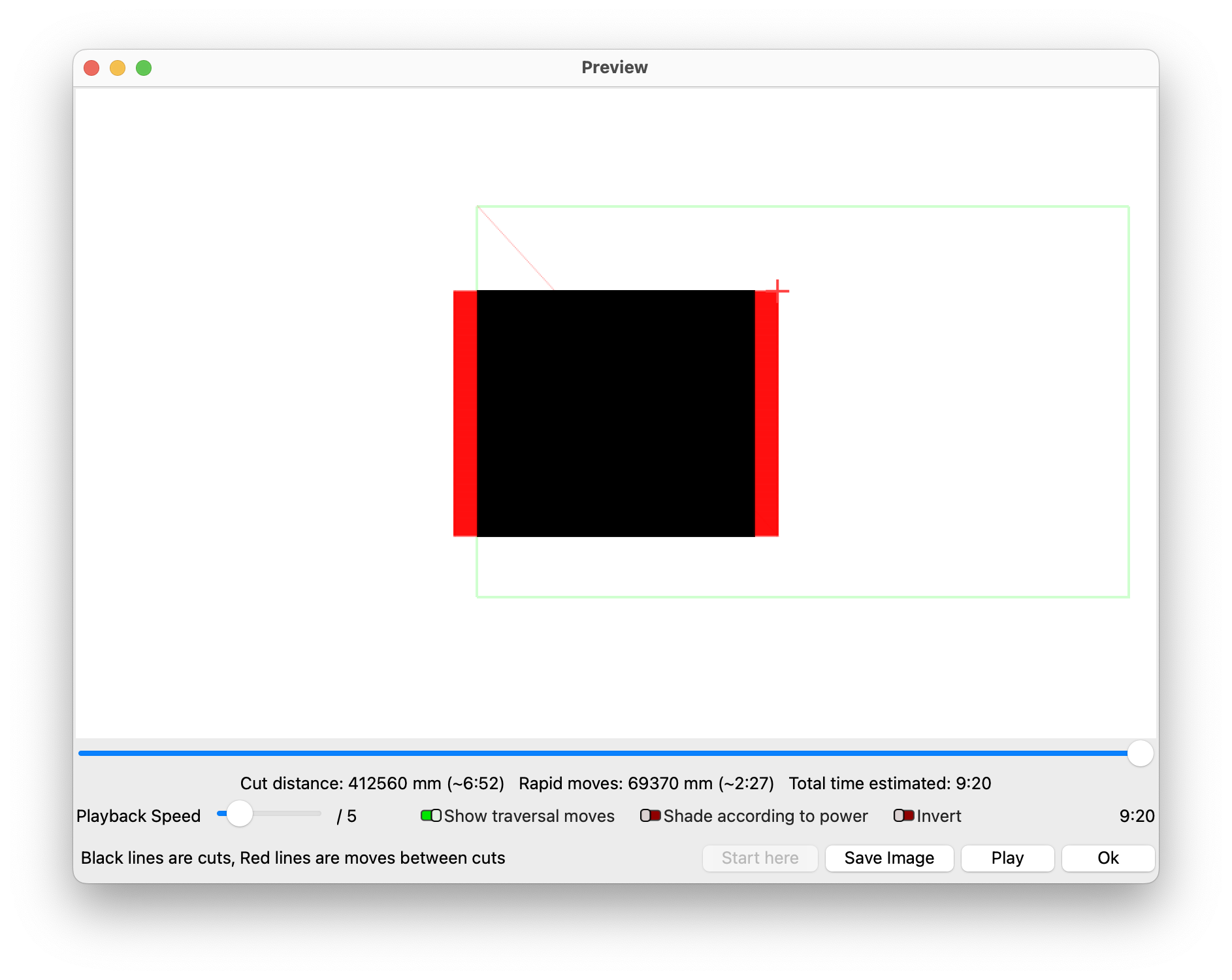

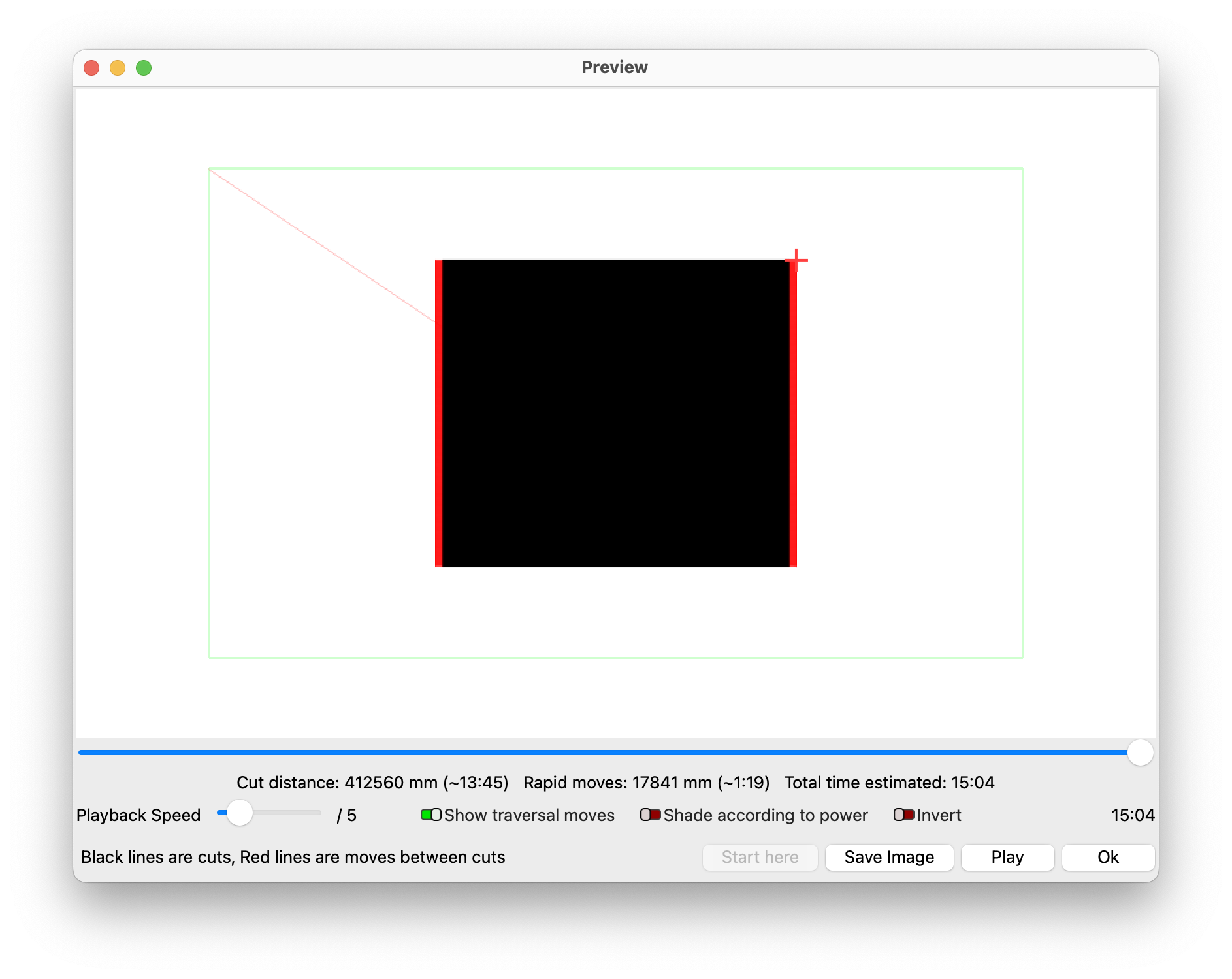

Speed, Overscanning Distance, and Job Time
Although you can't control the percentage through LightBurn, Overscanning distance varies based on Speed for DSP lasers as well, and in the same way — as you increase engraving Speed, Overscanning distance increases as well.
This is, again, due to the physical limits of your laser — while every laser is different, there is a limit to how quickly any laser can slow down or speed up.
No matter what that limit is, it will always require more space and time to slow down from or speed up to a relatively high speed than a relatively low one.
Imagine driving a car and quickly pressing the brakes to bring it to a halt. The car will require a longer distance to stop if you are traveling at 60 miles per hour than if you are only traveling at 10 miles per hour. It will also take more time to halt the faster-traveling car than the slower-traveling one.
Because high Speed settings require more distance and time for acceleration and deceleration, increasing the Speed you set your laser to engrave at will yield diminishing returns in time savings the higher you go, and, in some cases, increasing past a certain point can actually lead to an increase in job time, rather than a reduction.

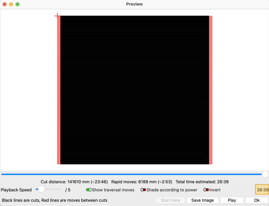

You can use the Preview window to check the your project's estimated run time, and see the effect of a range of Speeds on overall time.
Medium speed job time
Set to 100 mm/second (6000 mm/minute), this graphic will take 26:39 to engrave.
High speed job time
The same graphic, now set to engrave at 400 mm/second (24,000 mm/minute), will take nearly 3 minutes longer to engrave, due to the high amount of Overscanning required.
