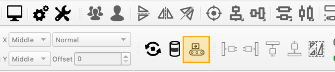

To configure your external axis' motion parameters and enable the Split Marking tool, click the conveyor icon in the Modes Toolbar.
External Axis Setup
Before you use Split Marking for the first time, you must configure the settings for the Rotating or Linear axis table connected to your laser.
Click the Conveyor icon in the Modes Toolbar to open the Split Marking Setup window.
The Split Marking conveyor icon in the Modes Toolbar

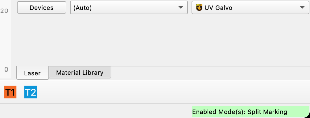

Enable Split Marking
This switch controls whether Split Marking Mode is enabled. When enabled, you'll see a status indication in the bottom right corner of your screen:
Rotary Mode Enabled

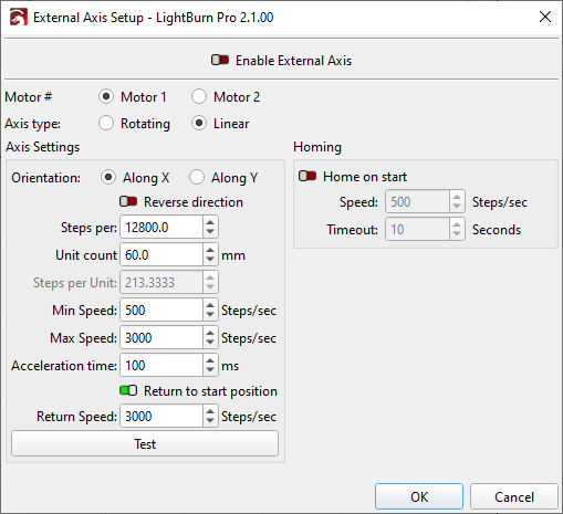

Motor #
If your laser has two motor outputs, select which is connected to your Rotating or Linear table.
Axis Type
Select whether your device is a Rotating table that can make continuous, complete revolutions, or a Linear table that moves back and forth along an axis.
Axis Settings
Orientation
If your Axis Type is set to Linear, select whether it is orientated along your work area's X or Y Axis.
Reverse Direction
Enable Reverse Direction to tell your device to travel in the opposite direction it travels by default, without changing its orientation or rewiring it.
Steps Per
This value is the number of pulses required for the stepper motor to make one complete revolution.
Your table's manufacturer should provide you with the correct value for your device, or you can access its stepper driver and read or adjust the value there.
Unit Count
The amount of movement of the table that results from one complete rotation of the stepper motor.
  • For Rotating tables the unit of movement is Rotations.
    • For direct-driven tables, this value should be set to 1.
    • For belt-driven tables, the value may vary based on gear ratio.
  • For Linear tables the unit of movement is mm.
    • This value should be set to match the amount of linear movement of your table that results from one complete revolution of its stepper motor.
Your table's manufacturer should be able to provide you with the correct value for your device — if you're unsure consult the documentation for your device, or contact the manufacturer.
Steps Per Unit
This value is automatically calculated by dividing your Steps per value by your Unit Count.
The calculated value equals the number of steps required to move your table in a single increment of your Unit:
  • 1 complete rotation for Rotating tables
  • 1 mm for Linear tables
Min Speed
The minimum speed at which in the table will travel, in Steps/second.
Max Speed
The maximum speed at which in the table will travel, in Steps/second.
Acceleration Time
Time to accelerate the table to full speed, in milliseconds. Lower values mean the table will accelerate faster.
Return to Start Position
Enable Return to starting point to have the table return to its starting point after the job is complete.
Return Speed
The speed at which the table will return to its starting position, in Steps/second.
Test
For Rotating tables, when the Test button is pressed, and both Steps per and Unit Count are correct, the table will rotate a full 360 degrees, pause, then rotate back to the starting point.
For Linear tables, when the Test button is pressed, and both Steps per and Unit Count are correct, the table will move 50 mm, then back to its starting point.
Homing
Home on Start
Enable Home on start to have LightBurn send a command to home a Linear table at the start of a job.
Note that homing may require special wiring — do not enable this setting if you are not sure if your table is wired for homing.
Speed
The speed at which the table will home.
Timeout
Amount of time before the table will abort the homing process.
