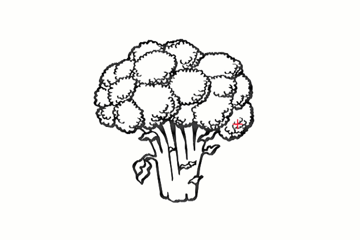

Interior Offset Fill Demo
Flood Fill
Flood Fill calculates an engraving path that attempts to reduce or eliminate travel moves across blank space. It's useful for engraving designs with lots of empty space within graphics, where traveling across the empty portions would otherwise consume a great deal of time.
Flood Fill demo
Flood Fill is an especially useful option for machines that accelerate quickly, and for Galvo lasers in particular.
Learn More

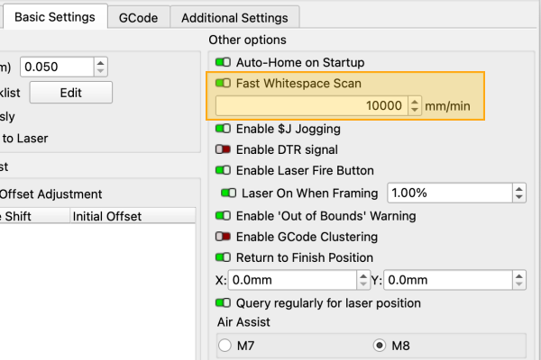

Fast Whitespace Scan
Note
This setting is only available for GCode-based lasers.
This setting boosts your laser's travel speed through blank areas of an engraving, if the speed you set here is faster than your laser's engraving speed.
This can save a lot of time if you're engraving a design slowly to get a good burn, particularly if there are large blank areas. This setting applies to both images and filled vector engravings.
Learn More
Fast Whitespace Scan in the Device Settings window
