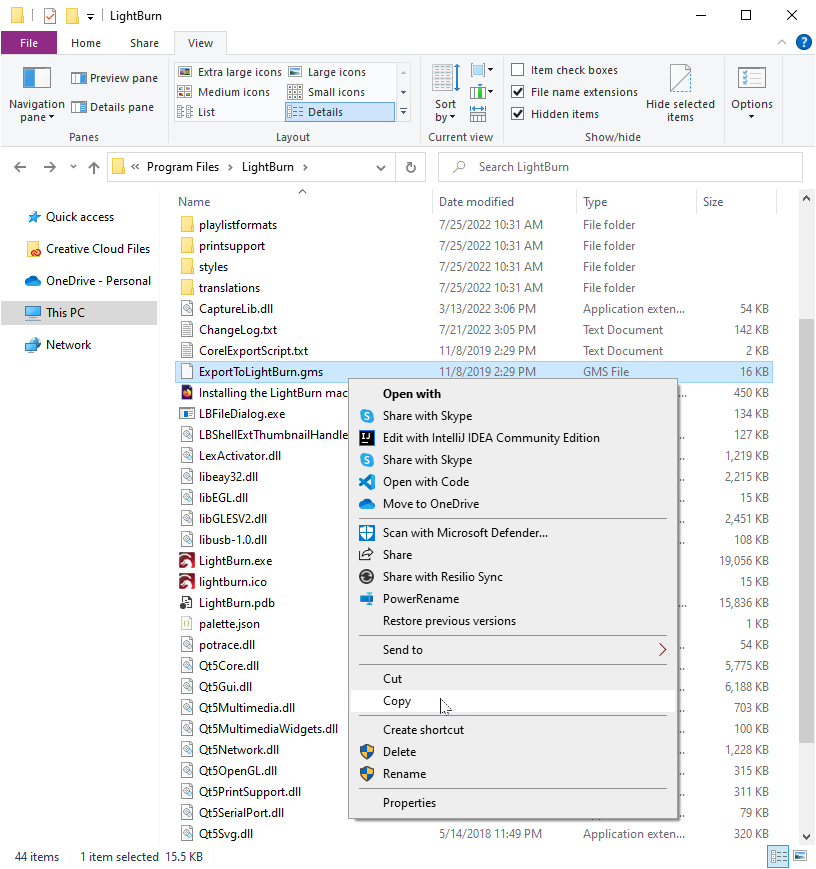

  2. Open the LightBurn install folder, typically located at C:\Program Files\LightBurn. Find the ExportToLightBurn.gms file inside this LightBurn folder.
  3. Copy the ExportToLightBurn.gms file by right-clicking and choosing Copy or by pressing Ctrl+C.
    copying the file

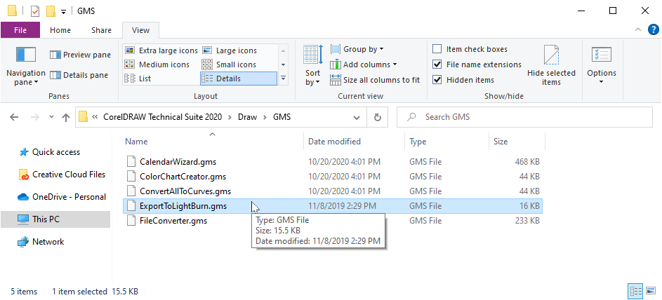

  4. Open the CorelDRAW install folder, typically found at c:\Program Files\Corel. Locate the folder called CorelDRAW Graphics Suite ### or CorelDRAW Technical Suite ###, with ### being your CorelDRAW program version number.
  5. Open the CorelDRAW Technical Suite ### folder, with ### being your CorelDRAW program version number, the Draw folder, and finally the GMS folder. Paste the ExportToLightBurn.gms file copied earlier into this GMS folder.
  6. Grant permission to copy into the GMS folder if prompted.
    paste the file into CorelDRAW's GMS folder
    Paste into CorelDRAW's GMS folder

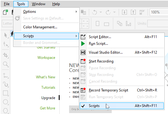

  2. Open the Script Manager (Macro Manager on older versions) by going to Tools → Scripts → Scripts or by using Alt+Shift+F11. Older versions can open the Macro Manager by selecting Tools → Macros → Macros Manager.
    open macro manager
    Open the Macro/Script Manager

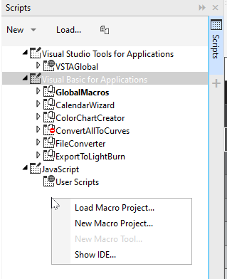

  3. If the ExportToLightBurn macro doesn't show up in the Visual Basic For Applications category, load it manually.
    A. Right-click on the background of the Script Manager window, select Load Macro Project, and select ExportToLightBurn.gms from CorelDRAW's GMS folder (located earlier in this guide).
    load macro
    Load the macro if needed

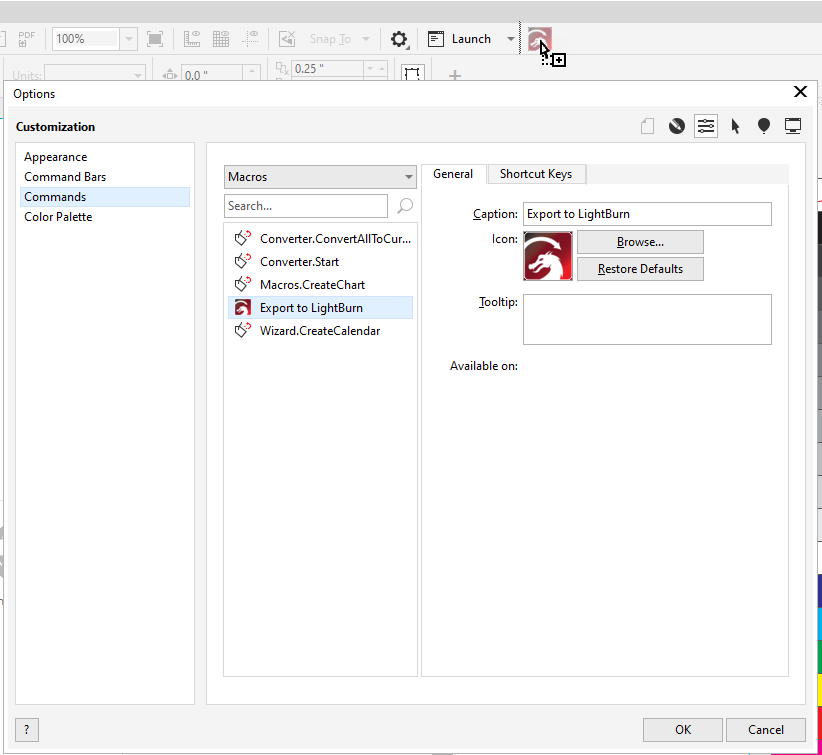

  1. Open CorelDRAW's customization window from Tools → Options → Customizations. On older versions select Tools → Customizations.
  2. Open the Commands section on the left. On older versions, select Workspace → Customization → Commands.
  3. Select Macros from the pane that appears on the right.
  4. Select the LightBurn entry.
  5. Click on the Browse button next to the icon. On older versions, select the Appearance tab to select an icon.
  6. Select the LightBurn icon found in the C:\Program Files\LightBurn folder and click Open.
  7. Grab the macro from the customization window and drag it to a toolbar for an easier workflow in the future.
  8. Set the caption to Export to LightBurn.
  9. Click OK to close the Script/Macro Manager window.
    macro configuration
    Suggested configuration for the macro
