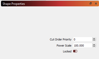

Shape Properties Options
The options available in the Shape Properties Window depend on the type of object you have selected.
Three options are available for all types of objects, or when you have multiple types of objects selected at once.
  • Cut Order Priority: sets the order this shape is cut by the laser. Lower values are cut first, starting with 0 as the highest priority. You must also select Order by Priority in the Optimization Settings for this setting to take effect.
  • Power Scale: rescales the power used to cut this shape by this percentage, between Min Power and Max Power. For devices that do not support the Min Power setting, power is scaled as a percentage between 0 and Max Power.
    Video: Fine Tune Laser Output With Power Scaling
  • Locked: prevents any edits to the selected shape(s). See Lock Shapes for more information.
When multiple shapes are selected, changing these values acts on all selected shapes at once.
See below for additional properties that are presented only when you've selected specific types of objects.

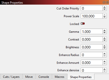

These settings are presented for image graphics.
Gamma: adjusts mid-tones shades — Lower values lighten the mid-tones, and higher values darken them. 1.0 is normal.
Contrast: increases or decreases image contrast — higher values make light tones lighter and dark tones darker.
Brightness: increases or decreases image brightness, making both light tones and dark tones lighter or darker.
Enhance: increases the contrast of edges within the image - also known as Unsharp Masking and High-Pass Sharpening.
Enhance Radius: controls the spread of edge contrast — a larger radius spreads the Enhance effect further from the edges within an image.
Enhance Amount: controls the intensity of the edge contrast.
Enhance Denoise: reduces noise in smooth areas.
