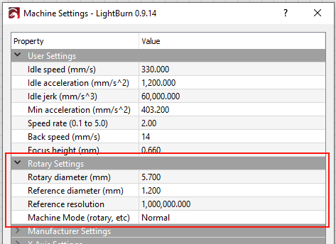

Rotary Setup (TopWisdom and Trocen)
Users with TopWisdom controllers must enable Rotary Mode and set parameters through the Machine Settings of the controller itself.
In LightBurn, go to Laser Tools → Machine Settings to enable Rotary Mode as well as view and adjust the rotary controls.
TopWisdom Rotary Controls
The options presented here are the same as those available in AutoLaser, the stock software for the TopWisdom. For more information on these settings, refer to this manual, or contact your machine's manufacturer.
Users with Trocen controllers must enable Rotary Mode and adjust settings through the controller display. For more information on these settings, refer to this manual, or contact your machine's manufacturer.
