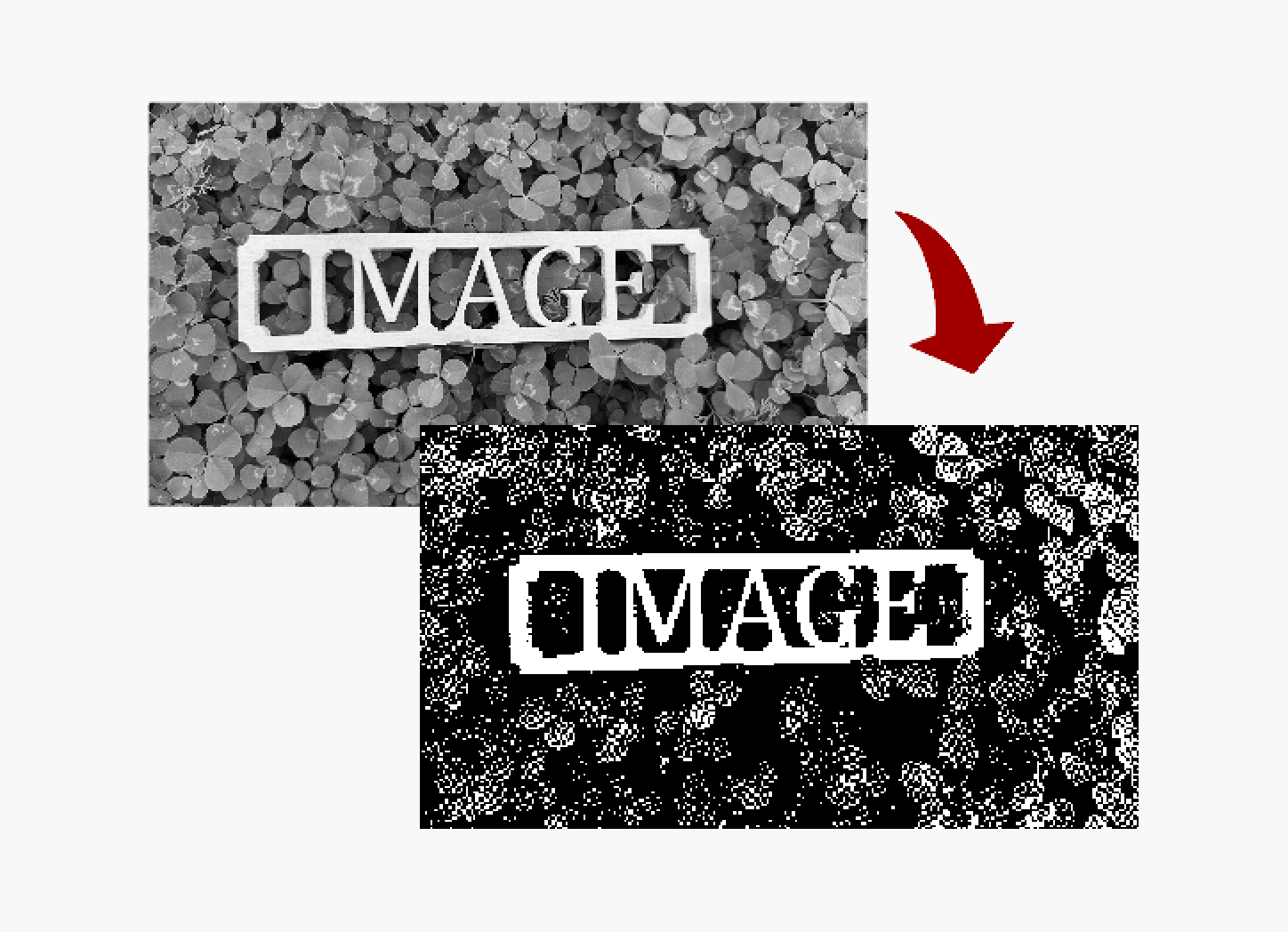

Use Save Processed Bitmap to save an image you have edited in LightBurn, including any changes made using Adjust Image, or any dithering mode applied to the image.

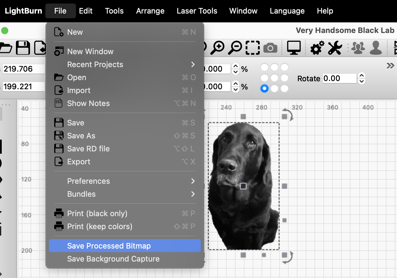

To save a processed image, first select an image, then go to File → Save Processed Bitmap or right-click in your Workspace and select Save Processed Bitmap from the context menu.
Save Processed Bitmap location in file menu

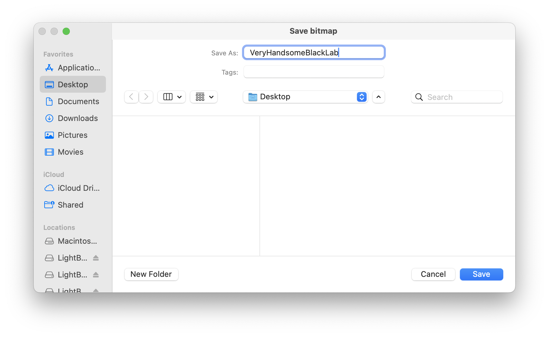

Your system's file management window will open, where you can name and select a location to save the processed image. After, you'll be able to open the processed image using any software that can open images.
File management window for saving processed bitmap
Save Processed Bitmap result
