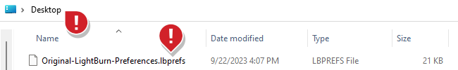

  1. Open LightBurn and export your current preferences by going to File → Preferences → Export Prefs.
  2. Save the .lbprefs file and note its location.

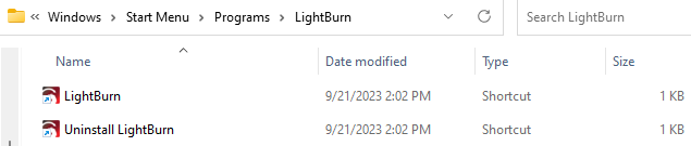

  4. Open File Explorer and navigate to the Windows Start Menu links storage location. The easiest way is to enter the file path below into the File Explorer address bar.
    C:\ProgramData\Microsoft\Windows\Start Menu\Programs\LightBurn\

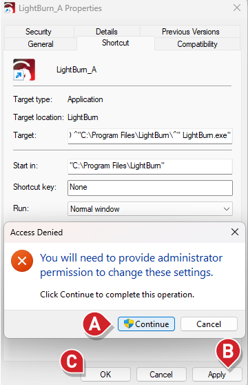

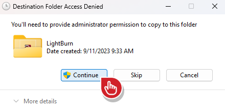

  5. Copy the LightBurn shortcut and paste it twice. Rename each file – this guide uses LightBurn_A and LightBurn_B. Grant administrator privileges in the User Account Control window by selecting Ok and then Continue to save each change.

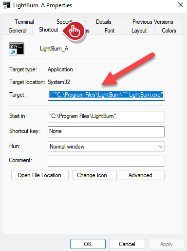

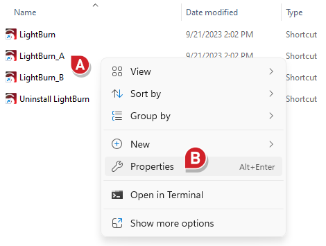

  6. Right-click on the first shortcut file and select Properties.
  7. Select the Shortcut tab and replace the text in the Target field to match.
    Info
    Replace LightBurn_A with whatever name you want your first profile to use. Do not include a space between the file name and the && characters as formatting and syntax matters.
    C:\Windows\System32\cmd.exe /c "SET LB_SETTINGSFOLDER=%USERPROFILE%\LightBurn_A&& START /D ^"C:\Program Files\LightBurn\^" LightBurn.exe"
  8. Click Apply followed by OK and grant admin permissions again to save the changes.

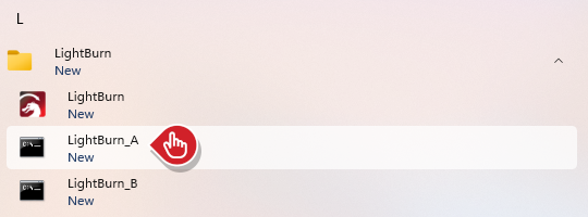

    Two new LightBurn shortcuts are now located in the Windows Start menu. Reentering your license key will not be required.
  10. Open the Windows Start Menu and click on the first newly created LightBurn shortcut – LightBurn_A in our example – to launch the first independent instance of LightBurn.

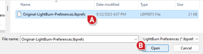

  12. Click on Import Preferences in the bottom left corner of the Devices window.
  13. Select and load the preference file you saved in Step 1 to load all devices in the preferences file.
  14. Select and remove any devices you do not want associated with this LightBurn instance and click OK.

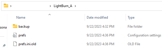

Two new preferences directories can now be found in your Windows user profiles folder at %USERPROFILE%\LightBurn_A and %USERPROFILE%\LightBurn_B. The %USERPROFILE% shortcut will resolve to the full file system path on for your user directory.
Starting LightBurn with the new shortcuts will launch multiple LightBurn instances that are completely independent of one another. They will not overwrite the other's preferences file and any changes you make to the device on each will persist, and will include completely independent recent file lists, rotate/shear options, and more. Each LightBurn instance will be completely independent.
