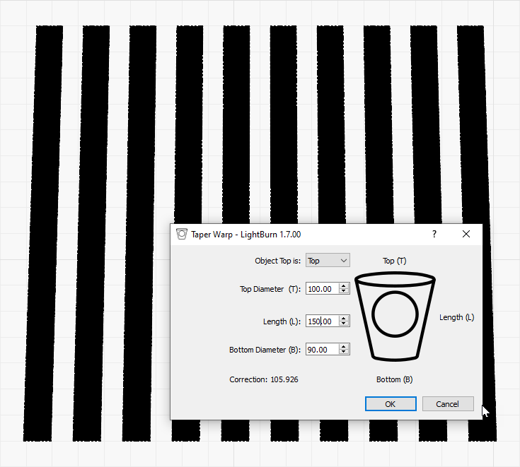

The Taper Warp tool assists in rotary engravings on tapered objects by adjusting graphics to compensate for the difference in diameter between the top and the bottom of the object. Open the Taper Warp window by going to Laser Tools → Taper Warp.
Using Taper Warp
Warning
Taper warp operates in millimeters. If your project is set to inches, please either switch to millimeters before using taper warp or convert your measurements to millimeters (multiply them by 25.4).
Select the artwork you want to apply Taper Warp to. Open the Taper Warp window and adjust the settings shown to match your object. The diagram on the right side of the window helps illustrate what the settings refer to.
As you adjust the settings, you'll see a preview of the effects of the Taper Warp in your Workspace. The image below shows the effect of Taper Warp on parallel rectangles.
Press OK to confirm settings and adjust the graphics, or Cancel to discard the changes.
When engraving your object, make sure that it's positioned so that the surface to engrave on is parallel to the bed of the laser.
Object Top
Set Object Top to either Top, Left, or Right so LightBurn knows where the top and bottom of the taper are — this is where the top of the physical object you're engraving is.
Top Diameter
Measure the diameter of the top of the object. Be as precise as possible – calipers can be very helpful, especialy dealing with round objects.
Length
Measure the length of the object and enter it here.
Bottom Diameter
Measure and enter the diameter of the bottom of the object.
