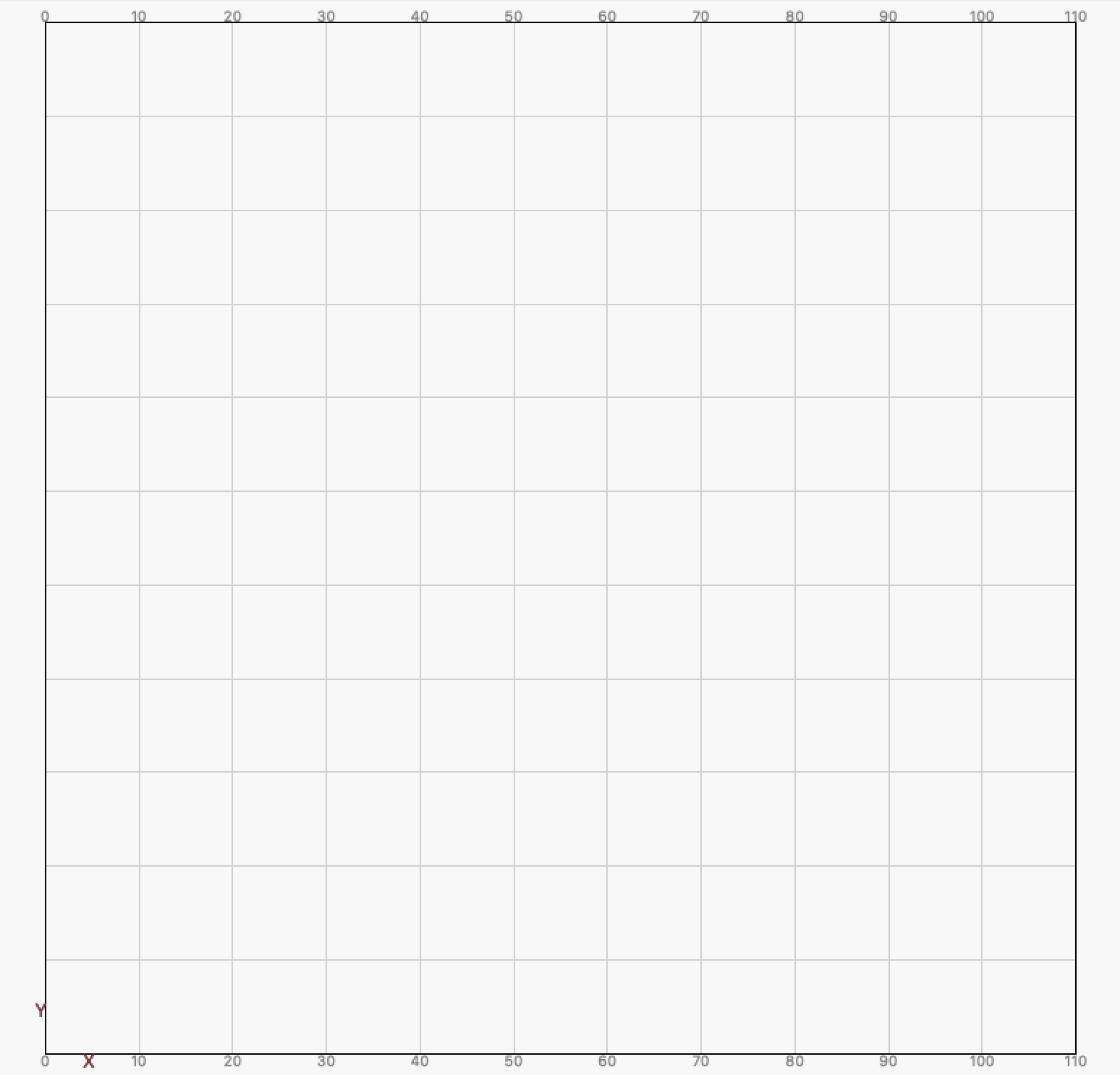

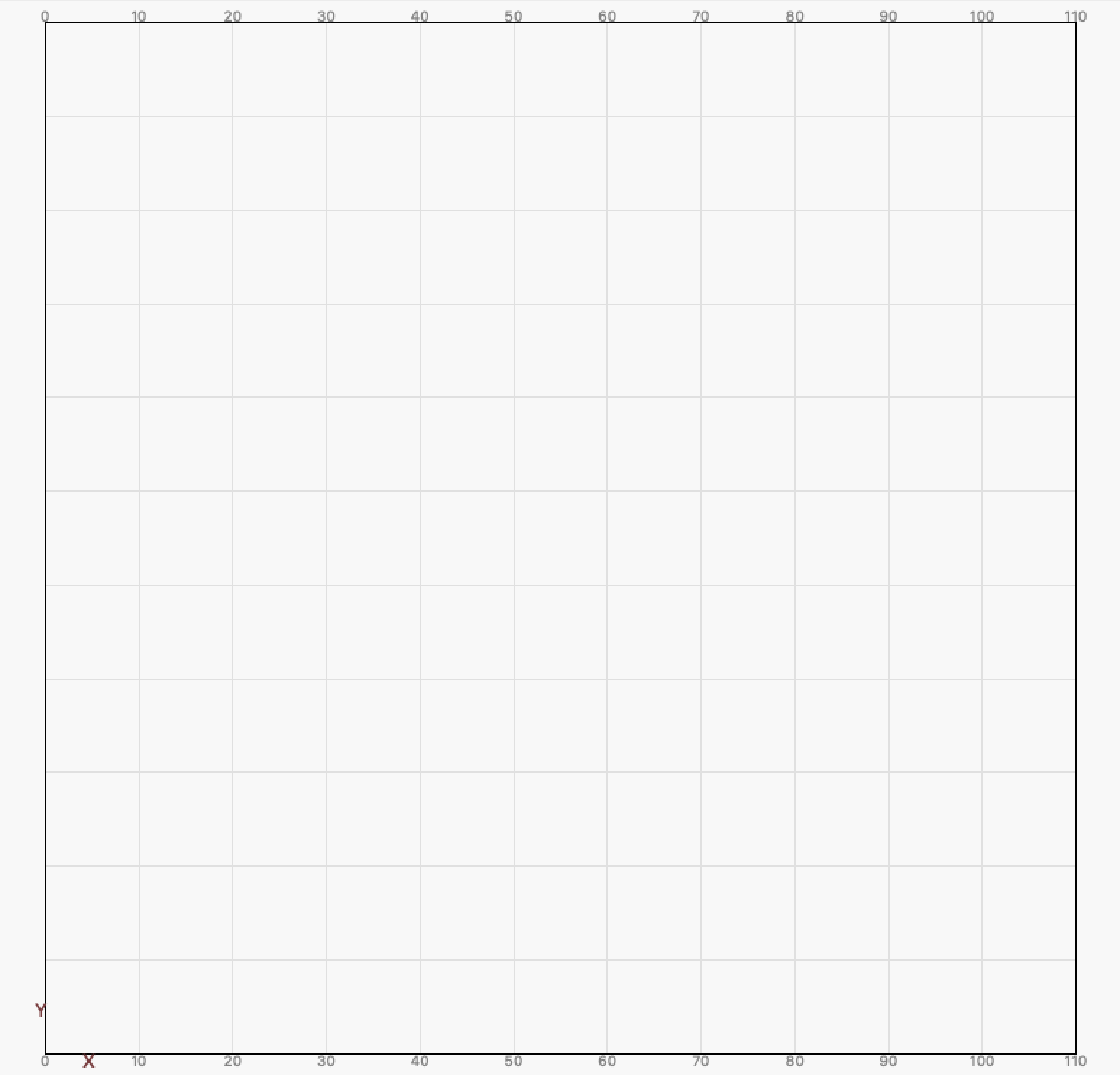

Grid Contrast
Adjust the brightness of the grid in your Workspace, relative to the background.
Grid Contrast Comparison
No Contrast Grid
Grid Contrast off
Low Contrast Grid
Low contrast grid
Low Contrast Grid
Medium contrast grid
High Contrast Grid
High contrast grid

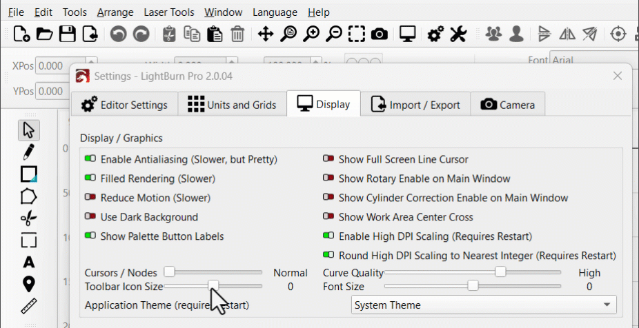

Display
Application Theme
Use this dropdown to switch between LightBurn's light and dark themes. The default System Theme setting will match your operating system's theme setting.

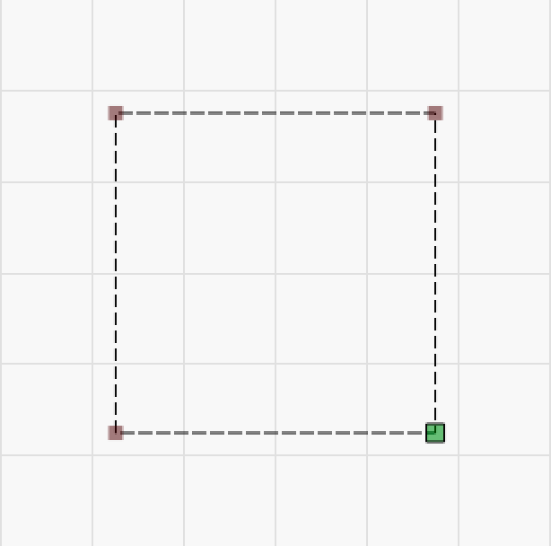

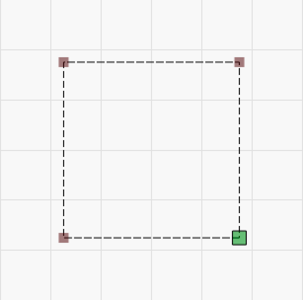

Cursors / Nodes
Adjusts the size of special cursors used when Snapping, applying radii, Bending text, and more, as well as the size of individual nodes when using Edit Nodes.
Adjust the slider to select between Normal, Larger, and Largest.

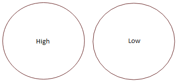

Curve Quality
Controls the precision LightBurn uses in displaying curves on the screen. All curves are displayed as a series of short lines, but the higher this value is, the shorter those lines will be.
Reduce this value to improve performance if your system is slow.
