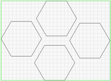

Bounding Box Frame Bounding Box Frame Icon
Commands the laser to trace a path defined as the smallest possible rectangle that will fully contain all graphics you're sending to the laser.
BoxFrame

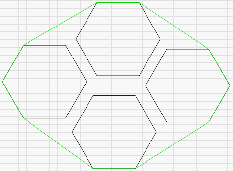

Rubber Band Frame Rubber Band Frame Icon
Traces the smallest possible path that fully contains all graphics in the design you're sending to the laser, as if a rubber band were stretched around them.
BoxFrame
Tip
Rubber Band Framing is useful for lining up jobs with irregular shapes where a box outline doesn't fit well. For example, a long, thin diagonal shape, or a triangle.

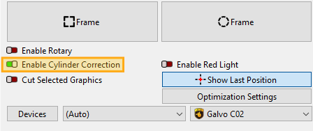

Enable Cylinder Correction
Note
This setting is available for Galvo lasers only.
This switch controls whether Cylinder Correction is enabled. When enabled, LightBurn warps the output of your design to correct for distortion caused by engraving cylindrical objects, without using a rotary.
Cylinder Correction Enable Switch
In order to see this switch in the Laser Window, you must turn on Show cylinder correction enable in main window in your Settings/Preferences.
Before using Cylinder Correction, you must first establish several important parameters in the Cylinder Correction Setup window that determine how LightBurn will warp your output.
See Cylinder Correction for more information.

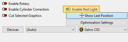

Enable Red Light
Note
Red Light enable switch
This switch controls whether your laser's Red Dot light is enabled. In order to see this switch in the Laser Window, your laser's Red Dot light must be controlled by an IO Port, and the appropriate port must be set in your Device Settings.
