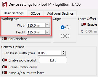

Changing the Size of the Workspace
Change the size of the Workspace in the Device Settings window by clicking on the Device Settings Icon icon in the Main Toolbar or going to Edit → Device Settings → Dimensions / Units → Working Size. Adjust the Working Size Width and Height entries to match the manufacturer-provided values.
Screenshot of the Device Settings window with the Working Size section of the Basic Settings tab highlighted with a red box

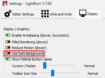

Enabling Dark Background
Switch from the default light background to a dark background in the LightBurn Settings window by clicking on the LightBurn Settings icon in the Main Toolbar or by going to Edit → Settings → Display → Display / Graphics → Use Dark Background.
Settings screen with Use Dark Background surrounded by a red box

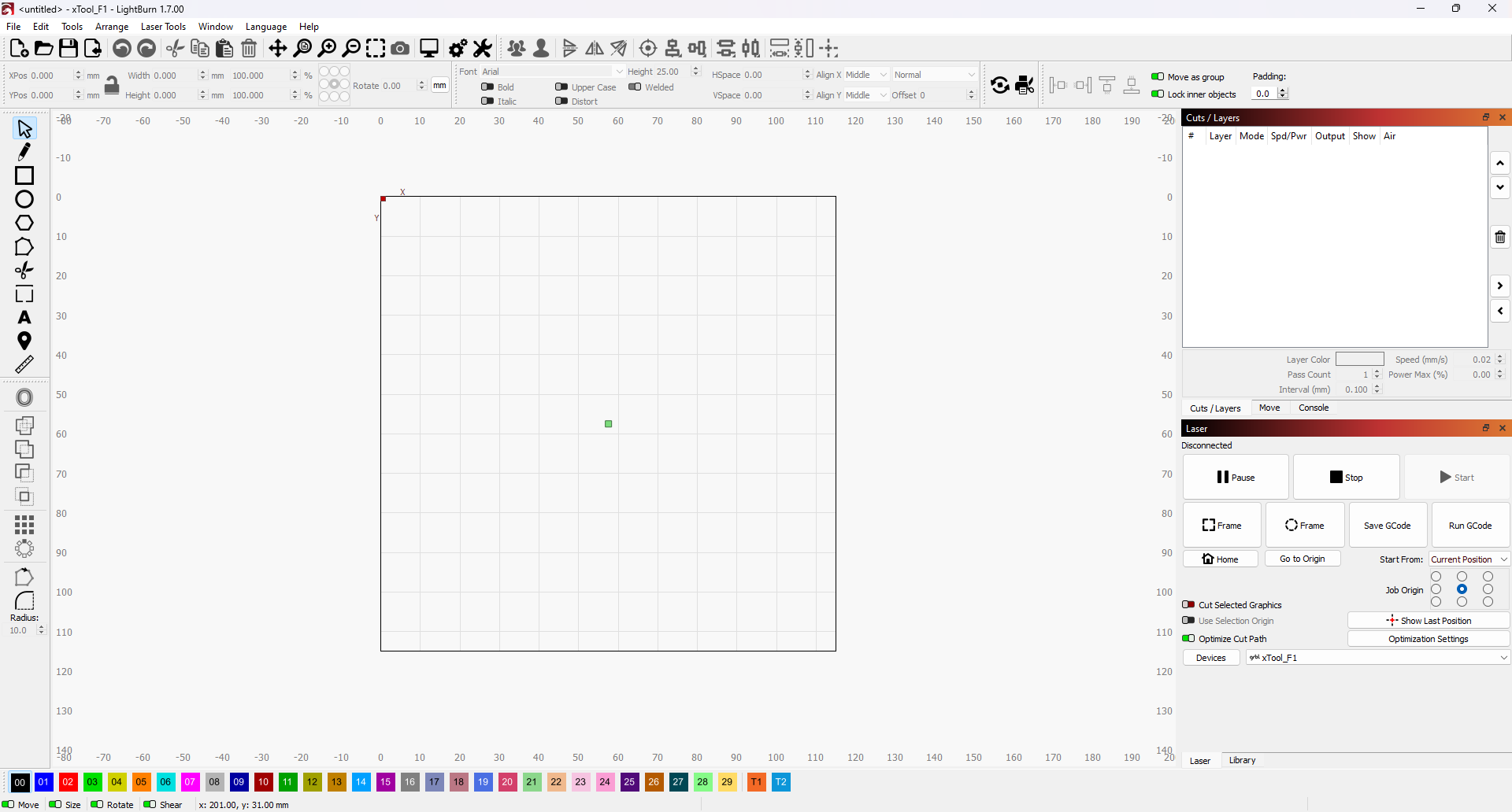

Default Light Color Background
Screenshot of LightBurn showing the workspace with a light background
Type Color
Hex #F8F8F8
RGB 248,248,248
CMYK 0,0,0,2.7
HSV 0,0,97

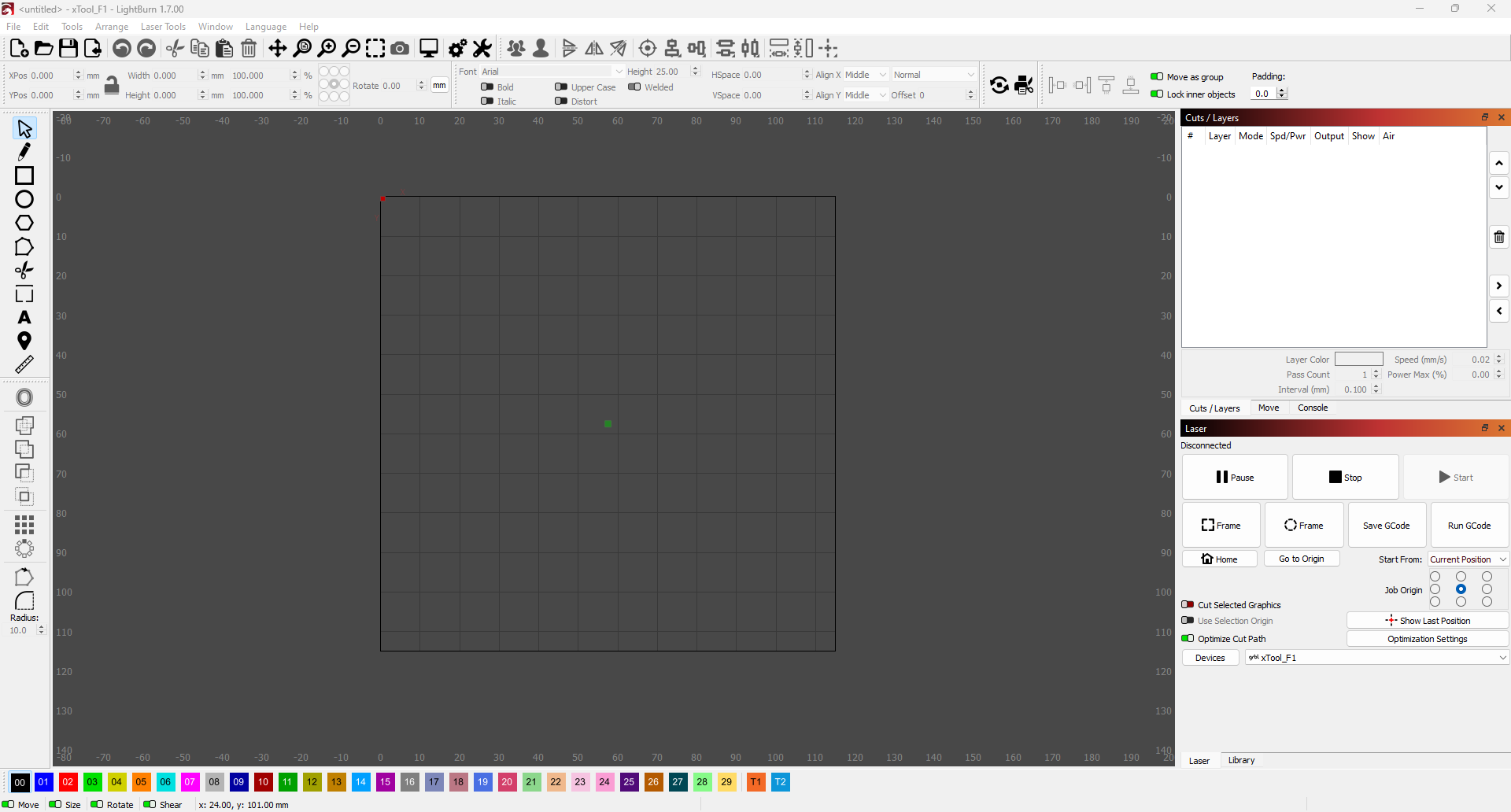

Dark Color Background
Screenshot of LightBurn showing the workspace with a dark background
Type Color
Hex #484848
RGB 72,72,72
CMYK 0,0,0,71.8
HSV 0,0,28
