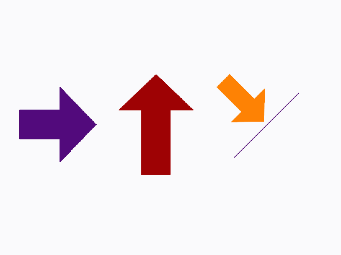

Flip Vertical and Flip Horizontal mirror selected objects across their vertical or horizontal centers.
Mirror Across Line creates a mirrored duplicate of selected objects across a custom-selected line, at any angle.

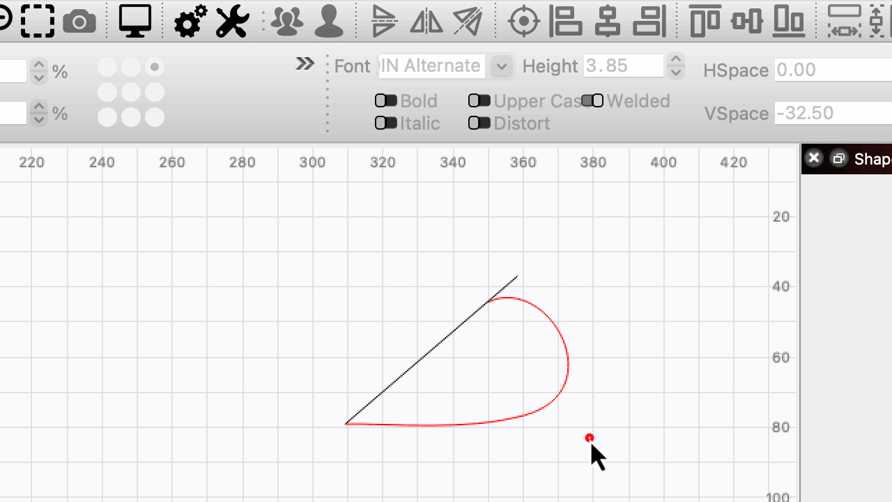

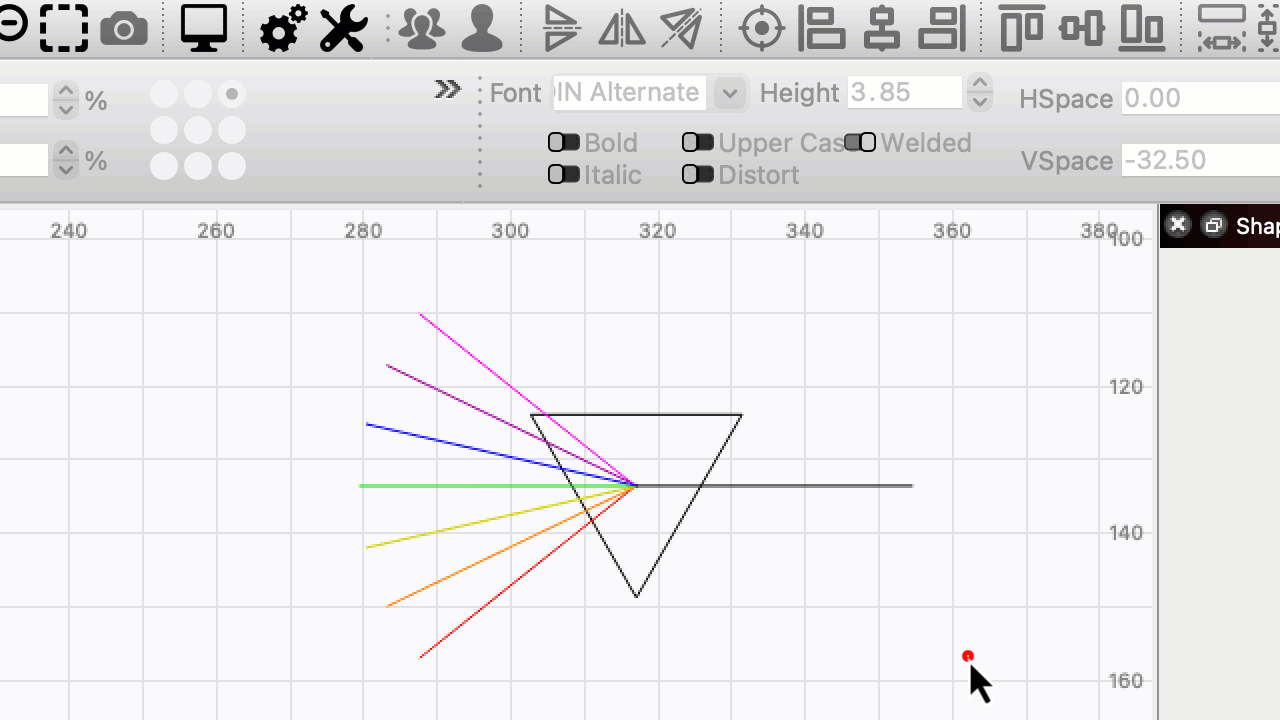

Mirror Across Line creates a mirrored duplicate of your selection across a custom-selected line.
  • The line must be the last object added to your selection — in other words, you must first select the objects you'd like to Mirror, then select the line you'd like to Mirror them across.
  • The line must be a straight line with only two points.
Use Mirror Across Line to create a symmetrical shape
Draw half the original shape, then mirror it to create the other half, like this:
Mirror Across Line Heart
