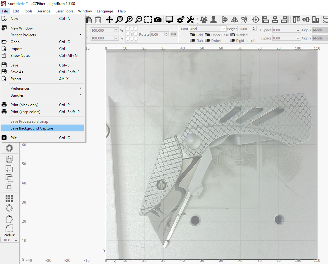

Click Update Overlay in the Cameras Window to produce an overlay.

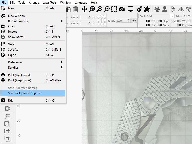

Go to File → Save Background Capture to save the camera overlay.

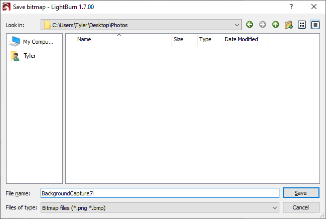

A dialog window will open, allowing you to name and navigate to the location you'd like to save the capture.
