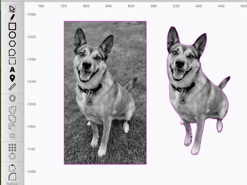

You can use masking to remove the background of an image, for example to isolate a pet or person from an photograph — a great way to get more clarity in an image that doesn't have a well-contrasted background.
Masking an Image
In addition to an image, masking requires a vector object, in any desired shape. The vector object must be:
  • Placed on either a Tool or Line layer
  • A closed shape, with a single, shared start and end point
You can use use rectangles to perform standard crops, but the shape can be a more complex path as well, or even a Group of vectors (including text) provided that the Group is all on the same layer. When shapes are placed on a shared layer, Grouped, and used for masking, the area between the shapes that would normally be solidly engraved with Fill Mode will be "filled" with the image instead.

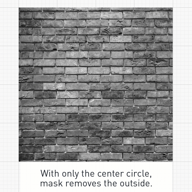

Removing the Center of an Image
Sometimes, you might want to cut out the inside of an image while leaving the outer portion intact. You can do this by Grouping together nested shapes before masking.
See below for detailed directions and an animation showing the difference in results between masking an image with just a circle or a circle inside of a rectangle.
  1. Draw the vector shape(s) for what you want to remove.
  2. Surround the shape(s) you drew with an outer shape. If the outer shape is completely outside of the image you're masking, the outer edges of the image will be unchanged. If the outer shape cuts into the image itself, the part of the image outside of your shape will be removed.
  3. Group your inner and outer shapes together.
  4. Select the grouped vectors and the image, and apply a mask by either going to Tools → Apply Mask to Image or right-clicking and choosing Apply Mask to Image from the context menu.
Demonstration of masking out the center of an image

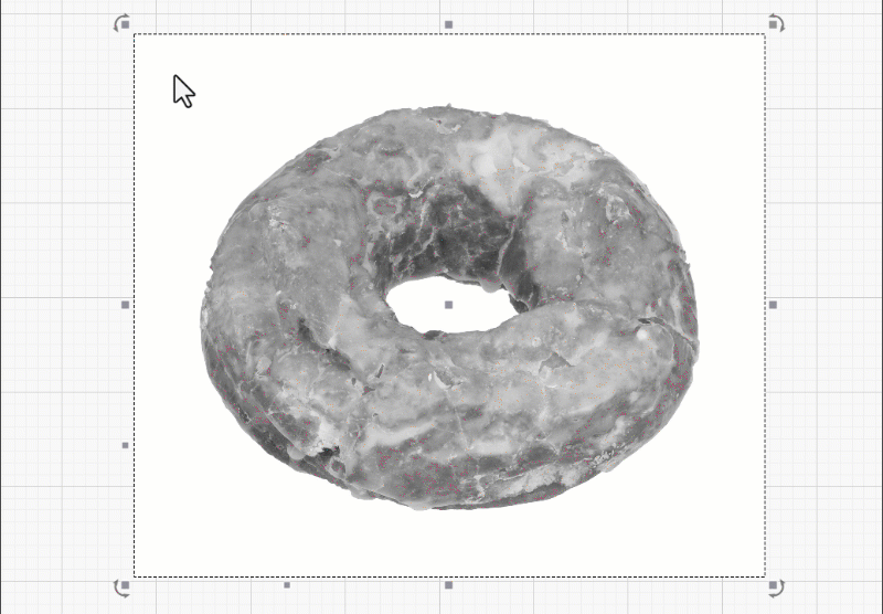

Combining Tracing and Image Masks
Using LightBurn's Trace tool on images with clearly defined edges can be a quick way to produce a mask to remove an unwanted background. In the example below, the donut is traced with Delete Image After Trace disabled, and then the traced shape is used as a mask to hide the background.
Demonstration of combining tracing with image masks

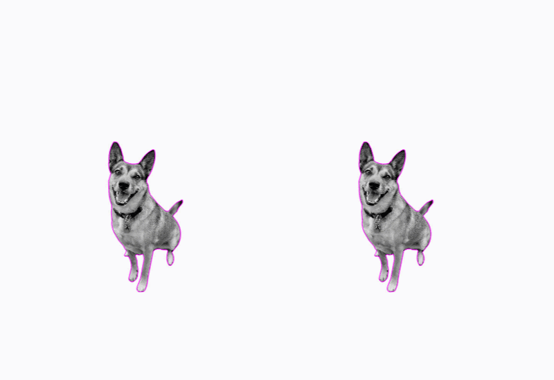

Removing a Mask (Restoring an Image)
You can fully restore the original image in two ways:
  • Select the vector object you used for the mask and press Backspace/delete on your keyboard to delete it.
  • Select the image, right-click it, and choose Remove Mask from Image.

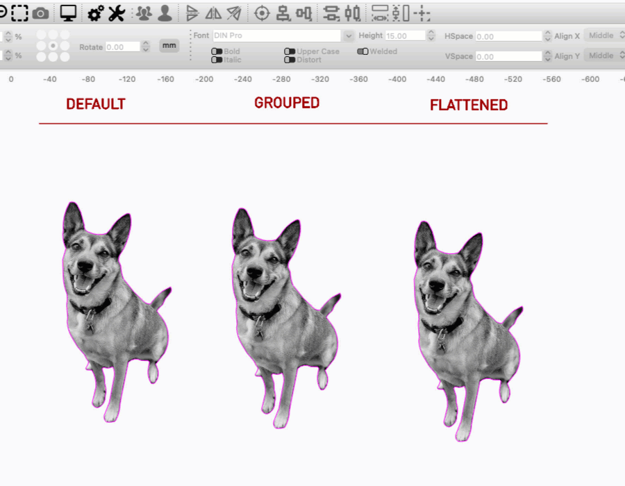

Grouping
Once you have the mask as you want it, it's a good idea to Group the vector and image to avoid accidentally moving one without the other.
Editing
Flattening (Baking-In) a Mask
The downside of preserving the hidden parts of the image is that it can make masked images harder to align to other objects, but it is possible to permanently remove the hidden areas of a masked image (also called "baking in" the mask).
To do so, right-click the masked image and select Flatten Image Mask.
This also removes the masking shape, leaving you with a only an image in the shape it had been masked.
To accomplish this in one step, you can use Crop Image from the Tools menu.
Grouping and Flattening
