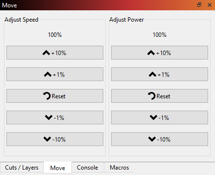

GCode Only — the Move Window During an Active Job
For GCode lasers only, the Move Window changes in appearance while LightBurn is actively streaming a project to your laser.
The original interface is replaced by new buttons which allow you to adjust the Speed and Power settings of your active project.
Move Window during active job for GCode lasers
The buttons beneath Adjust Speed and Adjust Power each adjust those settings as a percentage of the original values — not by absolute values.
As you increase or decrease Speed, Power will automatically adjust to match the change, but you can increase or decrease Power without affecting Speed.
You can click Reset to restore either setting to your project's original values.
Adjusting settings through the Move Window only affects the active job, and makes no change to your original project settings.
