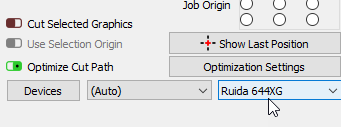

If you have more than one laser set up, you might need to select the one to connect to by clicking here:

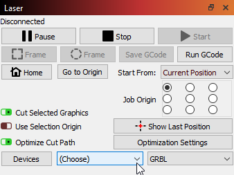

Depending on the type of controller you have, you might have to manually choose the port that the laser is connected to, by clicking where you see Choose in the Laser Window:
As long as your laser is connected to the same communication port, LightBurn will reconnect when you re-start. If you reboot your computer, or plug the controller into a different USB port, you might need to re-select it.
If you see (Choose) as shown above, you need to select the port. If no ports are listed in the drop-down, it means that no devices were found, which could mean that it is not plugged in correctly, isn't powered, or you're missing a driver.
